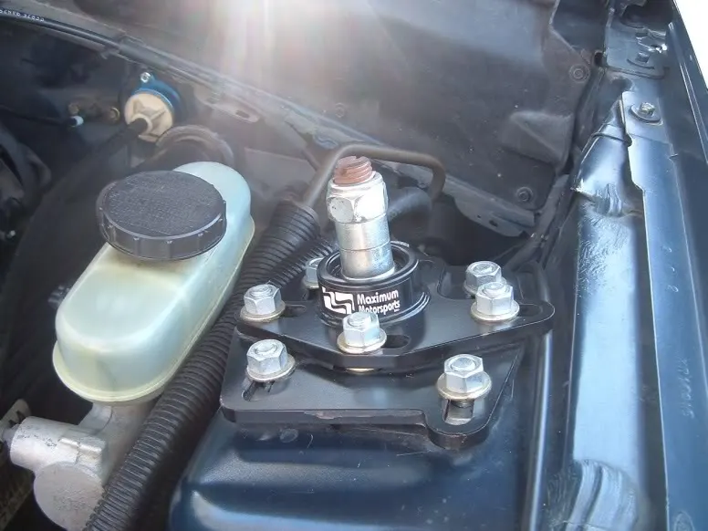

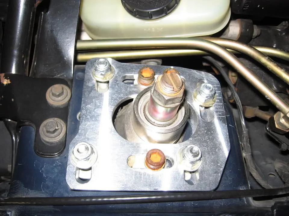

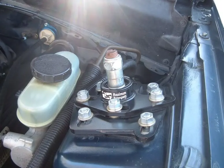

OK, I admit when I saw people buying these and putting them on their car, I thought, FTH???
Now I know. I just had the Bullitt suspension package installed and my castor is a bit out and camber on a far end. I need to buy something that will permit an adjustment to be made during a wheel alignment.
Any recommendations, links? Anything I should steer clear of?
Thanks!
I like my UPR 4 bolts just fine. Though this is one product that they sell that is pretty much the same price as any other company.

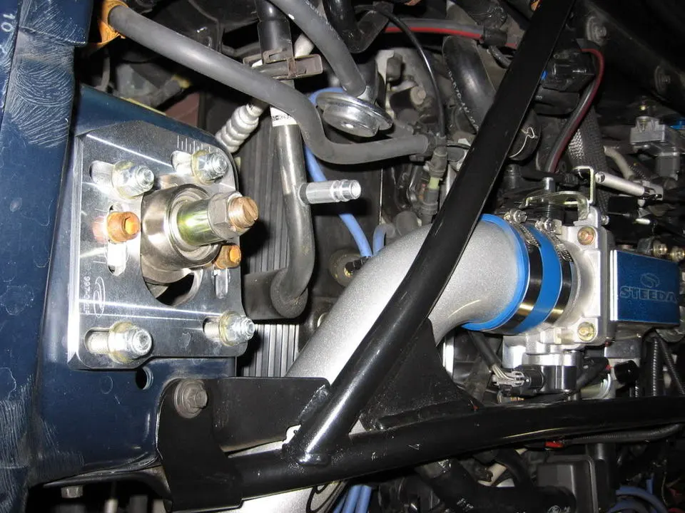

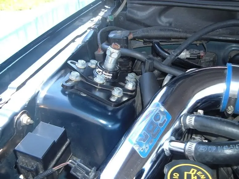

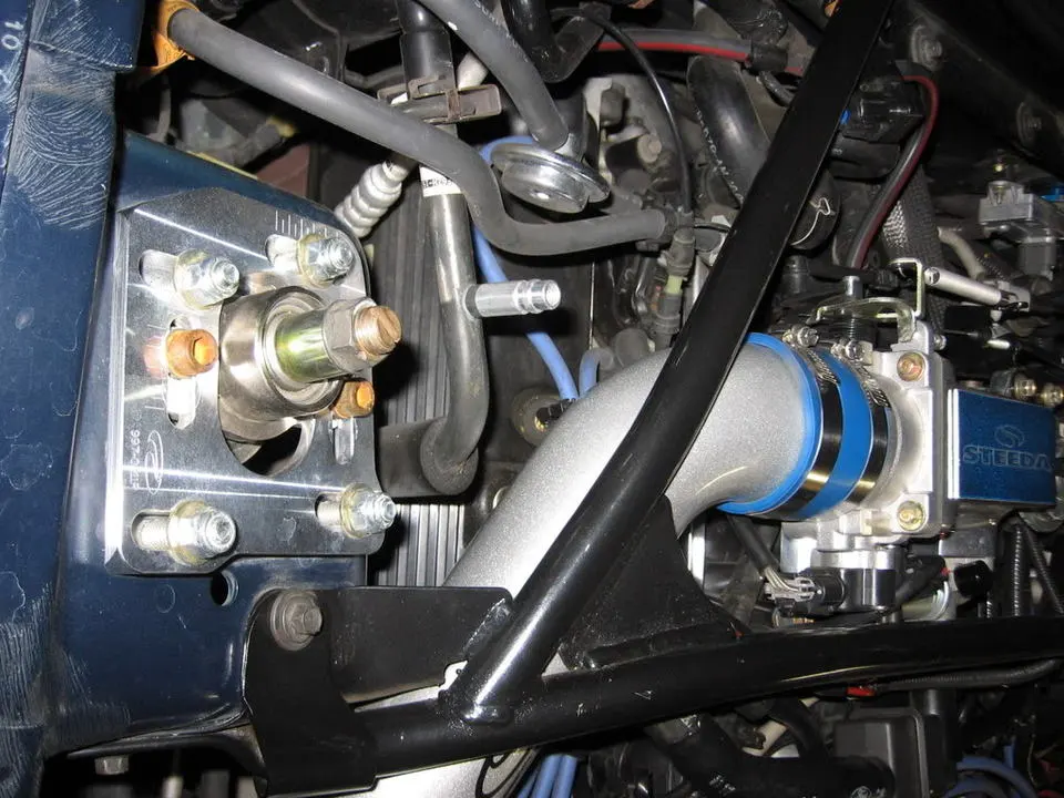

They allow greater adjustment on a car with aftermarket lowering springs. Mine has Steeda Sports which are supposed to drop it about 1.5 inches but my toe was adjusted as far out as possible with the stock CC plates. I wore out two new tires. Once I put the aftermarket plates on the toe and camber can be adjusted to allow for the lowered suspension.
No flames here...
Would they benefit stock suspension?

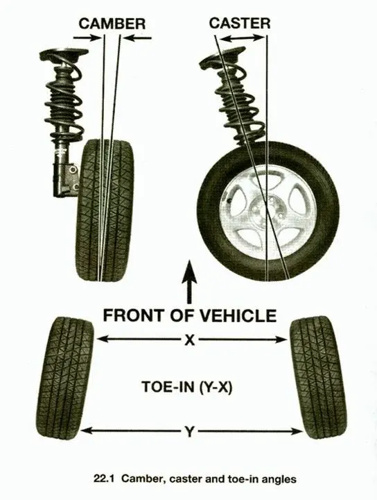

caster/camber plates adjust, you guessed it, caster and camber. when you lower a vehicle (in this case our Mustangs) more than 1.25 inches it throws off the factory alignment to a point where it can no longer be adjusted (to within spec) using factory parts

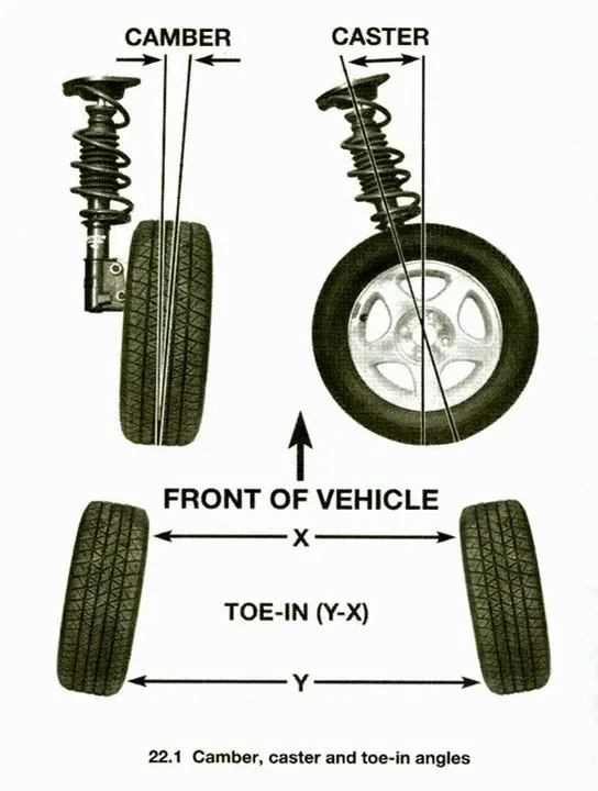

and before you ask...
Kelso, I didn't know why people used them either. What I can tell you is my kit only lowered me by 1 inch and I am out of alignment spec and cannot get a perfect adjust w/o these plates.
I'm also under the impression that with stock plates, there is not adjustment available with camber!
In the end, if you lower a car, even an inch, you may need them to prevent uneven tire wear and it will ensure you can achieve a perfect wheel alignment.
