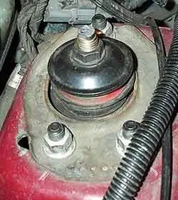

I would beg to differ. You can just look at the 2 different pics of the plates installed here, Steeda and MM, and there is a serious amount of adjustment for both. Just look at this pic of a stock CC plate and say that now...........

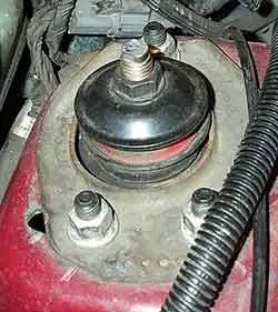

it looks like the top of the strut tower has been slotted to allow more travel. hell if i slotted the strut tower i can adjust anything with the stock plates.
i do this for a living and i have lined up more than 100 mustangs with steeda and MM plates. the steeda plates are a terrible design:notnice: and the MM kicks ass! thats all there is to it.
i can usually get a .75* or so of adjustment with the steeda plates and the MM plates will get you around 1.25*
i did a cobra today with MM plates and i brought the camber from -1.7 on both sides to -.04 and still had room to go. you can NEVER do that with the steeda plates.
after you have actually done some alignments with both plates let me know what your choice would be.
