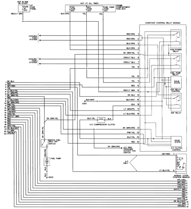

Ok big big question. When can you eliminate the CCRM wire harness?

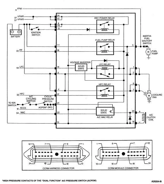

I bet you could eliminate it entirely, since you're also eliminating so many other systems. The CCRM contains the fuel pump relay, so you'd need to rewire that system, but the others that it contains are the fan controls (you'll probably run a manual fan/cooling system), air conditioning WOT relay, and I believe the ECM power relay, which would probably be a simple rewire, too.

Agree with the previous post. These should help.
just went to yahoo and searched for ccrrm wiring diagram and came up with these.
Went to the mustangtech.org website. they have more information on that website so I would go there for more information.

Thanks it seems like it can come out. Won't have an EEC, the standalone system will have 12v directly from the battery. I have my fans on a manual switch, no A/C. The fuel pump part I need to take a look at though.

I agree with the above. You'll be fine without the CCRM. As noted, you'll want your FP relay. If you want, use the factory (CCRM) inputs to control one simple SPST relay (you can lenghten the wires and relocate them where ever you want). That's the easiest solution anyhow.
I dont know how the aftermarket EEC's work but you might want to do the same thing with the EEC relay in the CCRM. That way all of your sensors and systems receiving VPWR will still do so, and at the same time as they did before.
The CCRM is just a 5 relay housing, with an added component for the WOT relay.
