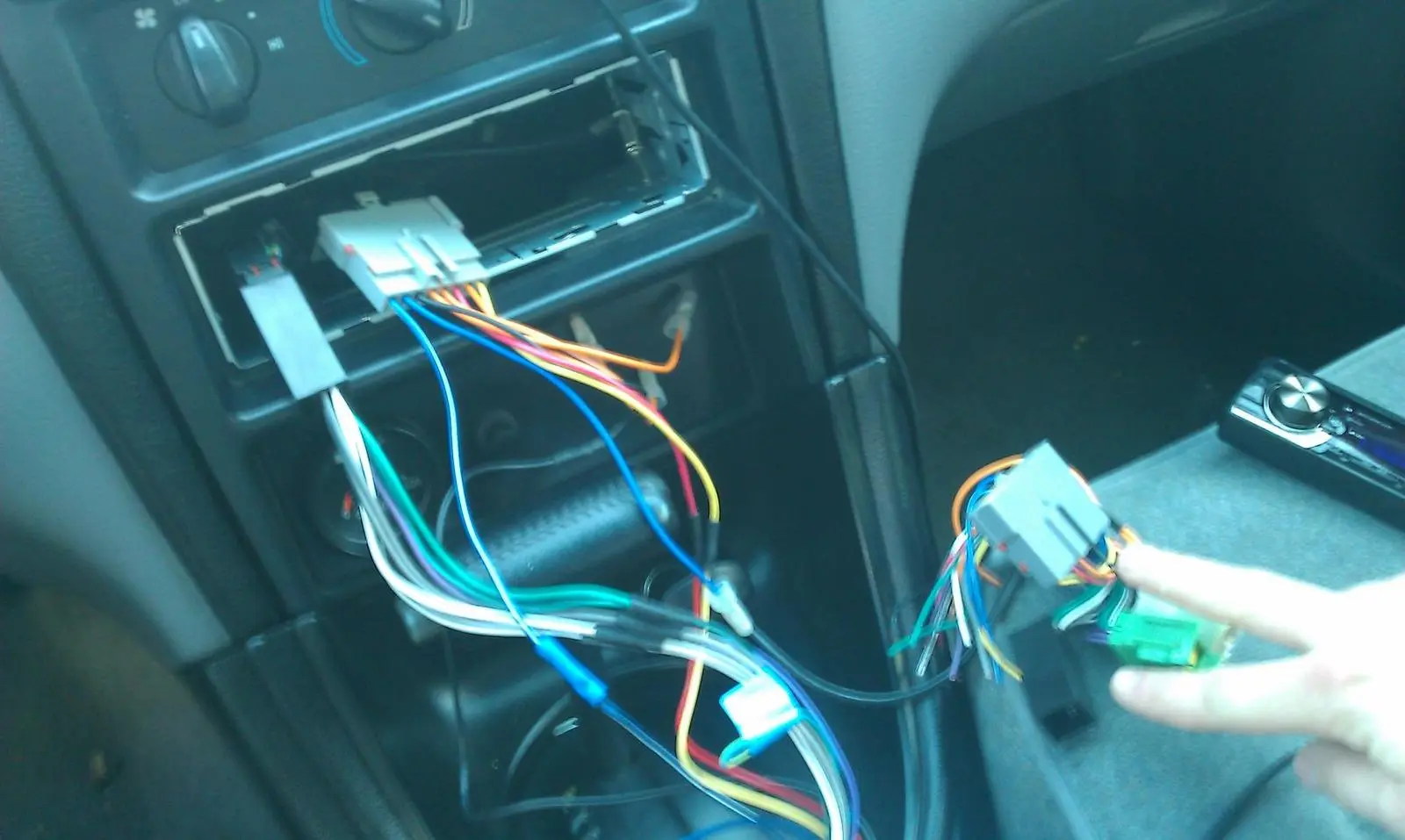

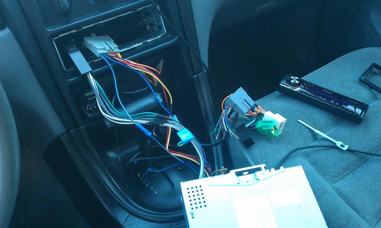

I just installed a kennwood deck in mine a couple weeks ago. I used 2 out the 4 connectors if I remember correctly. What sucks about it is that its ran through the factory amp so the volume goes way past the max for the speakers and its only half way up. If you only have one harness connected then that could be the issue, but it is sounding like the deck is bad. I will try to post a pic of later to show you which ones I connected.
Ok lets see if these pics will post. I am using my government computer so it is limited on all kinds of things to include viewing pics in these threads.
The first pic is the 2 harnesses I hooked it up to. I have an extra harness laying around so I grabbed it and pointed to the 2 connections off to the side.
The second pic is just a bigger view to help show the whole harness hooked up.
Hope this helps you.
Scott

sorry ... i can be kinda dense sometimes ... are you saying you used to have the CD thing seperate, but now it is built into your new head unit?
I recently put in a new head unit (radio/CD/AUX/Bluetooth all in one) and there were only 2 harnesses involved. If you have 4 harnesses, then maybe the original 2 were split for that installation?
