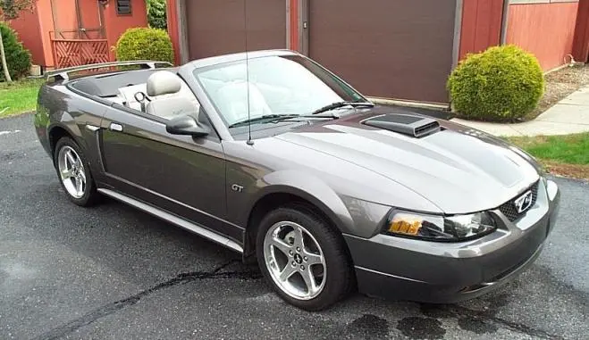

I am sure this is one of those "your results may vary" kind of things. I ended up spending just under $1000 for my KarKraft based conversion.
