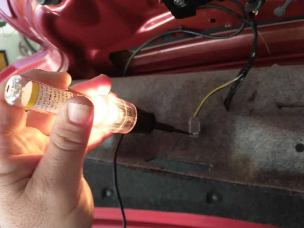

  1. Power is hot at the harness in trunk for Center Brake Light when brake pedal pushed (So it' snot the switch)

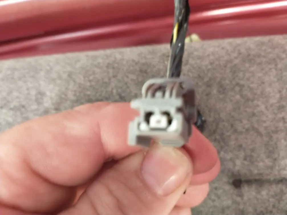

  3. Swapped out Center Brake Light units and the new one did not work (not bad light)
Not sure what to test next. Thanks!
