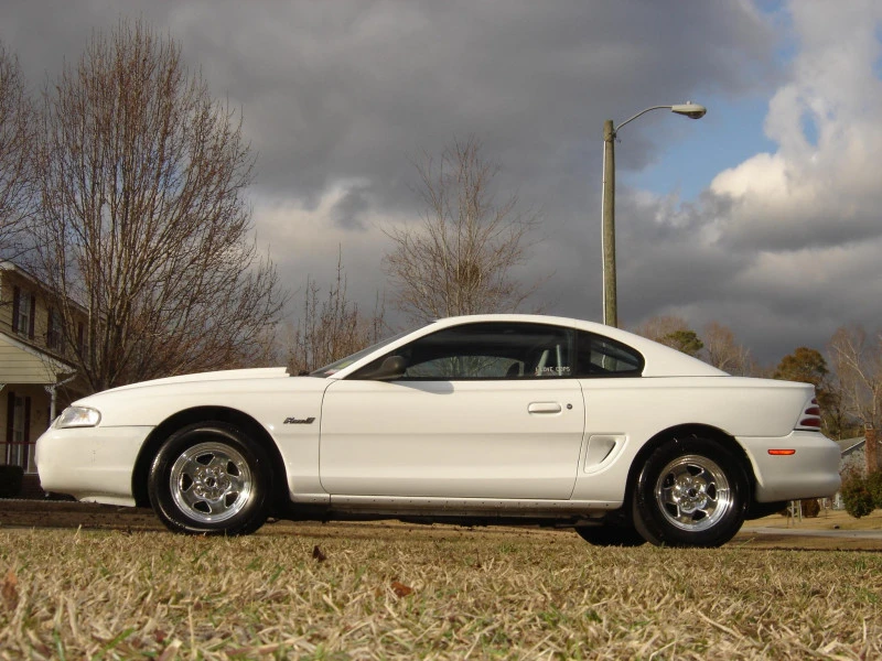

I have Telstars on my 95 and am very happy with the look and ride. I have skinnies up front and 15x8 with 5.5 backspacing in the rear. The condition of your front pads will dictate the amount of grinding you will have to do, my front pads are new so my caliper was towards the wheel as far as possible. I was very against using a spacer so I cut the bar off the pad holder. The wheels would still just barely rub so I had to use a 1/8" spacer. I was able to use the Ford Racing lug nut kit I used on my Mach1 wheels.I would like to here of the outcome because I have thought of using a larger wheel up front.

My Car
Teh TelStar5 Pwnt A11!!
