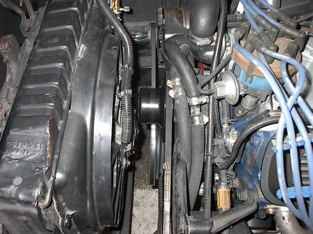

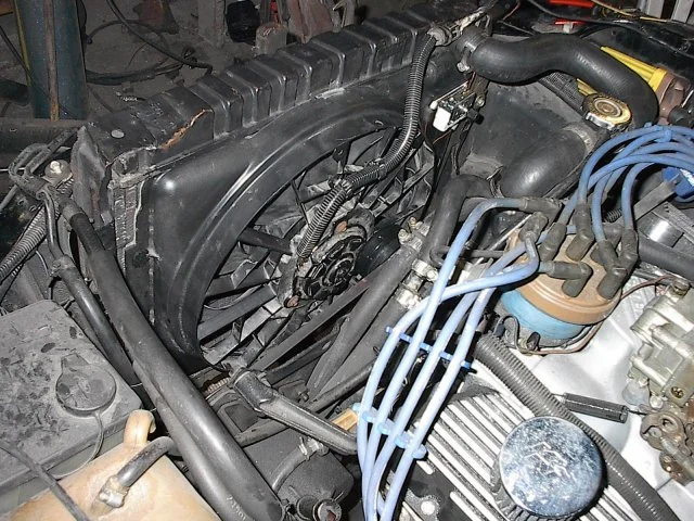

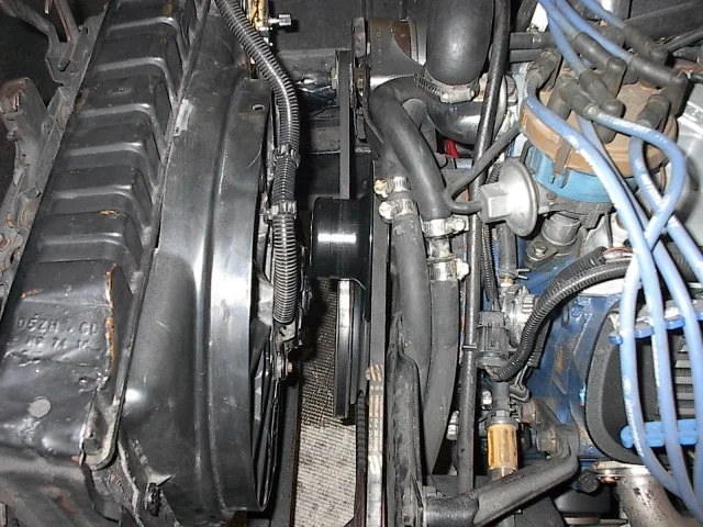

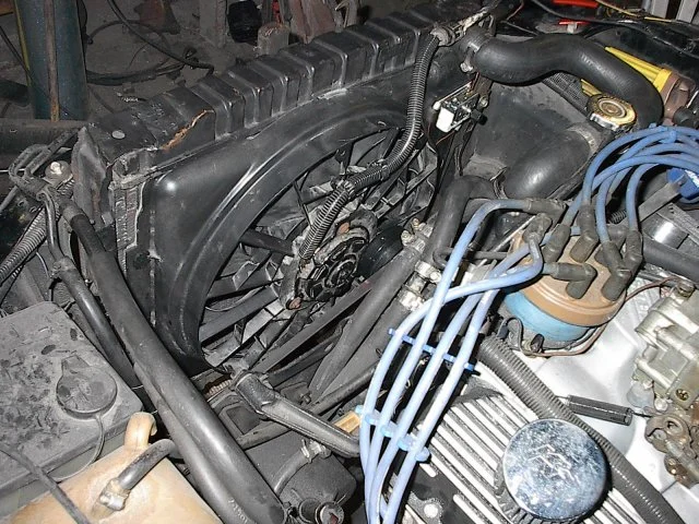

I suggest the early 90s Taurus fan as well. I put one in the Thundersnake. It fits the V8 radiator very well, with only minor trimming. And it's dual speed and draws WAY more air than any aftermarket fan. I got mine on ebay for $50, they are cheap and often on there.
Cameron's78 said:
Is it a little wide? I have a good 3 inches or more between my radiator and block...like I said I have a non-standard 302.
I'm not sure what you mean about a "non-standard 302"? but here is a coupe of pictures. I cut about an inch off of the built-in shroud that is part of the fan all the way aaround. Hope this helps.
