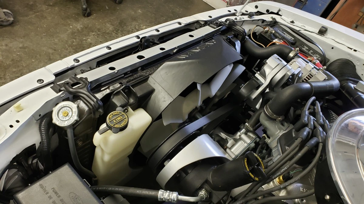

Hey guys,
I'm having an annoyance with my '84 Mustang. When going down the road, the cooling system has no problem keeping the engine cool (normally runs between 197-203 degrees) with a Motorcraft 195 thermostat. The problem starts when I have to sit and idle for more than a couple of minutes. The temperature keeps creeping up until I just shut it down. That can get annoying at times. Yesterday I was in a drive through and had a long line to wait in. When I finally got out on the road, the temperature was at 118 degrees (I did shut it down a couple of times in line). Within a mile of going down the road (35mph speed limit, then up to 45 mph speed limit), it was back down to 197 degrees.
Specs on the car:
351W engine (mild build, approx 400 hp, 10:1 compression)
Holley Sniper EFI with stock dual snorkel air cleaner
NOS radiator (yes, I got lucky and found one for cheap)
New plastic fan
New fan clutch
Has full shroud and overflow tank.
All stock sized pulleys, no under-drive stuff here.
Stock off the shelf water pump
3G-130 amp alternator
This system has no problem keeping things cool while moving, even on the hottest and humid days. Even at 25-30 mph, the temperature will drop if it's gotten hot.
*I was thinking of adding an electric pusher fan in front of the radiator that will turn on in cases I have to idle for a while. What I don't want is that fan to hinder the flow of air while on the road, which I think it will do. I can also trigger that fan through the EFI controller. (EFI can trigger 2 fans, programmable temps on and off, or trigger 2 speed motor, hi/lo, as long as it has 2 separate power wires)
Is this a plausible fix, or should I do something else? One thing, I would like to retain the mechanical style fan, but am not opposed to going full electric if that's the only fix.
*Another question, does anybody know at what temperature the stock fan clutch goes into "full lock-up" to pull more air? Even when I hit 220 degrees, I never hear it engage more for more cooling. I know these clutches always slip a little, so "full lock-up" is kind of a distorted term.
Would going to a better water pump be a consideration? (I'm kind of a cheap ba$terd, so don't wanna spend the money if there's no positive results, and this is an idling only issue).
I'm not in any hurry to tear stuff apart and change things. It does good for now and will make the changes over winter, still want to drive it more this summer....and collect parts if necessary.
Appreciate the help and input.

I started it from cold and let it idle up to temp. Held my hand behind the fan and when the air got warm I looked at the gauge. Showed right about 200 degrees. The temp sensor is located on the left front side of intake (you can see it it the first pic behind the distributor).
Another thing I noticed when waiting for the thermostat to open is it seems to be loosing a lot of air laterally around the fan. You can see how far out of the shroud the fan is. I can only assume that that air is still going through the radiator, but not positive. Going to check on clutch part numbers and depths and see if there's different clutches being made. With the hood closed, you can feel it pull air through the grill and through the vents under the bumper between the foglights.

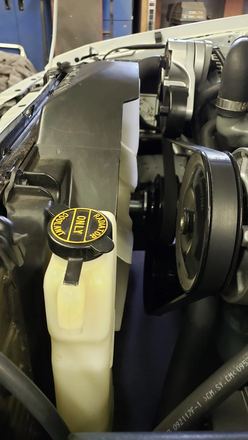

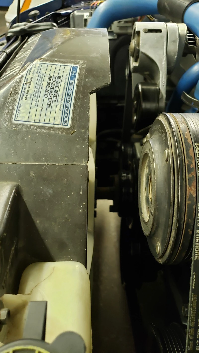

Now on the '87, it's tucked right inside the shroud.
That has me wondering if I got the wrong clutch or what's going on. On my '86 F-150, (351W truck factory) the fan is half way out of the shroud too and that one can idle all day and never get hot. It is 8.3:1 compression too though. More investigating to do.
ETA: When the thermostat is closed and the engine is revved up, the lower hose pulls together just a little bit (1/4" or less). When the thermostat is open, it doesn't move at all.

I did check on the fan clutches and the only depth I could find is 1.75" from fan to mount. It is a thermal fan too. It's the Four Seasons #36990.
Oh, I did check the resistance of the clutch when everything is hot and it has just a little bit less resistance than when cold.
Not sure what to do about the fan depth into the shroud, a spacer would be OK, but it would have to be about an inch long one and at that length, the shaft is getting fairly long.

Found this little tid bit of info from Flex-A-Lite fans "If you have a fan shroud, the position of the fan blades in the shroud is very important to maximize airflow. Looking from the side of the engine, the fan blades should be half in and half out of the shroud. "
This theory matches my truck which is completely factory. But, that makes me wonder why my '87 is tucked all the way inside the shroud. Still going to look for a fan spacer and see what happens.
this is probably dependent on fan blade design, notice that some, I believe this includes the fox body 5.0 fan blades, have a curve at the end of the blade, this may allow for a deeper blade placement in the shroud, I will look at the stock fan/shroud on the dump truck and the fan I bought for the exxon valdez and report back.
