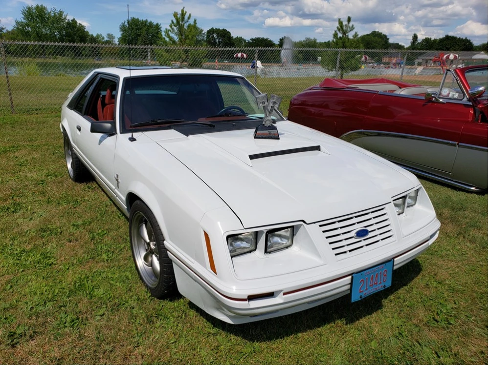

Oh, and took first place in my class.:)

Photo op time...even though it's really a GT350....
