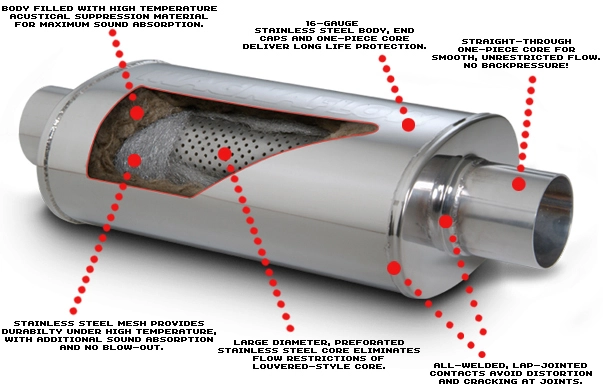

All Bassani mufflers are strait through design, regardless of exterior shape.
I've got the Magnaflow 5" x 8" Mufflers on my car, which are of the Strait through variety. They can be had in both round and rectangular/oval body styles...
....Magnaflow also sells their XL Muffler which come in both rectangular/oval and round body style....and wouldn't you know it, they're chambered mufflers.
Dynomax mufflers also come in either strait through and chambered design and both utilize a rectangular body style.
Bottom line....exterior shape doesn't signify the style of muffler being used.

ouch :) i stand corrected.
