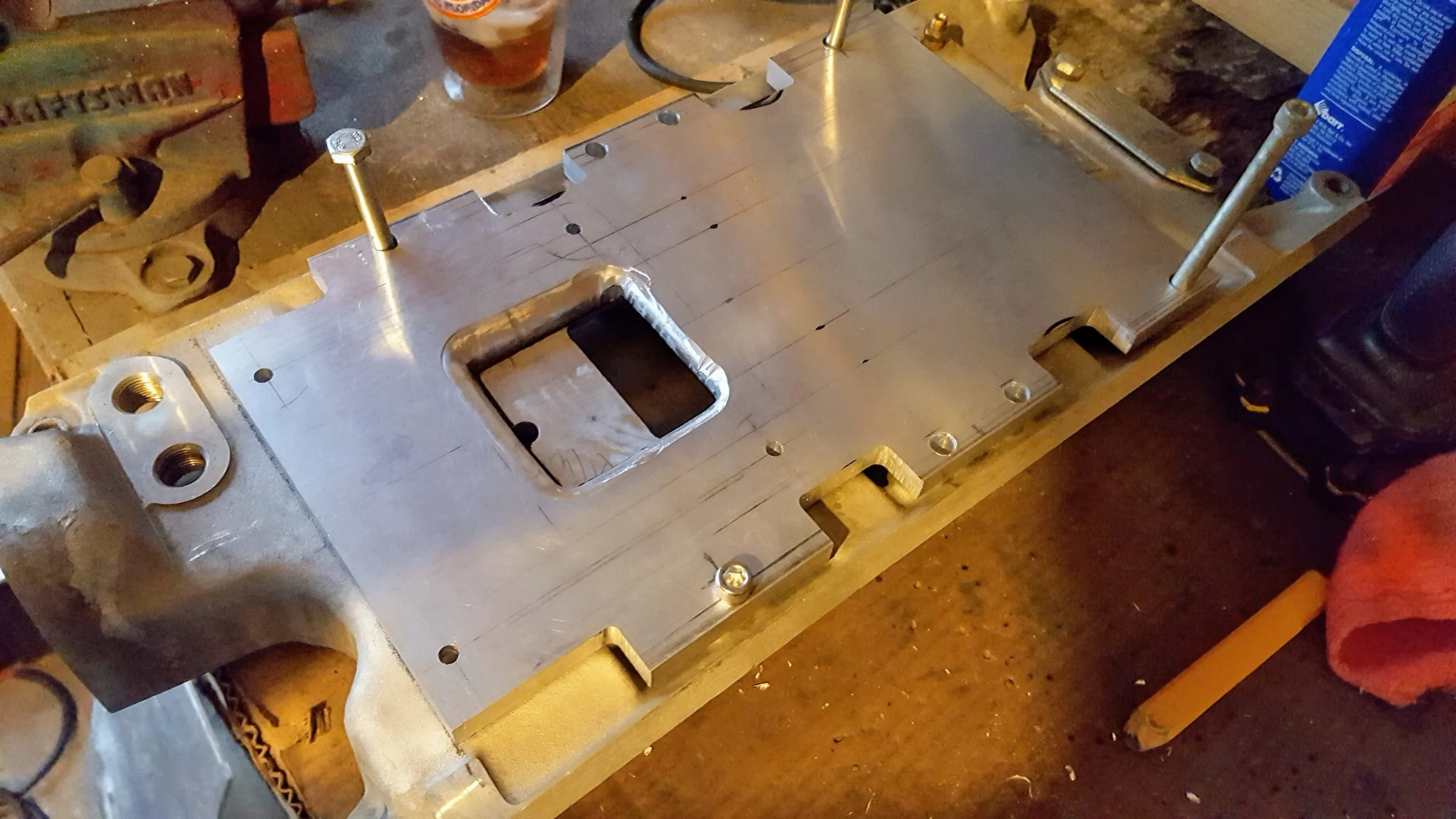

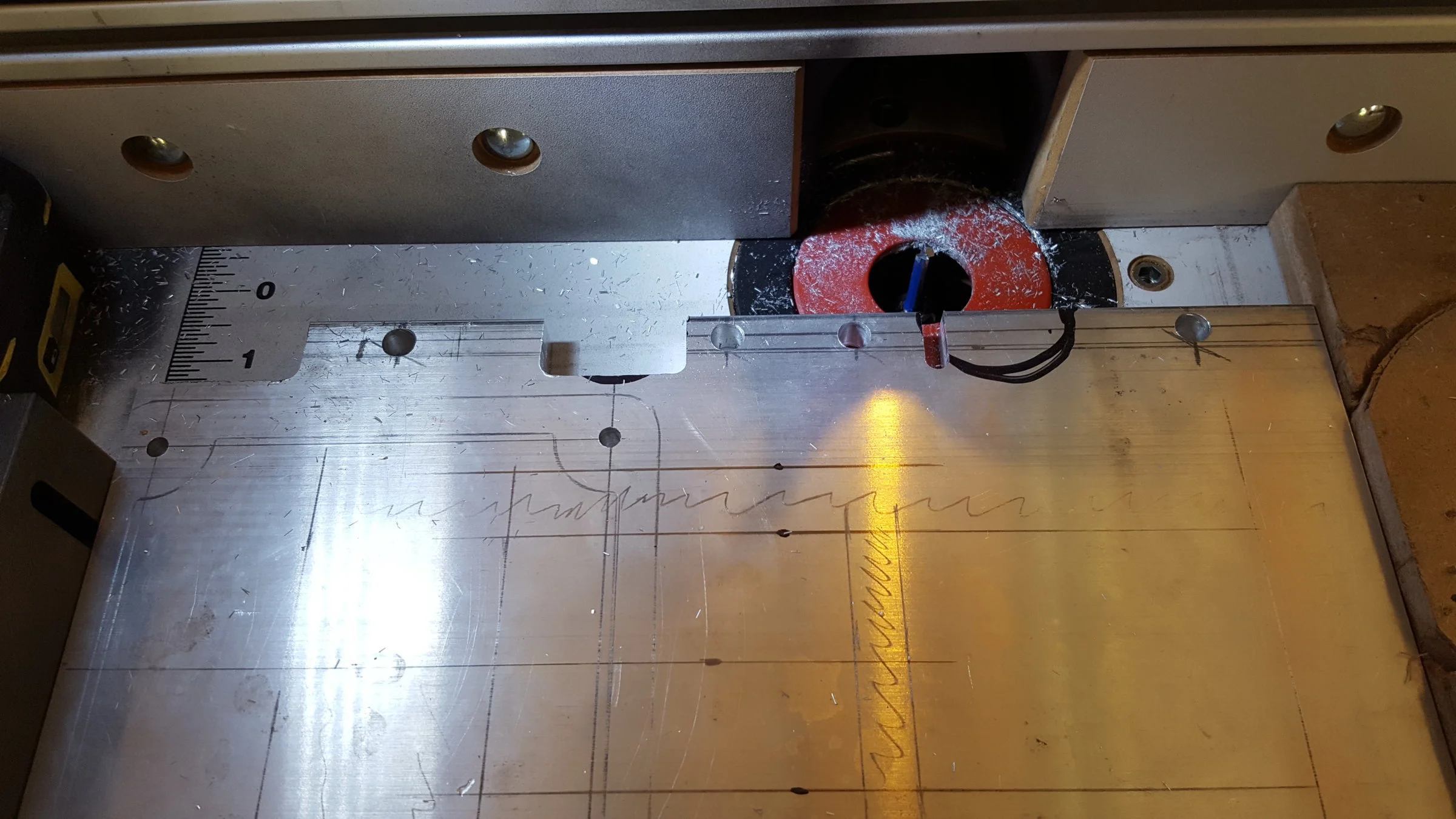

Hello, it's not as difficult as one would think, I decided to go the custom route because I do budget builds. I also make my own parts (Well as many as possible).
Let me know your plan/ideas and how much effort or diy ability you can put tward the effort.

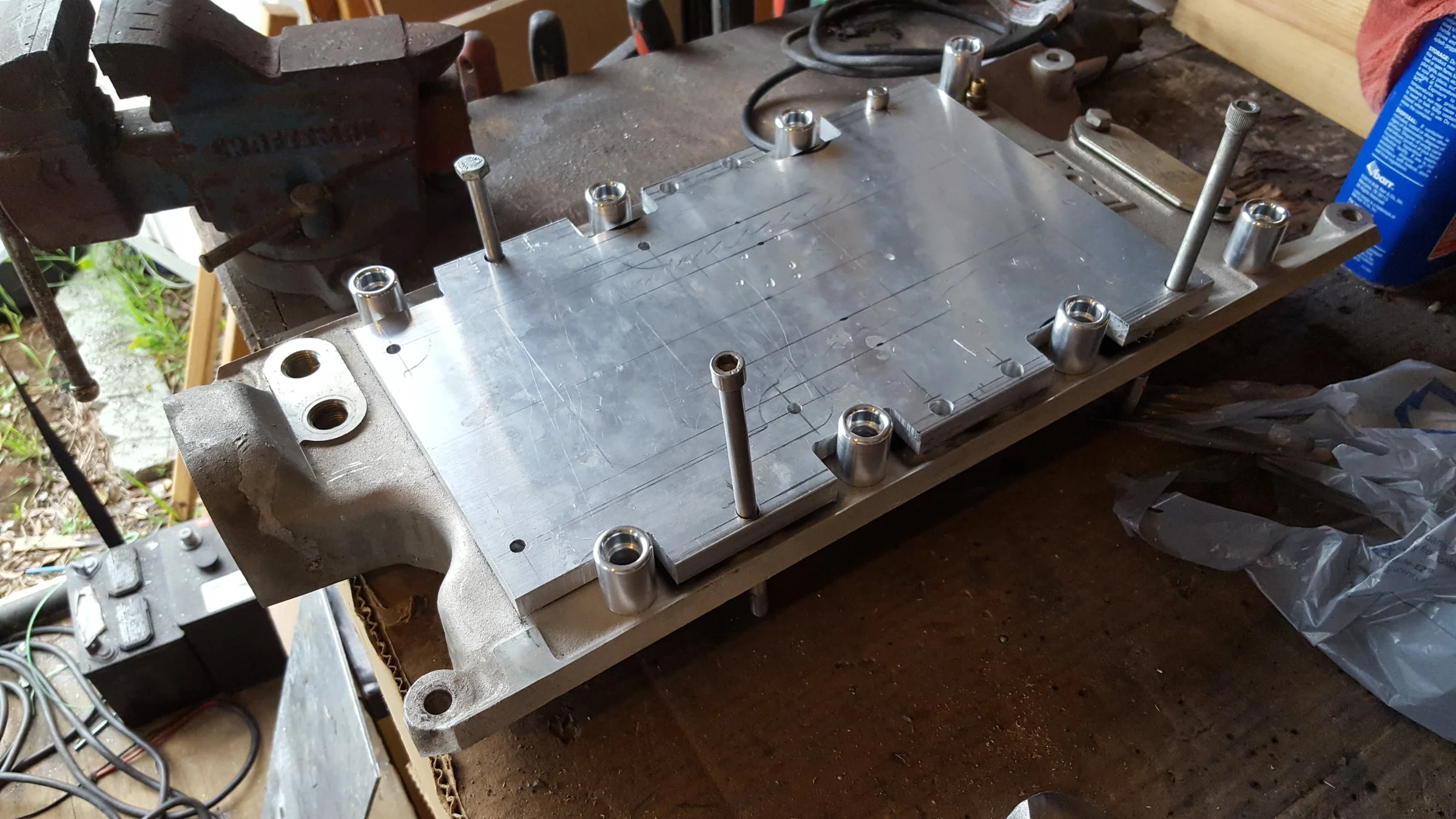

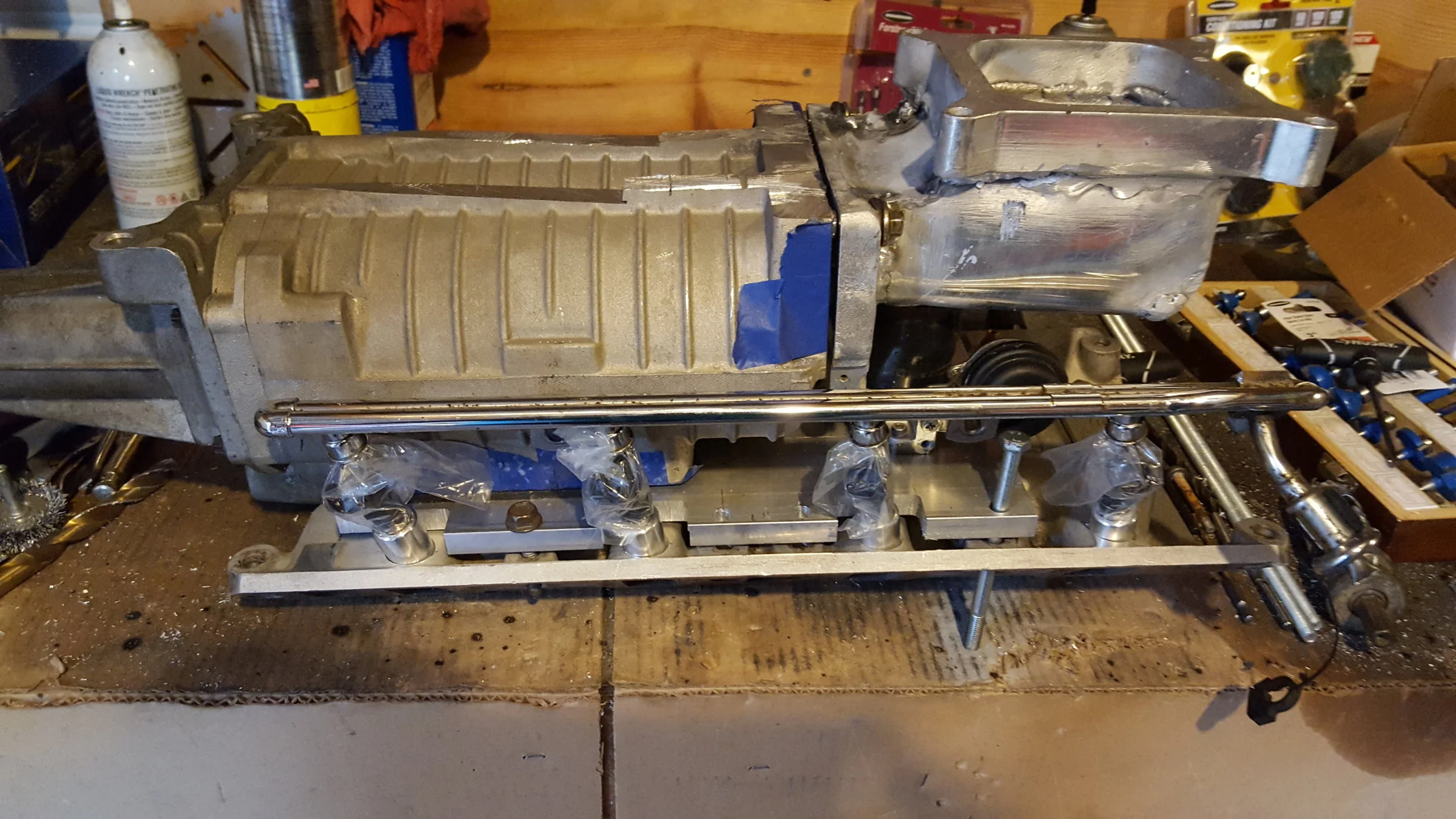

I wish I had that much to work with, I'm in the stone age comparatively.
Here is the general idea for my current build, I have a lot more done at this point but don't have access to the photos at the moment.
This total with the edis8 swap will cost 800$ maybe less depending on how much of my old build (m90) sells.
Reactions: Mustang5L5 and JD1964

Yes I used a router as a bridgeport..... and I only have a cheap mig for aluminum....

The intake was an old b&m manifold.
