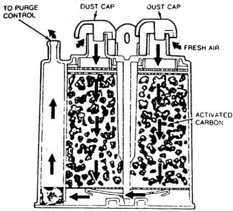

Good diagram of a similar canister. Your line from the tank plumbs right into the charcoal, which absorbs the fuel vapors and saturates. When it oversaturates, you will smell fuel vapors.
When the purge valve opens, it draws in fresh air from the dust caps, through the charcoal and pulls out all the vapors. SO if this purge isn't happening for some reason (solenoid dead, line broken, etc) then the charcoal will oversaturate and begin to smell.
