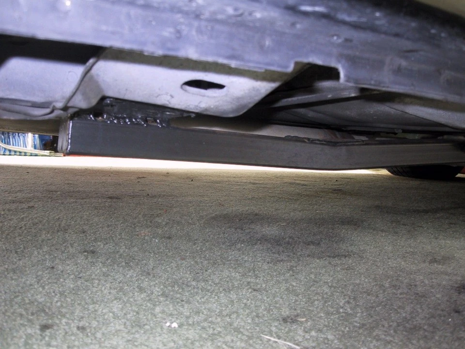

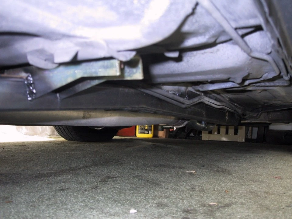

anyone have any good pics of SFC's under the car welded in
OK these are not exactly the best pictures, but here's what I can do for you at this late hour:

thanks for the pics.....The only thing I need to spend $$ on is the SFC's because I can take my car to work and use the drive on hoist and I am a good welder and my boss is a wicked welder....
So should I get Steeda's or MM
