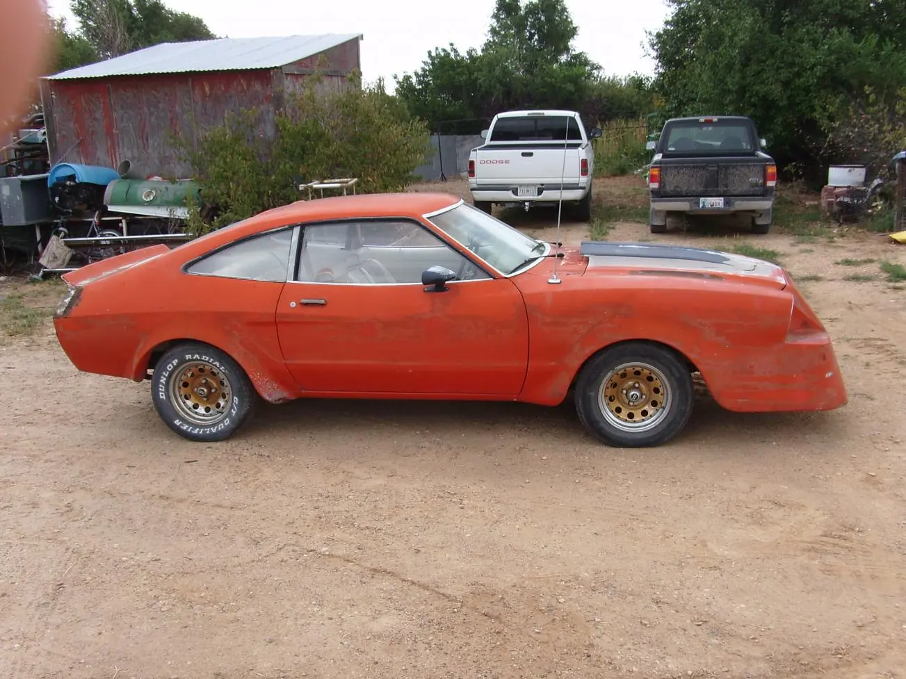

Saw this one in a salvage yard a few years ago and was finally able to get my hands on it last week. Someone sure put a lot of work into it.

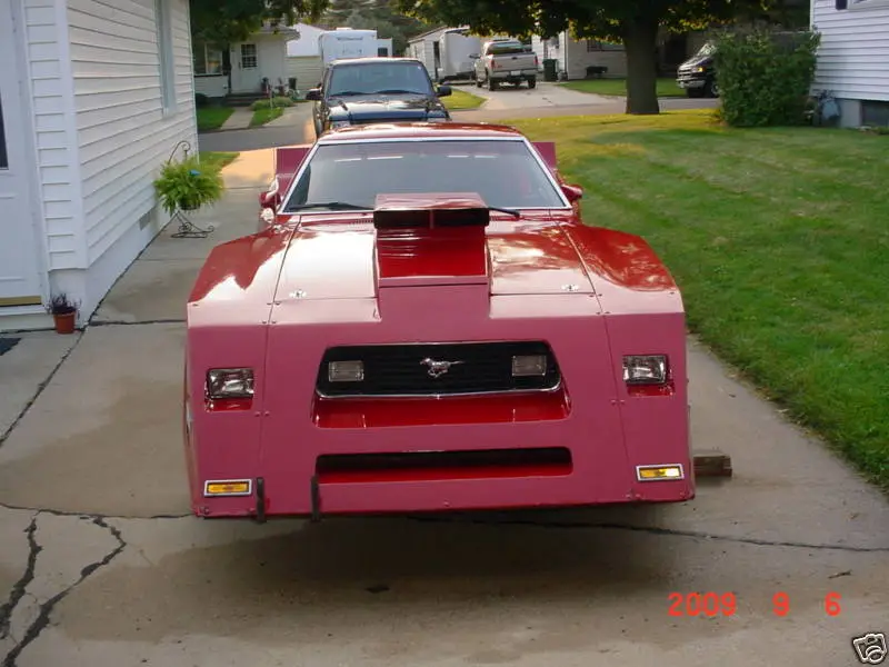

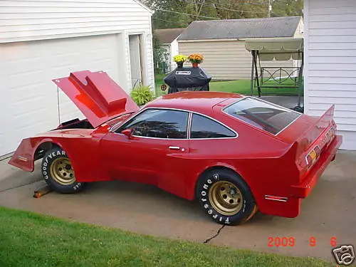

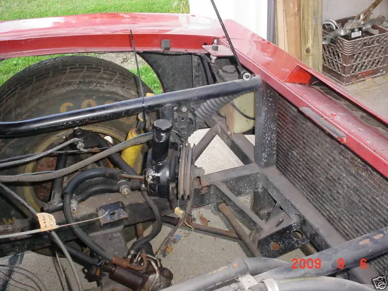

I've taken off the fender to repair some dents. This thing has two radiators, one in the factory spot and the other allong the frame under crank pulley. I'm not to crazy about the air dam. Kinda looks like something out of a Mad Max movie. The 302 runs strong and the c4 shifts great so I think I did pretty good for 500. What do you think

The rear wheel wells look like a generic fiberglass wheel flare was installed.
Is the front one-piece? I.e. fenders and header panel together?
I'd be tempted to cut horizontal slots in the bit that covers the radiator area. That would make the front end look less severe. Or take it to Boneville and try for the land speed record!
The front is all 1 piece and the air dam as well as the wheel flares are steel. the car wieghts about 3205.I had to cut the fender off to hammer out the front left fender flare.
It also has had the rear bumper deleted and boxed off with a custom panel. Someone removed the v8 emblems but I decoded the buck tag and it appears to be correct (v8, auto, a/c) The car was repainted though, it was white.

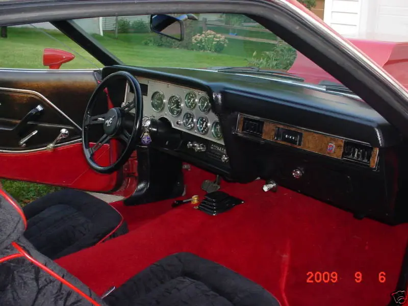

The 302 has the long tube headers installed and must be cammed. Its runs very well and is dang fast. I have not checked yet but it must have some steep gearing in the back as well. The interier is shot and needs a lot of TLC.

The wheel flares and front fenders are steel???
Did you have to pull the entire front clip to fix the one fender? I don't see any gaps.
What about the rear flares, are they steel also?

The front clip and fenders were welded together. So the grille, bumper, air dam , and both fenders were all one piece. I was able to sand it down to find the welds and cut it loose from the grille/bumper. The back of the fender, the end closets to the drivers door, was bolted. Up close, the metal work is good but not great. All the fenders have steel flares grafted onto them. All of which need some rust repair. The front air dam has a tube sub-frame and is strong enough to support jacking both front wheels off the ground.

If its not some historical prototype, I'd be less worried about modifying it. I think that if you gave it a louvered grill opening, it would "soften up" the front end a bit visually, and allow you to remove the second radiator...which would shave some weight and complexity.
