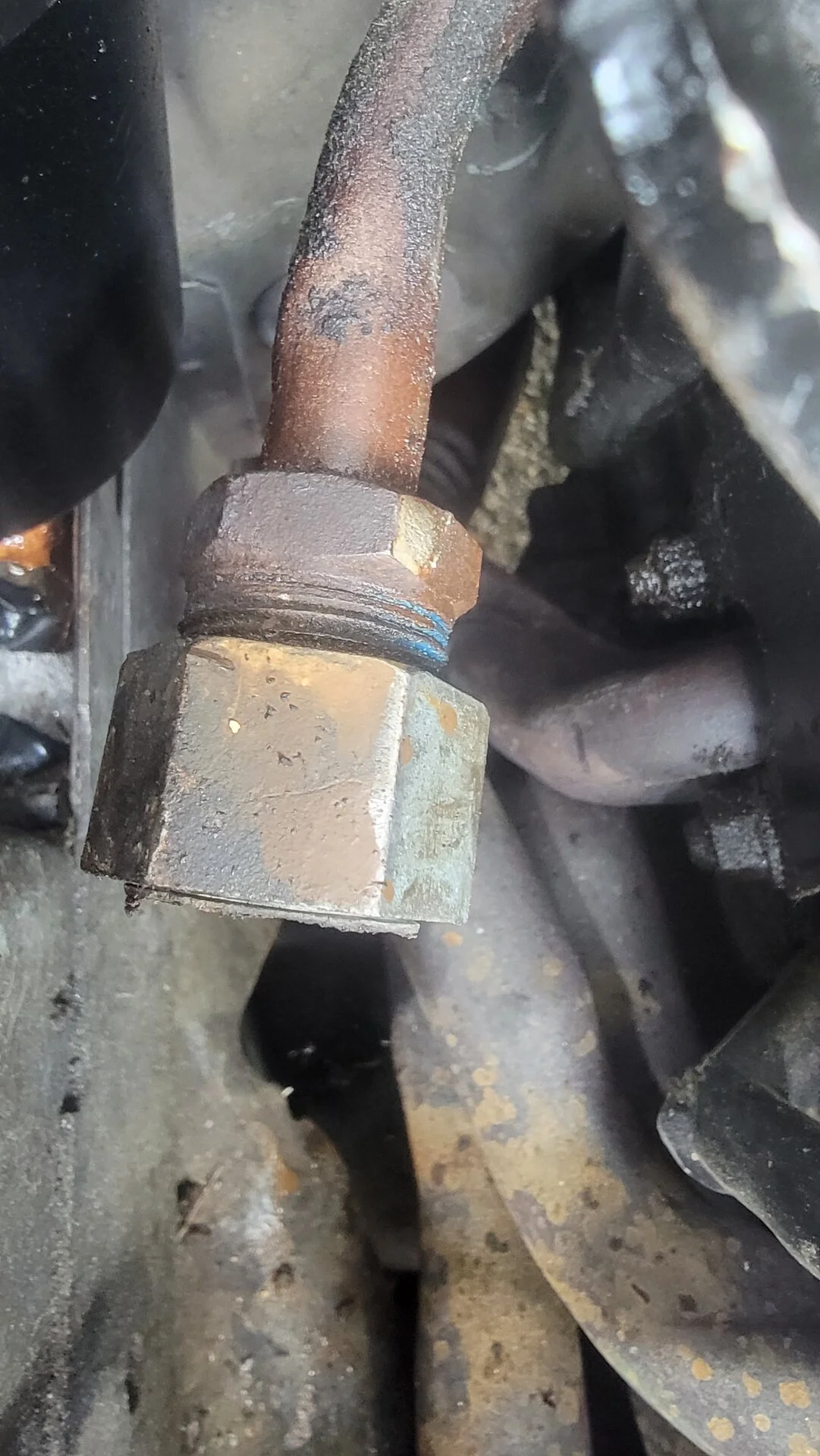

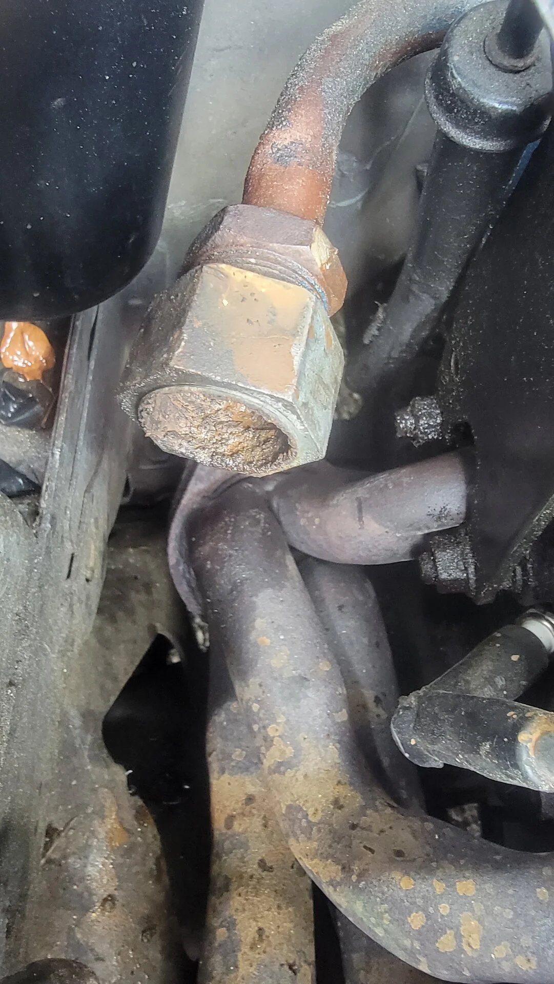

so I had the pipe that goes to the back of the heads just capped off and I bumped it and it broke what do I cap do I get or from the pics what do I do

How crusty is it back behind the engine? You should really just remove the pipe but the challenge is getting the block offs installed. If they are all carboned up it’s gonna be hard

But a new pipe and one way valve is how we fixed them at the dealer

I couldn't get them to seal correctly the first few tries but trying to get all that carbon out to find the threads will be fun and I put them on with red rtv I was told to use copper rtv
I don't believe there are threads in those holes in the back of the heads and the crossover pipe just seals with a good fit
The rtv color matters little. Some of it does withstand heat better like the copper color stuff
The cheap route is just to crimp the pipes off and weld them shut
Yes there are threads back there, it's going to be tough to clean out the carbon and install the plugs with the heads on the engine in the car. I would take pieces you have, make sure the pipe is crimped closed and clean the mating surface good, use brake clean or paint thinner to prep both surfaces, apply the copper sealant, tighten down and let it cure over night, there is a gasket that is used there, I don't know if it is available separate from the replacement pipe, I had a couple from a 'top end' gasket kit.
If you use the copper or red high temp gasket stuff you have to let it set up over night.
ya I had the red on all day yesterday did the final tighten last night then put a bead copper rtv on the outside of them both went for my first drive this morning seems ok but got code 31 I have the book for the codes could I have the Evr plugged in wrong or bad cheap EGR and vavle cause the check engine light will come on when I step on gas then go away and come back
