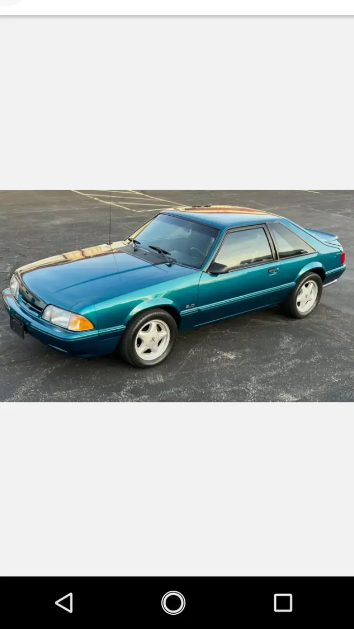

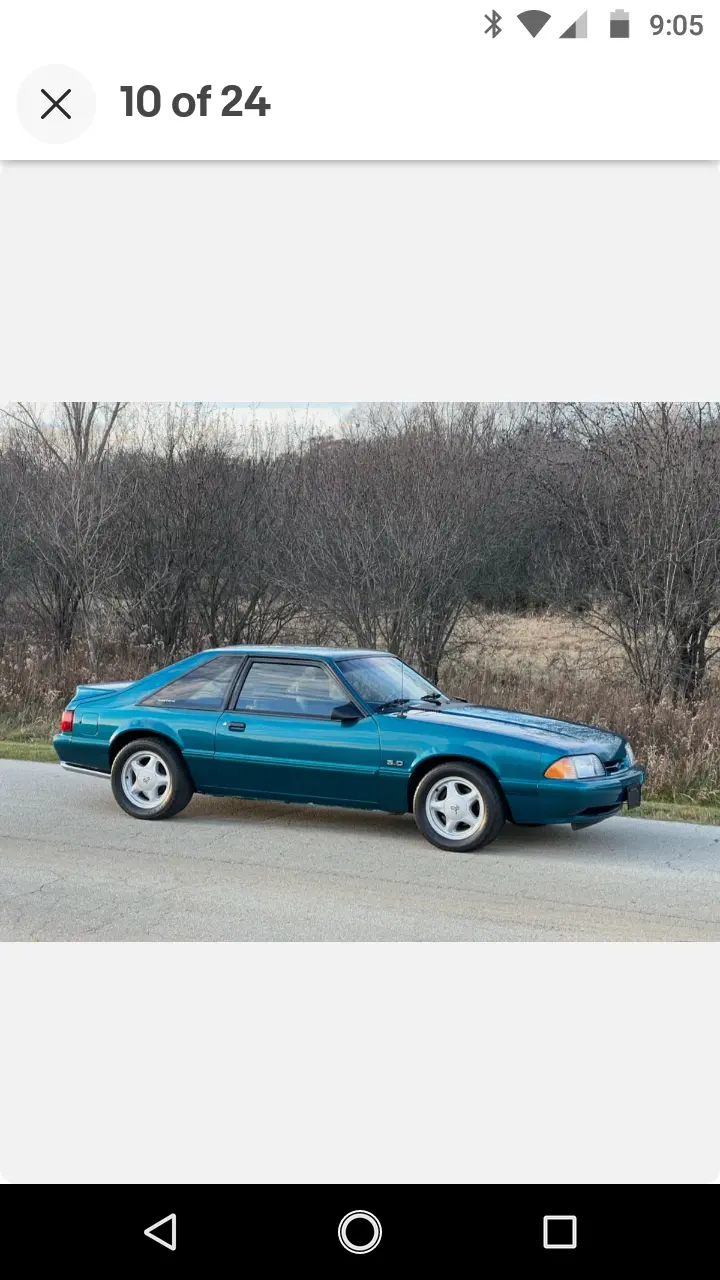

Hey guys!
I'm looking to take delivery of my 93 lx hatch reef blue tomorrow! It's basically all stock except for a catback exhaust.
I plan on keeping it stock for the most part, but always thought chrome ponies look great on reef blue. Plus it's easy to swap back to the original wheels.
I'm keeping the stock suspension, so I want it to fill the fenders decently.
Currently LMR doesn't have them in stock, but no rush. I'm thinking a staggered look, 17x8 and 17x9's.
Thanks and Happy Thanksgiving!

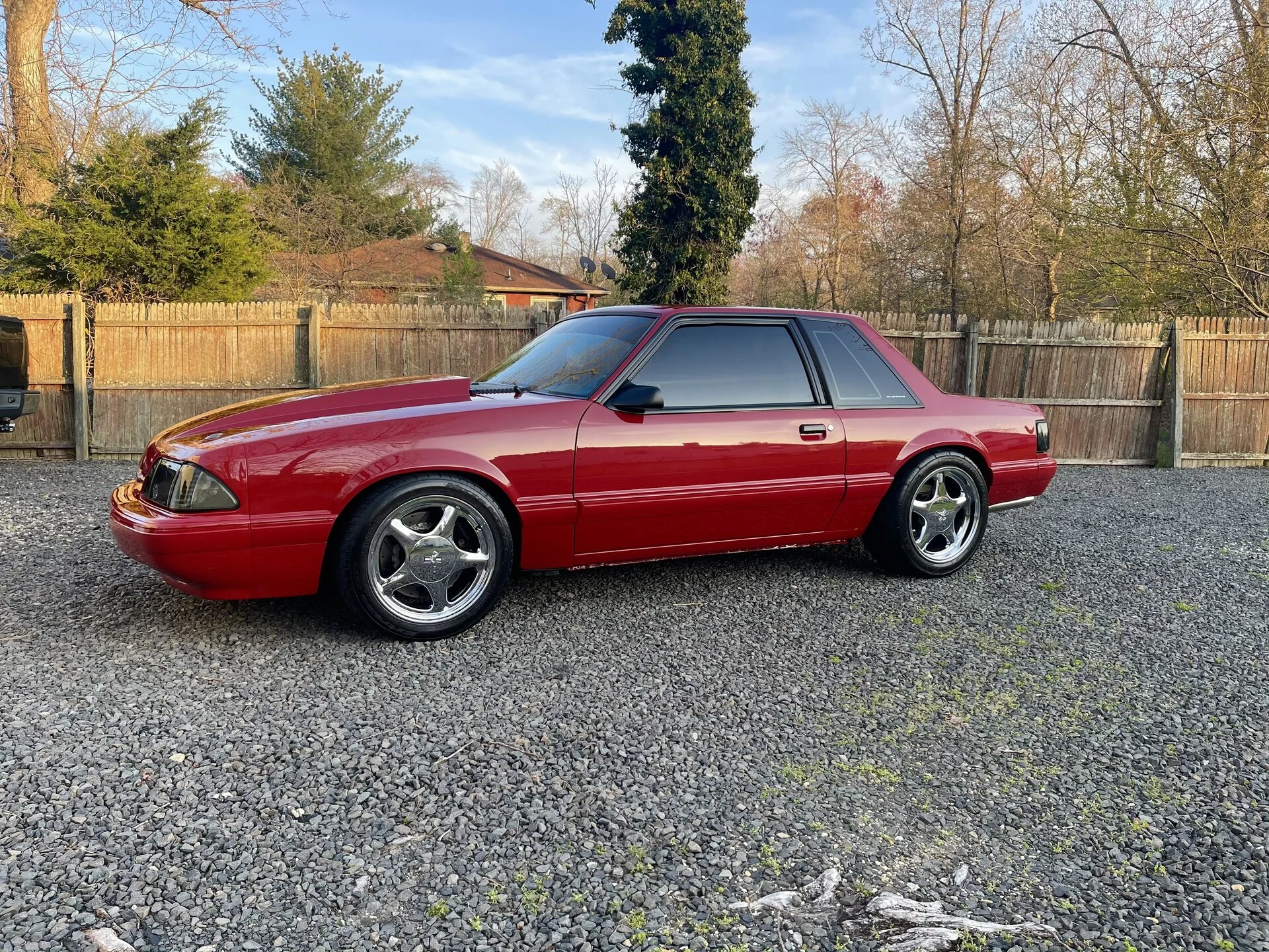

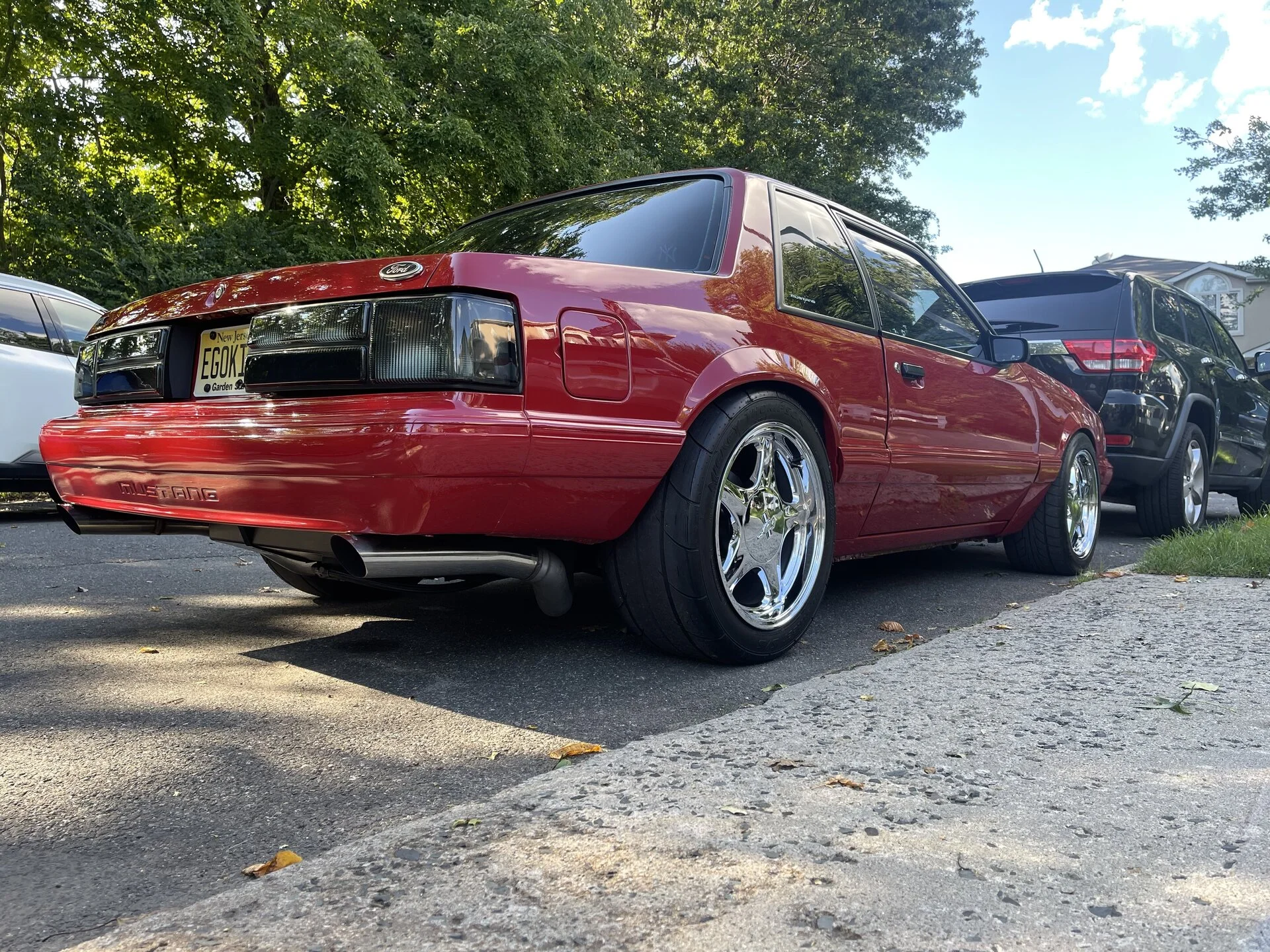

I got on LMR’s notification list and ordered my chrome ponies (17 X 8/9) within an hour of notification they were in stock. I had to reverse the quad shocks for clearance on the rears.
245/45/17 275/40/17 Nitto 555 / Mickey et street ss
No quad shocks , quarters are rolled
Only time it ever has scrubbed is if I go Into a driveway on a super weird angle and the car flex’s the tire super hard in the wheel well it will just catch it off the edge where it stops being rolled . Other wise no

Thanks for info, forgot to ask what suspension or specific springs and is yours a 91?
