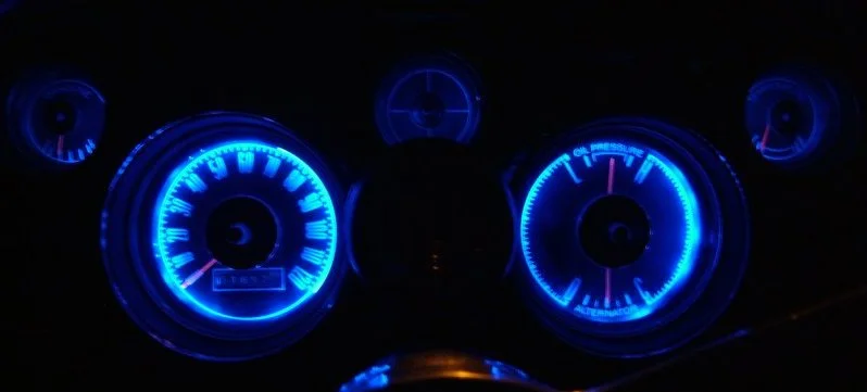

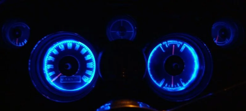

heres what i did to my '67,, i just surrounded the guages with blue leds.
Very nice! Someone else just mentioned the LEDs on another board. Thanks for the picture. Now I can picture what it looks like. I think the neon rope would be perfect if it was brighter. LEDs may be the way to go for those who don't want the white face gauge look.
