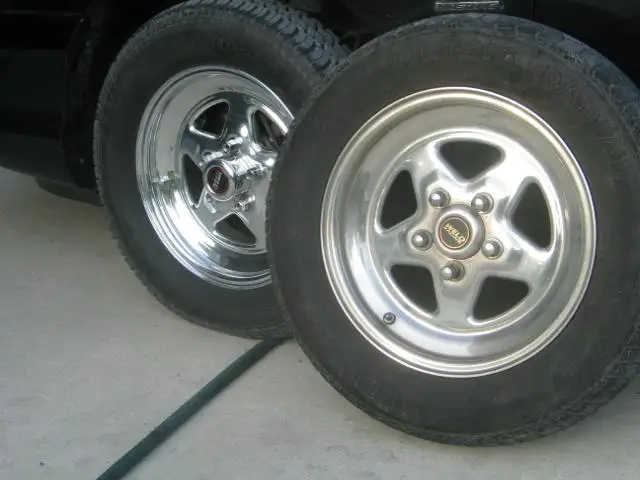

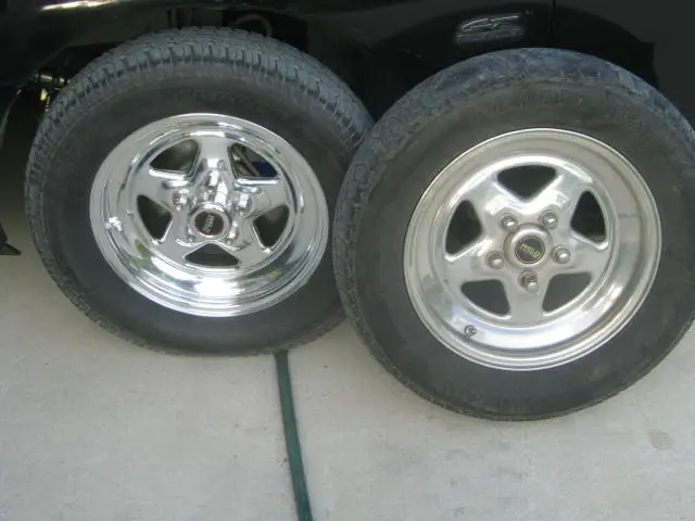

I agree use the Mothers Billet, it's way more expensive than the others, but much better. I just needed a major repolish and tried 3 different types around the wheel. The mothers was way better and took off some dirt and marks the others wouldn't. I also recommend to use an aluminum wheel cleaner (acid based). I used some made by Castrol I think, that really got most of the grime off. It basicaly strips them down, their very dull and nasty looking at first then get ready to polish till your arm falls off.
A little Before and After attached.......................

Awesome, I was actually looking at some castrol stuff the other day (that sounds like the same stuff) I think I will try that. lol polishing until my arm falls off isnt a problem, I just get drunk and get cleaning! :D
