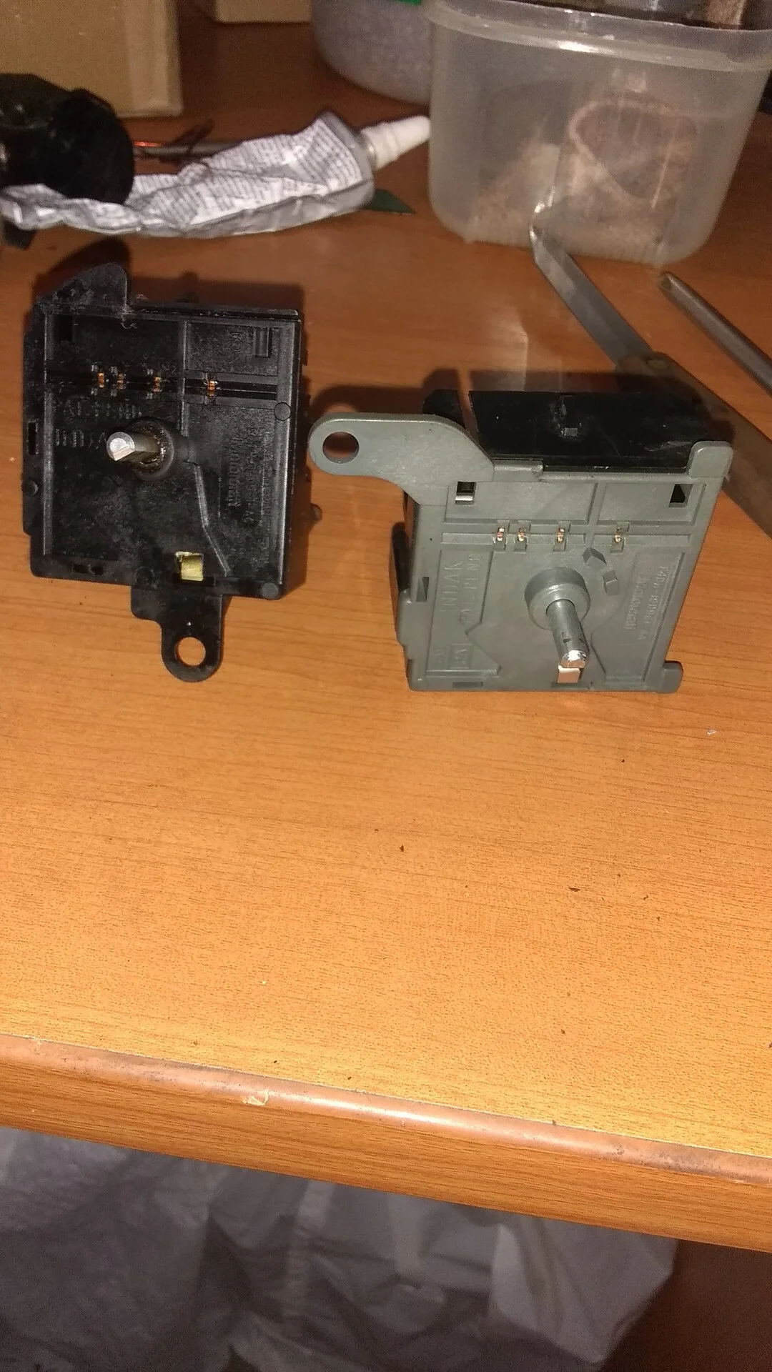

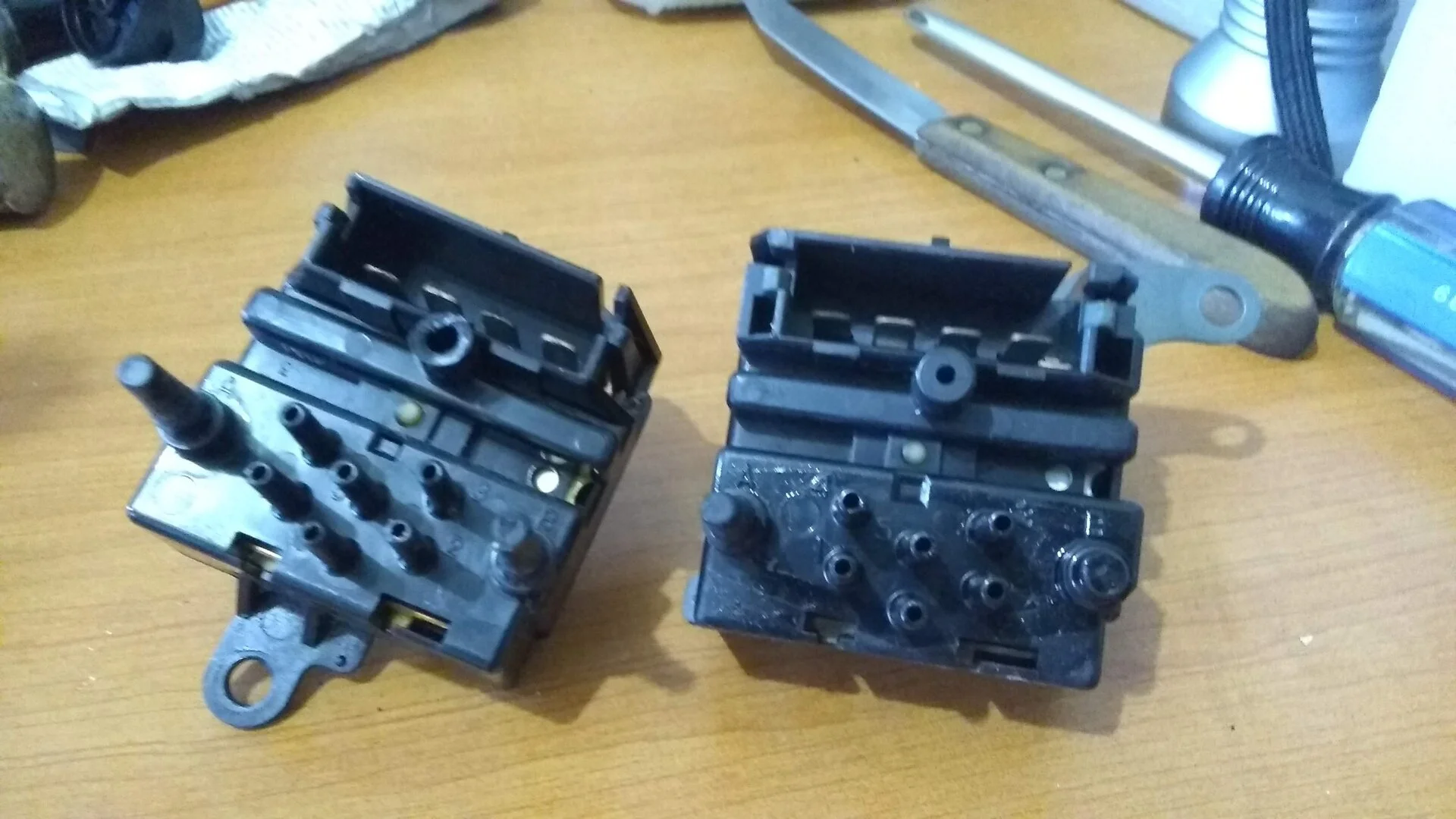

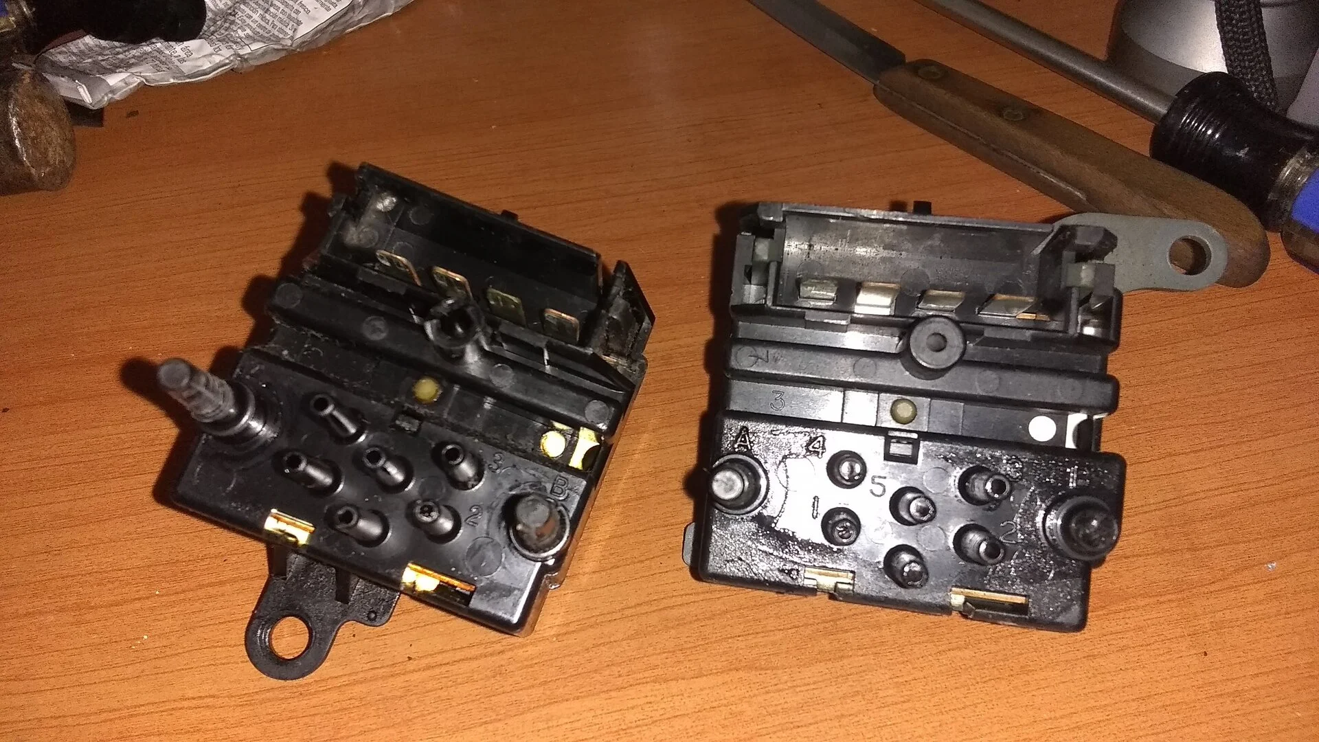

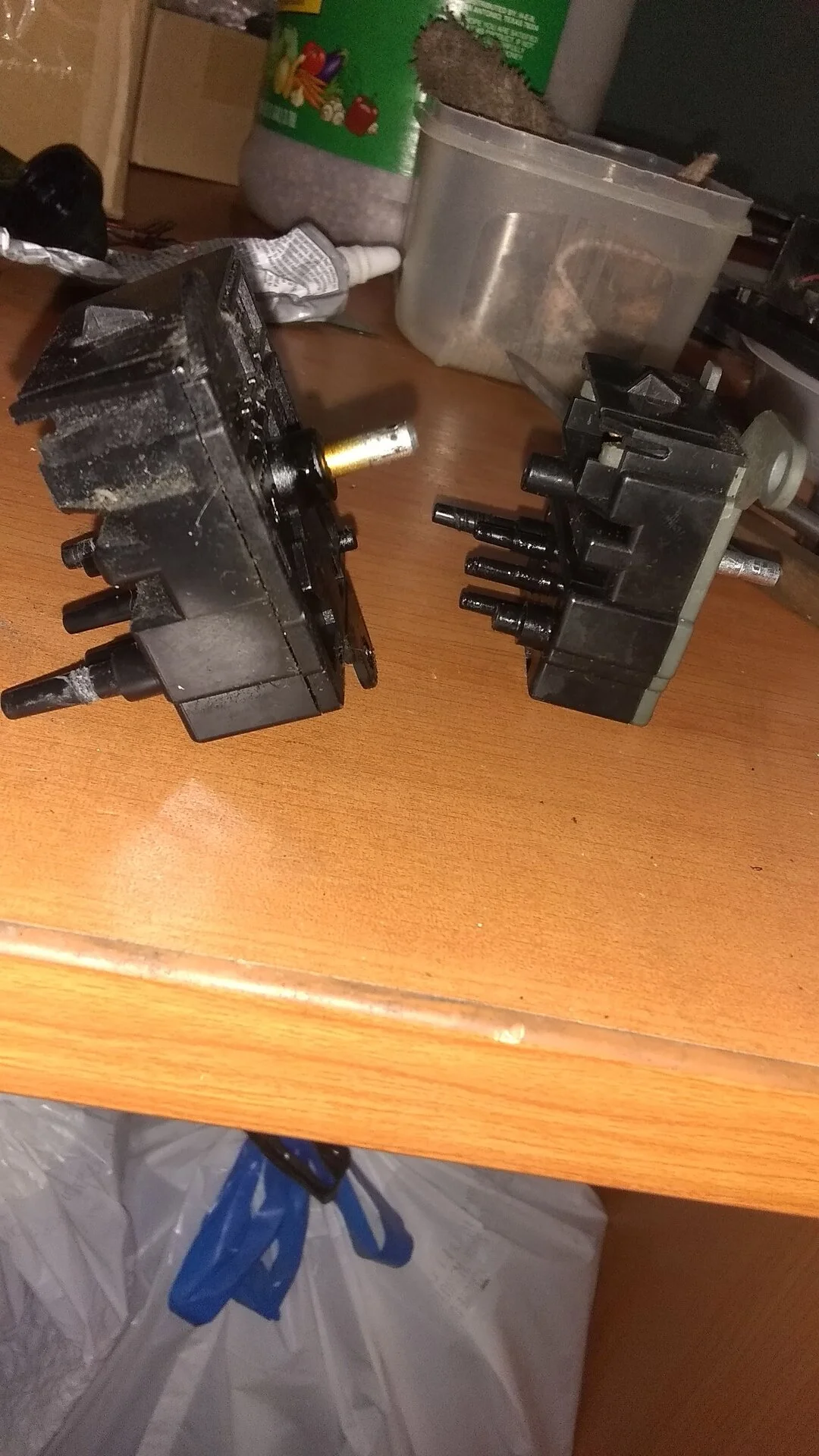

The switches are not interchangeable on the whole. The faceplates are different. It appears the rear housing is interchangeable, along with some internals. The vacuum and electrical connections are identical.
On mine, the rear portion of the detent spring cavity busted off. I elected to build it up with an epoxy cap instead of trying to swap parts.
These are photos of the original Mustang part against the Taurus part. The Taurus part has the gray face.

It looks like you got it figured out. Ive had the same problem twice. Once with the original switch, then one I got off ebay about 10 years ago. But Ive since figured out the spring tension on the rear of the switch eventually breaks out the post and allows the detent ball to flop around. The connections are made through the ball. so without that spring, the switch wont work. You can only really notice this when looking at a working switch side by side with a broken switch Unless your head is in the dash of this thing constantly.
