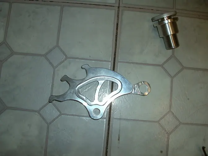

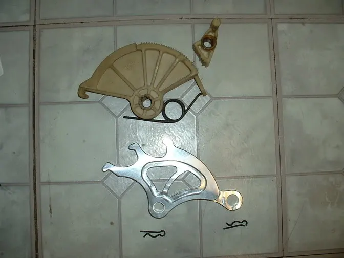

if your using the stock cable you'll want a quadrant and fire wall adjuster, to adjust the stock cable.
the stock ratcheting quad is what adjusts the stock cable. the new quad is aluminum one piece, so you use a fire wall adjuster in the hole where the cable comes through to adjust the cable. here's a pic of a stock plastic quad and a one piece aluminum....and then a pic of just the aluminum quad and fwa.
