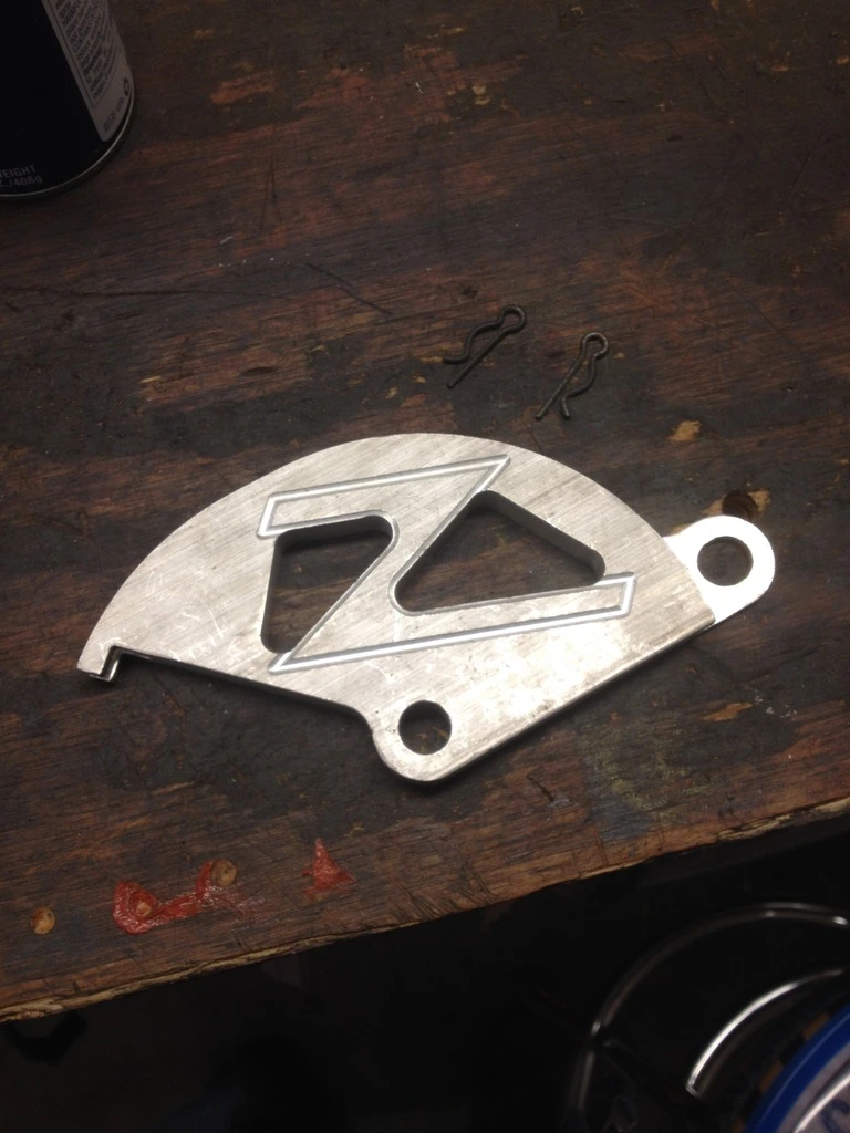

Let me get this straight. When you install an aftermarket aluminum quadrant under the dash, do you eliminate the factory plastic quadrant and also eliminate the plastic factory adjuster? Then, along with the aluminum quadrant, you install a firewall cable adjuster?
Does the firewall adjuster allow you to change the height from the floor which the clutch engages? Right now mine is too low it seems an maybe 1". Makes it prone to stalling it. I want to get it more like 3"
That adjuster is similar to mine, I still got the stock quadrant, cobra clutch, no problems, is your quadrant working properly?
Stock quadrant is working fine but I want to avoid the failure of it which I hear is common. The firewall adjuster I plan to install will also help me get the clutch action where I want it, and keep it there.....hopefully
The quadrant from the donar car is a Zoom brand
The firewall adapter does allow adjustment for pedal height.
That Zoom looks similar to my SVO one. The quadrant part can't be used without the firewall adjuster.
The rubber bushing at the firewall on the factory cable has to be removed. Also, there are three little bumps on the nylon end that hold the bushing....after you get the rubber off take a razor blade or grinder and remove the bumps.
If you have a heavier clutch plate than stock I'd recommend making a support plate for the firewall. The area the cable passes through is also known to fatigue. Its just about a 3 x 3in. piece of steel or aluminum with a hole drilled through for the firewall adjuster to fit through. It helps to spread the load of a heavier clutch kit.
Once the cable, adjuster, and quadrant are installed up top...I found it easier to use a long screw driver or small pry bar to push the clutch fork forward to install the cable at the trans.
I do recommend the firewall adjuster, the rubber bushing on the stock cable is the cause of more than a few clutch problems.
You just don't need the quadrant replaced, it can be upgraded if it fails, 150k and a regular beating, still waiting for failure.
