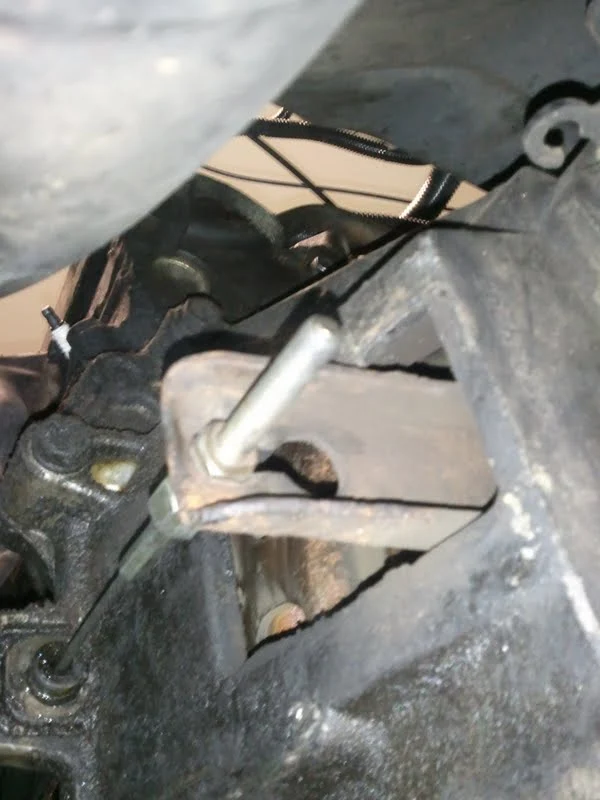

2. i was trying to get the clutch cable off the bellhousing. i removed the dust sheild but i can not get the treaded section throught the channel to pop out of the bigger hole. a picture is attached i took with my cell phone. any advice on how to get the cable to go through the channel? i have enough slack but it seems that section of the cable is too big to make it through the channel.

You can shift the trans it wont hurt a thing, be sure to use reg Dextron/Mercon III ATF when refilling. For the cable, just hold the cable and unscrew the nut, it usually is a 13mm...youll have to reset it all when you put it back in anyway. OR you can use a small pry bar and push the clutch fork in and then the cable will fit through the hole ;)
