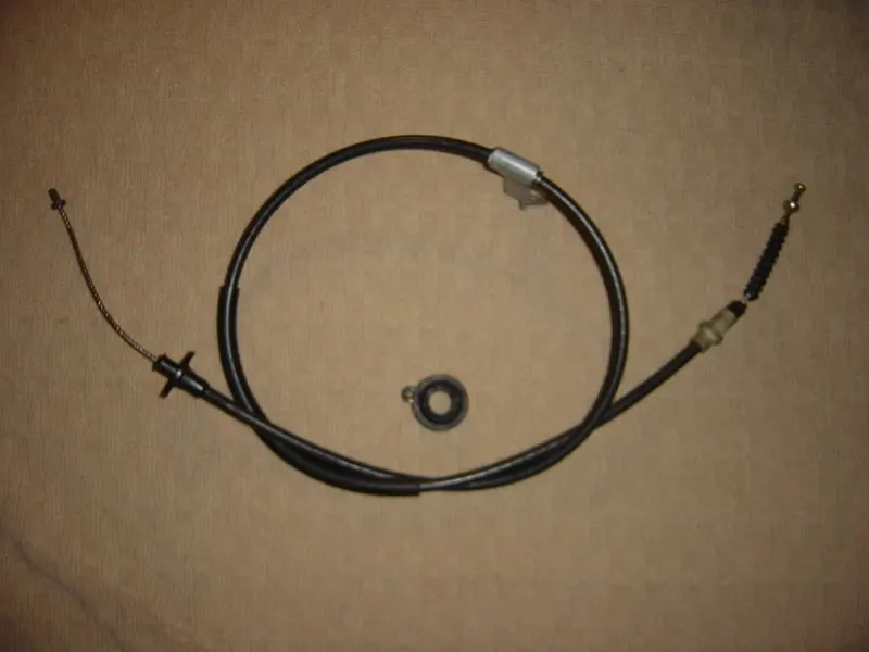

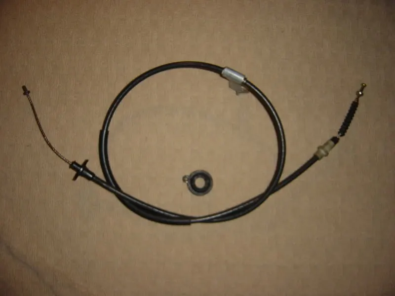

Here's a couple pictures of my new one:
If this looks like the cable you have the only other thing I would try is double checking where you mounted the cable. I know for my Cobra after mounting the bracket to the body the cable needs to be run underneath and over the mounts a specific way. If you mounted it too close to the fork or ran it a different way thats would be why its so loose.
