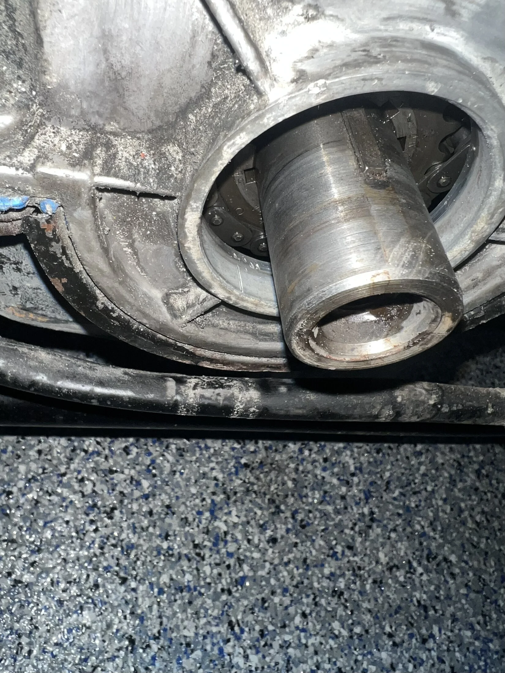

Sometimes they pry out pretty decent and then other times they are stuck like Chuck. A seal puller can make quick work of them and I have even used a couple short sheet rock screws and then used a forked pry bar or a trim panel popper tool to remove them. This is about the only way I know to get the rear main seal out and it works on the front one as well.
This guy has a great idea on how to install the new one but I would use the harmonic balancer installation tool to do this rather than the crank bolt.
Also, use a little RTV sealant (make sure it is compatible with engine oil) on the seal where it pressed into the timing chain cover. Ensures it will not leak at this point.
Picked up a seal puller and got the seal out. The tool left some engravings in the timing cover. Is that gonna be a problem or is it fine?
