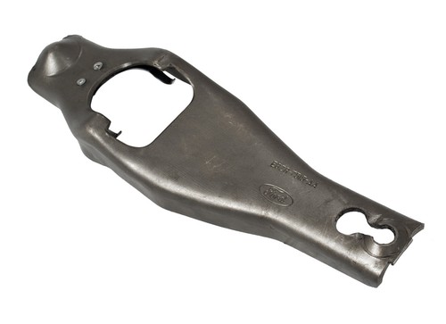

If you are going to use a new fork, I found a heavy duty one on EBAY, I think the seller is BlueOval ... The metal was about 50% thicker.......
I had the 10" in my 83 rebuilt by a clutch shop and used a new 26spline ( TKX) disc, throwout, pilot....... It was OEM and I wanted to re use it...
Thanks! I'll look into the fork. Is this the right listing - https://www.ebay.com/itm/3715266933...d=link&campid=5335821607&toolid=20001&mkevt=1 it's from Blueovalindustries.
