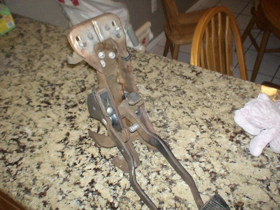

it's not a bad job....the pedal assembly can be removed in it's entirety with the spring.
I would suggest removing the whole pedal assembly, it's not a bad job. Unbolt it at the firewall...two bolts at the brake cylinder, two bolts above that on the firewall...pull the clip out for the brake at the pedal assembly, then there is another bolt or two above the ebrake handle if memory serves me and it'll drop down. It may help to pull the clip out of the pass side of the pedal assembly and slide the pedal right out, then drop the housing.
the reason I suggest to drop the housing, is you really should update and get rid of the plastic bushings...

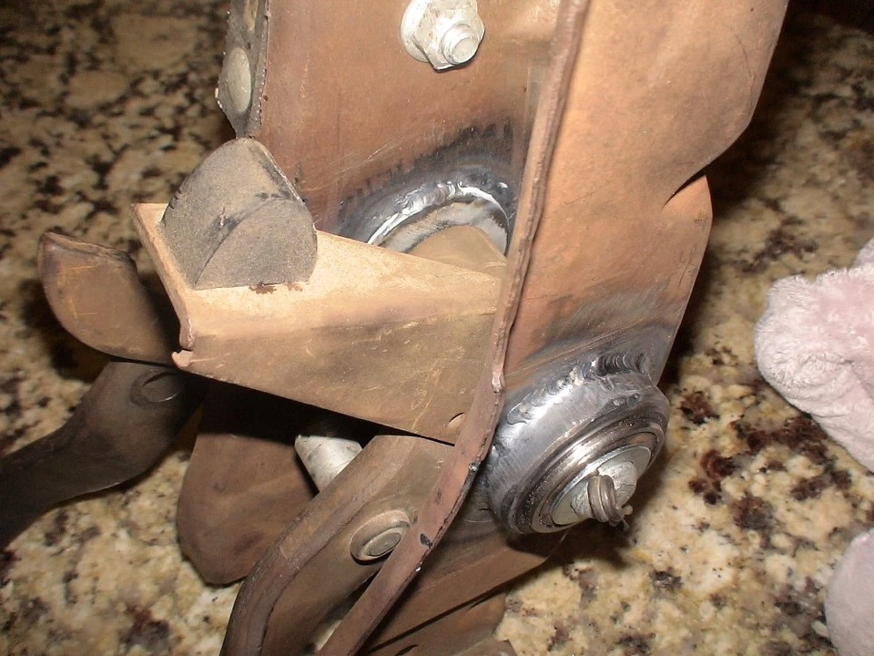

I used the mustangsteve kit and converted it to roller bearings...works like a charm, and effort is like pushing on a slinky...real light.
modified for cable clutch and bearings

If you just want to replace the nylon bushings, you can do that in a couple hours without removing the pedal bracket. You'll have to remove the pedals, which requires loosening the ebrake from the bottom of the dash and forcing it against the fresh air vent. The nylon bushings hold up a lot better when lubed with white lithium grease.
Either way you'll need to remove the clutch pedal, I can tell you a dead easy and safe way to do this, also to install it without effort or danger.
You could also install the roller bearing kit without removing the bracket, but that's a little more work. If the white metal grommets in the bracket are damaged, you'll have to replace them anyway, so do the rollers. I prefer the Drake roller kit, worth the money, even if the kit is screwy and needs to be modified just to work, it requires no welding.
1: Remove the steering shaft 4 bolts/4 firewall screws (10 min)
Remove the brake pedal assembly disconnect the 2 rods, 8 bolts (let the master cyl just kinda hang (20min)
Its not that bad at all...dont sweat it!
I used a needle bearing retrofit kit from NPD when I converted my '68 to a 4-speed and installed a clutch pedal. I had to grind some tabs on the old metal bushings to remove them, but the bearing kit drops in after that and the hardest part is getting the pedal bracket back under the dash.
