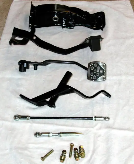

Did you just install a new diaphram style clutch? This is really quite common when going from a stiff 3-finger old style clutch to the newer diaphram style clutch. The under dash spring is actually an assist spring and is used to reduce the effort in depressing the clutch pedal. If you are having a problem with the pedal not returning, you can remove the spring and operate the clutch without it. I have removed the under dash spring and do not plan to reinstall it.
That being said, you may still want to check out your pedal support bushings. I replaced mine with the Scott Drake roller bearing supports and could not be more pleased. I, also, upgraded my entire linkage to rod ends. My clutch linkage is very smooth and provides great feed back.
