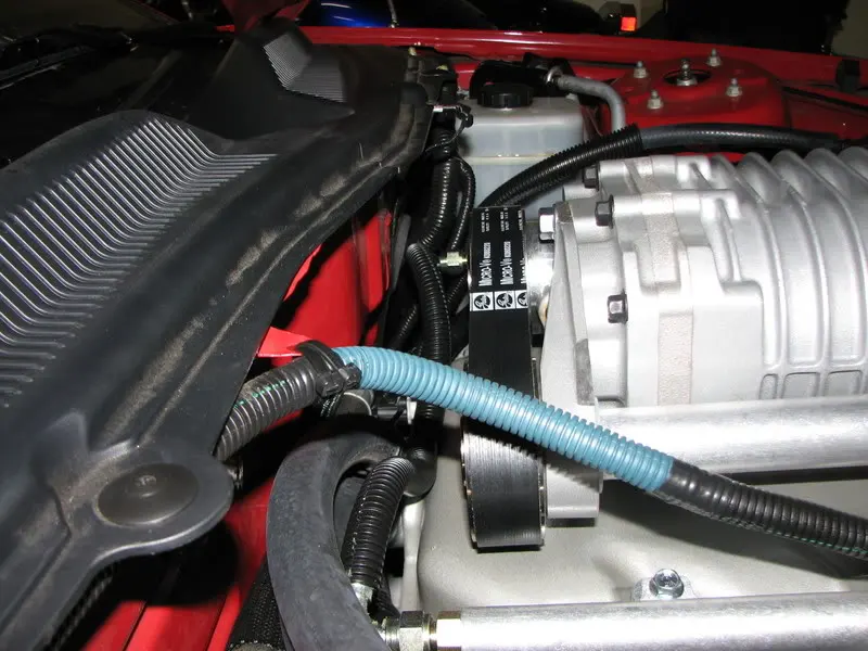

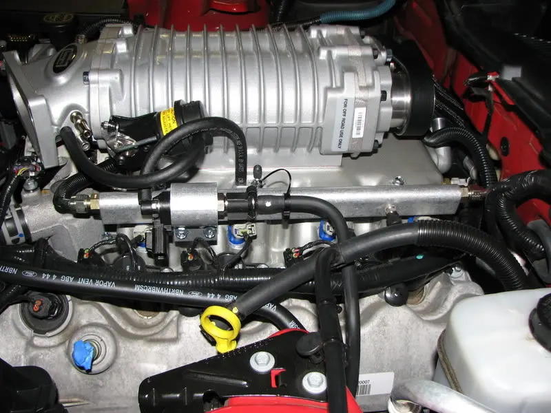

Anybody had to put a new clutch in after installing a Magnacharger blower? I'm in for 30K on the stocker and she's shot. Can the transmission be removed without having to undo the front motor mounts to tip the engine?
It's tight back there.

No need to remove the motor mounts, but I suspect you'll have to pull the SC and the intake manifold. You need to gain an inch or two to gain the clearance necessary to tilt the motor so the bell housing will clear the trans tunnel. It's quite tight. My KB is closer than your MC - but if you try to do it with the MC in place you more than likely risk breaking the plastic heater hose connectors at the firewall. If that happens I think you'll be taking the dash apart to replace the heater core.
