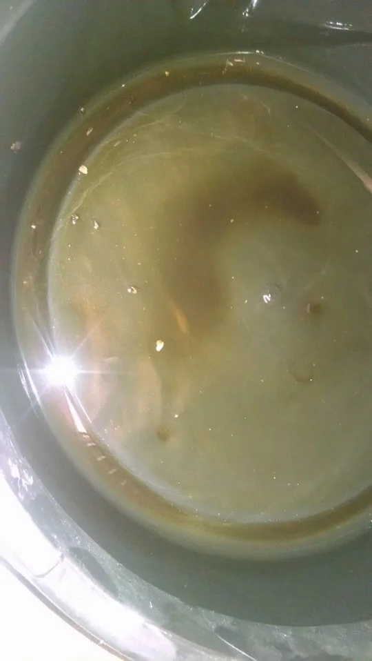

Cliffs: It failed after about 10 months of driving and about 900 miles, no heavy use/racing at all, and absolutely textbook oiling and break-in (much of it video taped and/or witnessed). The engines came with a 90 day warranty, which they extended due to a number of mistakes on their end that required extensive time (/blood/sweat/tears/gray hairs/fractured family relationships) to address. More detail on that in the next post, so as not to clutter the main point of this discussion
The main question is - how do I proceed dealing with CHP? They are a big name shop, and when I was buying was repeatedly told they'd help me out if there were issues after the 90 day period, but obviously phone calls and emails aren't contracts or warranties. What approaches have people had that have been successful (/unsuccessful)? Should I immediately involve a lawyer? This is ultimately a $6500 investment that I had expected to last many years, and which I had gone out of my way to follow their instructions to the T, and where I spent extra pennies (or hundreds of dollars) where they said it'd make the thing more reliable.
Some additional detail on the failure and prior issues...
Use: The car is parked in a garage away from my apartment. I would drive it roughly once a month to keep it oiled, charged, etc. I used 5w20 conventional oil as instructed, changing oil after 200 miles and 600 miles, and used break-in additives for the initial and 200 mile changes.
Failure: Went out this thursday, took a coworker for a drive in the car. After making a left turn and going into 2nd, noticed a "popping" sound. Pulled over, and opened the hood... the popping was loud, seemed to be coming from the valve train (top end). Further, a bearing whine was evident (I'm getting kind of good at that sound, sadly). When i drained the oil yesterday, I noticed the specks pictured along with shavings of iron/flakes of bearing material on the magnetic drain plug. I also noticed that the oil filter mating surface was very dry (and though there was some oil in it, it was less than 1/3 full and had less physical oil in it than my Ford Focus' (whose oil I changed at the same time, and which is a fraction of the size).

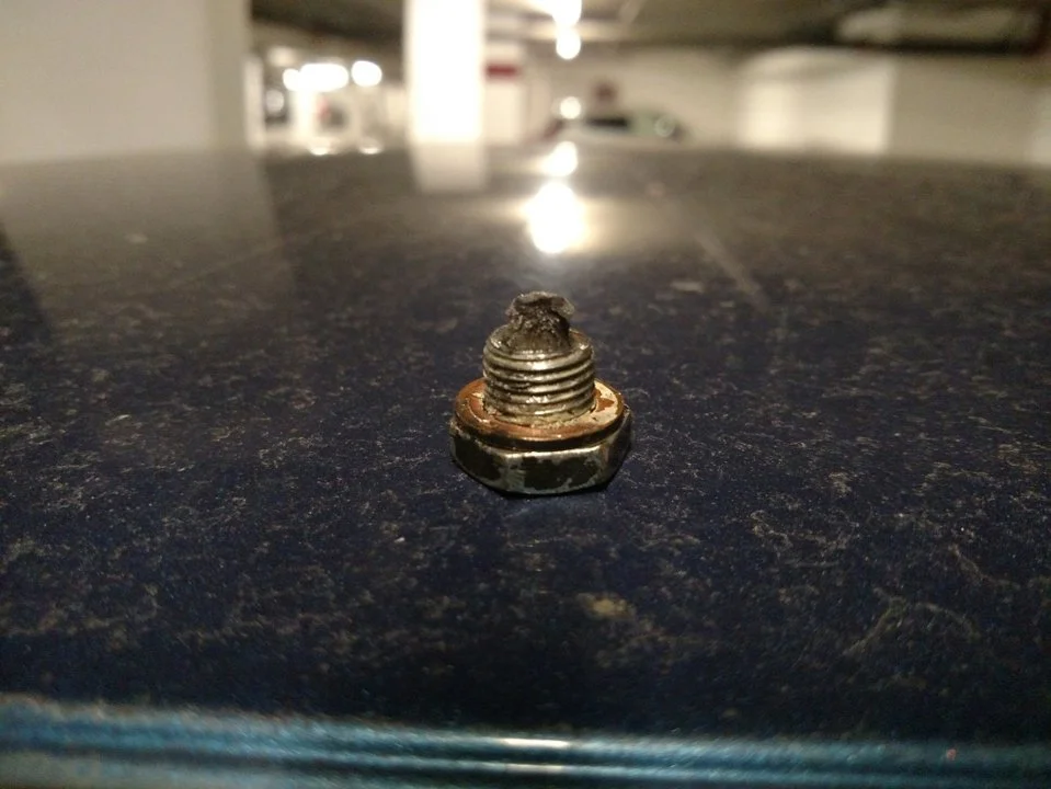

4) Once it was running, in September, my oil pressure sender adaptor failed, as it was excessively torqued into the block. Eventually it sheared off and it started spilling oil, resulting in a cloud of smoke over orange county and requiring one of my many tow truck trips Obviously this is also the type of thing that could kill an engine, and this same adaptor had been used on my prior engine for ~15 years without any problems (and my brothers 302 has the same thing, again, no issues... it was simply installed too tight).

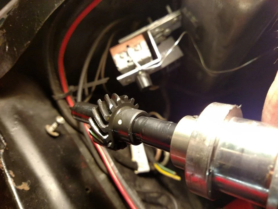

#1. have you pulled that distributor yet? I'm gonna guess that your cam gear is wiped. You installed it, so I'd ck to make sure that it is healthy before you pay one penny for a legal dispute. Cam gear positioning on the shaft is a critical measurement. if the teeth have been destroyed your ignition timing has changed dramatically. ( could also be contributing to the popping noise as a result of a backfire) Also since it is incumbent on the gear to drive the oil pump,.....well just thinking out loud.

Your 15 year old oil pressure adapter was just that.......15 years old. A pipe threaded piece of mild steel fatigues through usage, the fact that they cranked it in there, and it broke did not lend to the failure as well. What may have lent directly to the engine failure was how much oil was spewed out of that sheared off adapter before you realized that it had happened. How long did you drive the car with ??? engine oil in the crankcase after the adapter broke off?
I won't argue much here... you're right on this. It would be tough to link the adaptor directly to the failure. While I can harbor suspicions, there's nothing more than circumstantial evidence and I'd never be able to prove it impacted the end result or was evidence of evidence/mistakes on their part (unlike the other examples). And to answer your other question... less than 2 residential blocks.

Just the oil. There's bearing material in the oil which means its done; taking the valve cover and distributor out may or may not help with the 'why.'

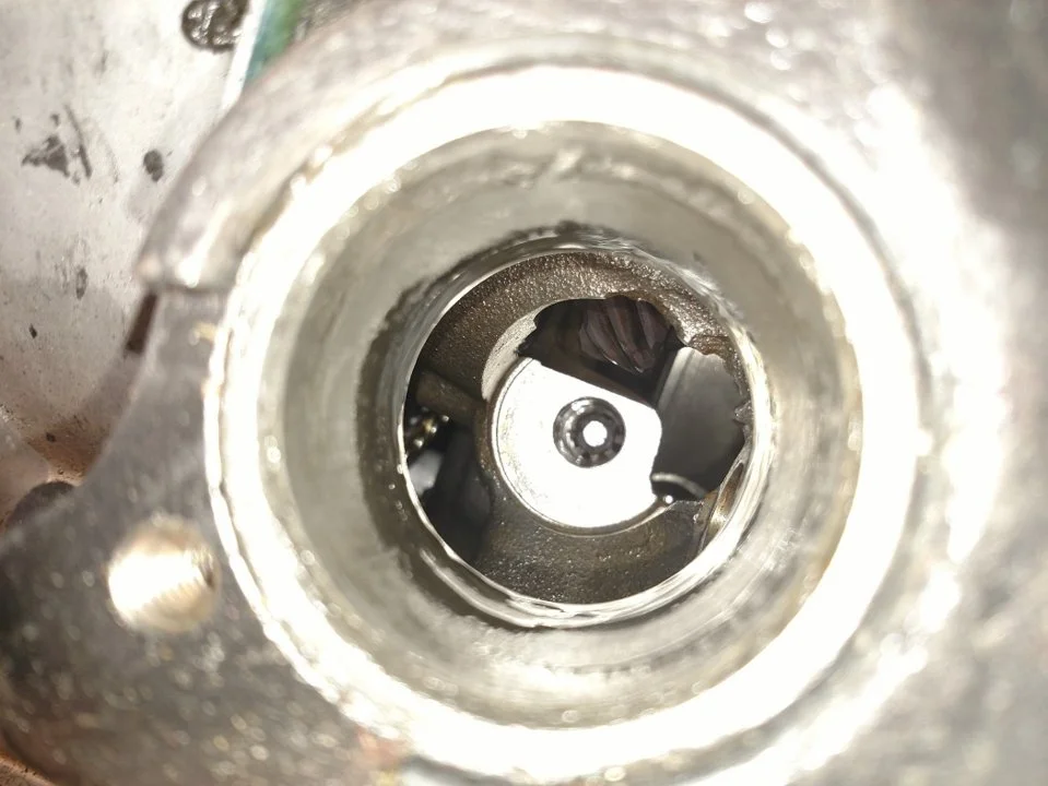

Out of curiousity, if the distributor gear/cam was the ultimate cause of everything... would there be obvious damage to the cam gear? I'd be hoping to rule that out one way or another just by removing the distributor... if you have to see the cam that'll be much more difficult.

You will absolutely be able to shine a flash light down the distributor hole to inspect the cam gear if there is apparent damage to the distributor. ( Coming from a guy that has smashed an awful lot of valves and pistons with broken valve train parts )

Prior 351w was hydraulic flat tappet. I bought the Summit conversion distributor gear for use converting the distributor from summit in the same order, thats the on they didn't install (just confirmed that the summit one was interchangeable with MSD's own gear, for what its worth).
And I have the email where I tell them thats the kit I'm using and that they should install that steel distributor gear.

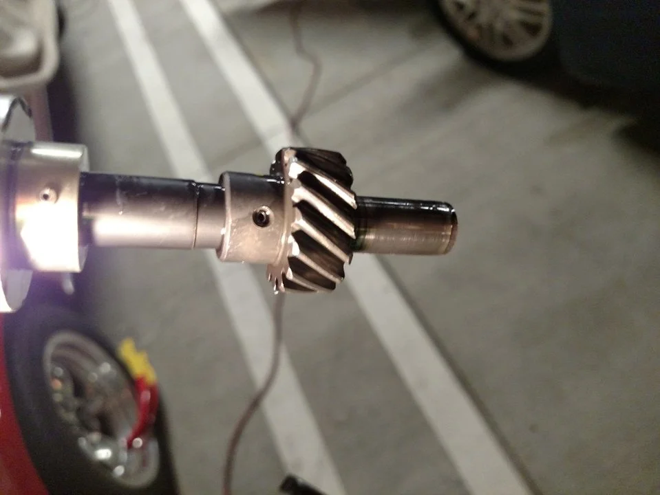

I removed the distributor. Gear looks like it did when we installed it, and no carnage evident in the distributor hole on the block. Also verified it is indeed the summit gear (see yellow dot) for roller cams, so we got that right. See pictures.
