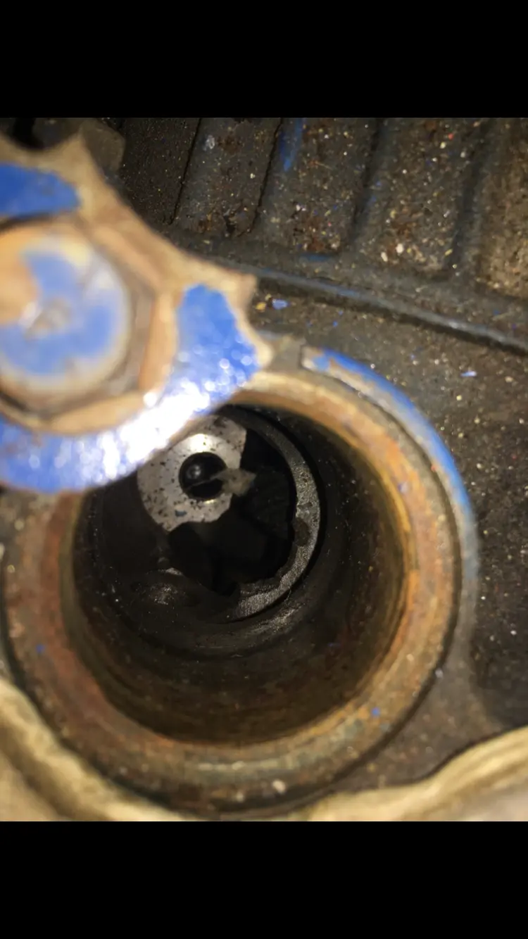

On your first few pictures of when you took your distributor out and you took one of inside the hole, the metal above the cam was chipped and I'm wondering if this is a problem? I have a 302 I acquired and it's a project but it's not bad except for my metal above the cam is also chipped like that and Im wondering if it matters or not, and what it's for, if anything?
I've included a picture of mine

Well, if for nothing else other than to find out what happened to the OP's engine,..(cause I assume that he's pulled it by now)
The factory casting process leaves all kinds of divots, slag, and rough finishes everywhere. If there was no need to machine a part of the block after it was cast, it's left alone. Areas of slag may have been "chipped" off at the factory for the sake of needed clearance. The fact that your engine and this one look similar is a testament to that "necessary clearancing".

I had a buddy say that it could be to hold in the distributor when it's running harder at high rpms and I personally do not think that's what it's for, but what do you think? Will my distributor be held in just fine or not?
It will be fine,the distributor is supported up top with a hold down
