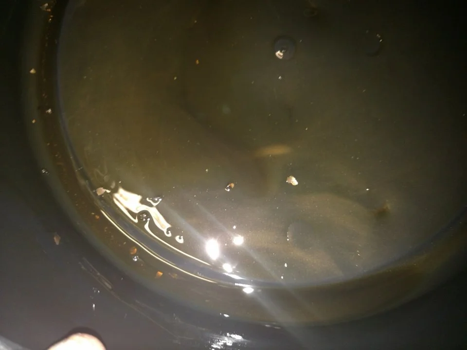

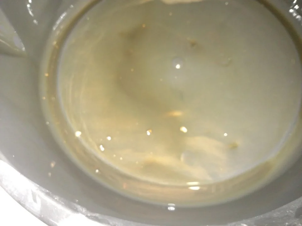

You said there is bearing material in the oil....picture of the oil. When you say the engine failed were there other indications like chatter, knocking, smoke, loss of power,....or was it just you noticed the bearing material in the oil? By material are we talking small particles or chunks?
The reason why I'm asking is this sounds like the initial oil change. What did the 500 mile break in oil change look like, because you can have acceptable amount material in this period. I'm curious

Again, (forgive if you have already said it) but I'll ask again. What failed? or,...Did anything actually "fail?" All I've seen are pics of junk in your oil. The pieces are certainly huge, and I would've expected to see a come apart somewhere on the top end to leave so many large pieces of junk in a drain pan.
If you are going exclusively on that w/o any any audible noise accompanying it it could be several things that range from the block was not cleaned properly, and that is machining crap, to the early signs of bearing failure. The only way now for you to ascertain that is gonna require that you pull the pan, and remove some main, and rod caps.
The oil had been changed twice prior. Once at 200 miles and once at around 700 miles.
edit: The oil in both the 200 and 700 mile change looked much better, though still somewhat dark with some metal shavings, as you'd expect in a break-in. No flakes though.
Here's a pic of the flakes (not sure where it went..)
I'm not sure exactly what to say. I haven't been able to tear the engine down and likely won't for some time. The flakes in the oil, based on my somewhat limited but not totally zero experience, indicates a bearing has failed. I don't know which, and I haven't physically seen it. Unfortunately my access to the car is limited by a couple factors, so this process might be (likely will be) more drawn out than ideal.

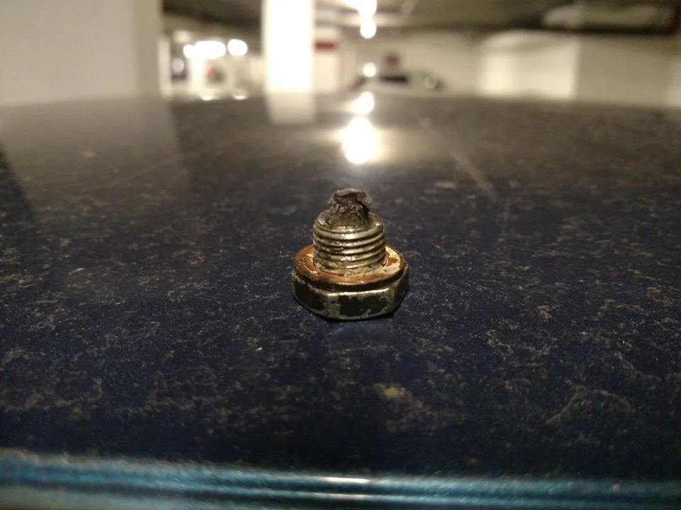

No. I thought that picture was sharp enough that maybe someone with a better eye would see it, but since it isn't... I'm going to try to stop by the car after work, maybe with a magnet, to see if i can see it/fish it out if its loose.
I guess the pushrod just engages into the bottom of the distributor in the - eyeballing it -3/8" hex/allen type interface?
I guess i should see an 3/8 socket/allen interface in that hole. You'd think it'd be visible in that picture if it was there...
If it's not there( I couldn't discern it on the photo) then it twisted and sheared off. Hence the groan, your huge chunks of metal, and probably theloss of oil pressure that will wipe a bearing.
