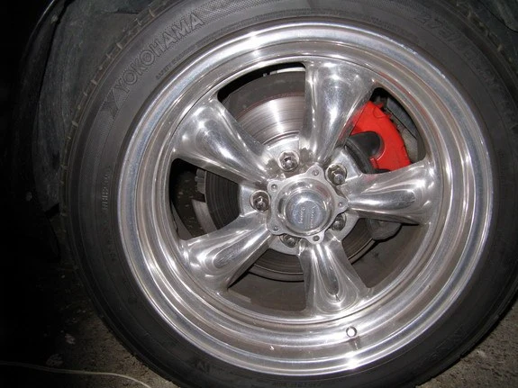

The only thing you have to do in order to get the 99+ stuff to work is grind down some of the spindle area were the caliper bolts. I did this with a dremel tool and drill with a grinding stone attached its just a matter of taking off as much as needed to clear and it not anywhere enough to weaken the spindle. You can pick up the breaks off any 99-04 v6 or GT I would get the lines as well and for probably around $100-150. If you dont get the lines and upgrade to braided your looking at around $200-250 for the upgrade with fresh pads.
here is a pic of the 99-04 setup, I also painted the caliper prior to installing.

I used the VHT caliper spray paint. It holds up very well. I wire wheeled the caliper and cleaned with some paint reducer I have laying around prior to painting. I also used several (7+) light (barely any coverage, like overspray almost) coats with 10-15min dry time between coats. Its been about 2+yrs and like your car is only on the road from March/April to November or so and never out in crappy weather. When I wash I generally use an old sock to just wipe off some of the break dust/grime and they clean up well. I have like one nik from when I pulled the front wheel and when putting it back on lost my balance (did not move some stuff out of the way in the garage and was at a funky angle) and one of the spokes was jammed into/across the caliper, took off a VERY small little piece and I just cleaned it up and sprayed some of the paint onto some cardboard and dipped a Q-tip into the paint pool to touch up. That pic is from last spring IIRC so about a year or so after painting maybe a little longer
