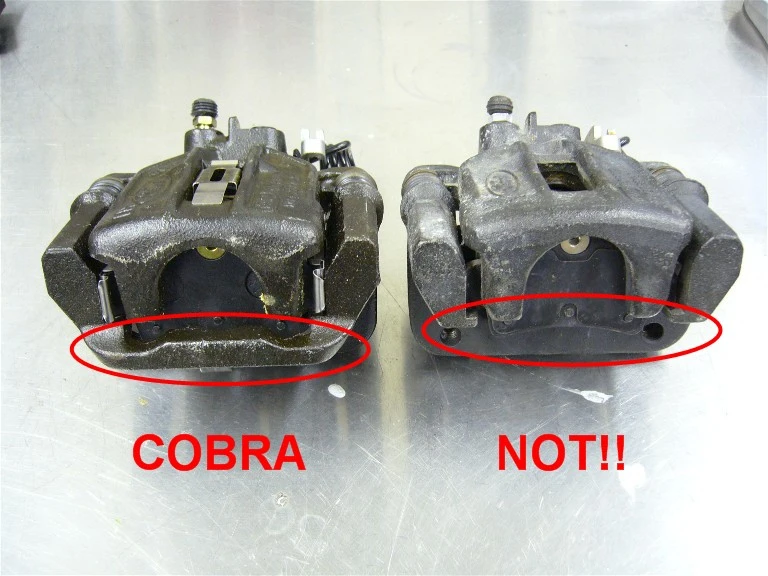

Yes and no.
The clamping portion is the same on all SN95 mustangs, but the brackets and pads are different.
The thinner pads are for the wider cobra rotor and the pad brackets are different as shown above. The cobra, mach 1 and bullitt calipers have the extra reinforcement as shown for strenght, and the groove in which the rotor fits is wider.
You can modify your GT caliper brackets with a grinder to widen it. Many have done so, others just go to ford and buy the cobra specific braces. They are $40 each.
The rear Cobra kit consists of everything you need except the calipers. You can buy the new cobra calipers, or mod your GT ones.
The M-2300-M kit can be had for under $200 from Summit, and comes with what is pictured below
There is more to just braking than the calipers. Leverage and Mass play a roll as well. The cobra rotors have more leverage and more mass so they resist fade better. I will admit, unless you are road racing or maybe even autoXing you'll never notice the different.
You will notice the difference when you put some nice open wheels on your Mustang and have a big 13" rotor up front and a puny 10" rotor out back.
