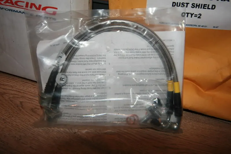

I now have:
Front Calipers
Front rotors (brembo/cobra 13 inch)
Rear Calipers
Rear rotors (Cobra 11.65 inch)
Brakepads front
Brakepads rear
Braided brake lines
Rear Wheel bearings
Rear mounting brackets.
Except the front brackets i have everything i need of ? And parking brake cables ofcourse.

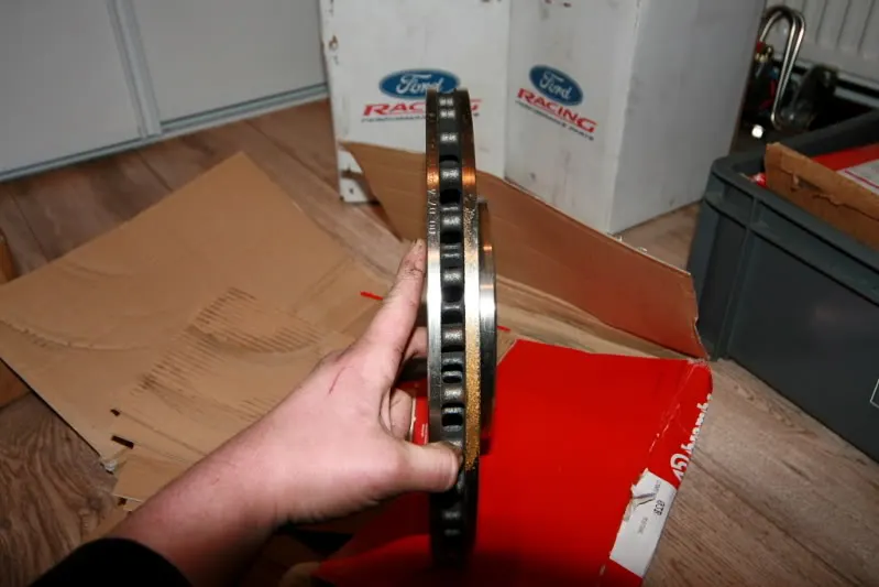

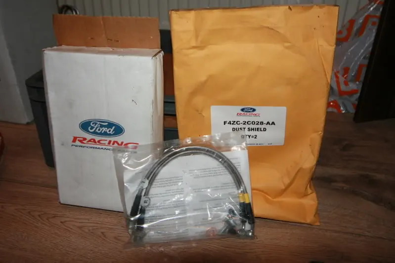

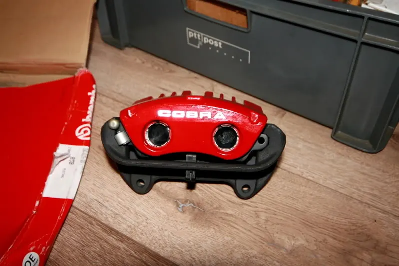

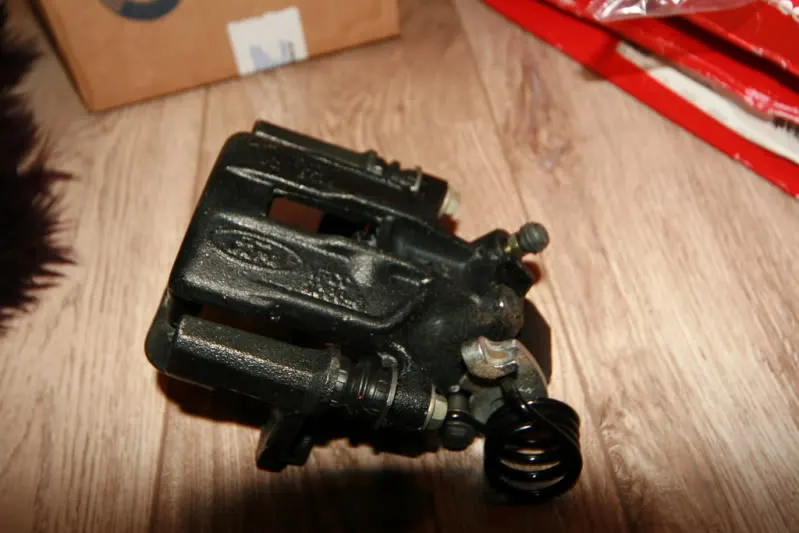

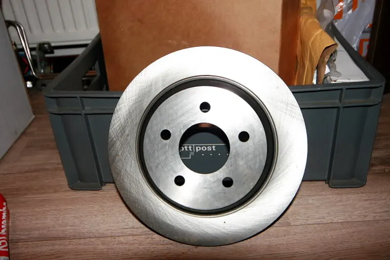

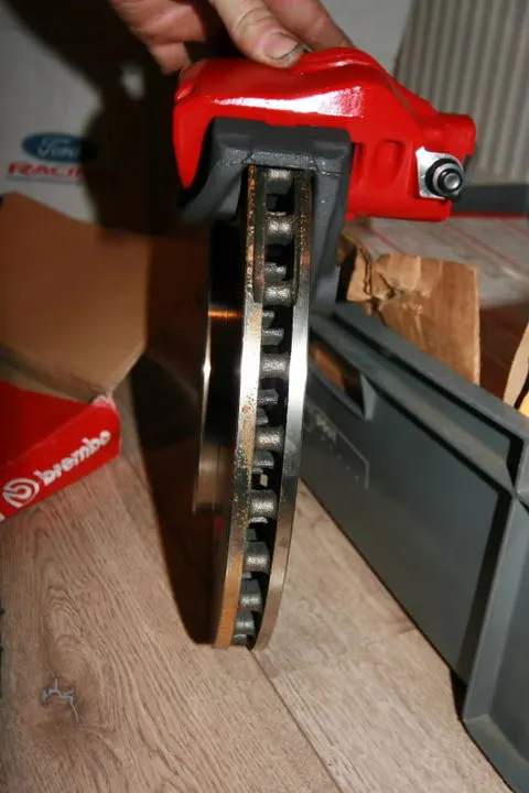

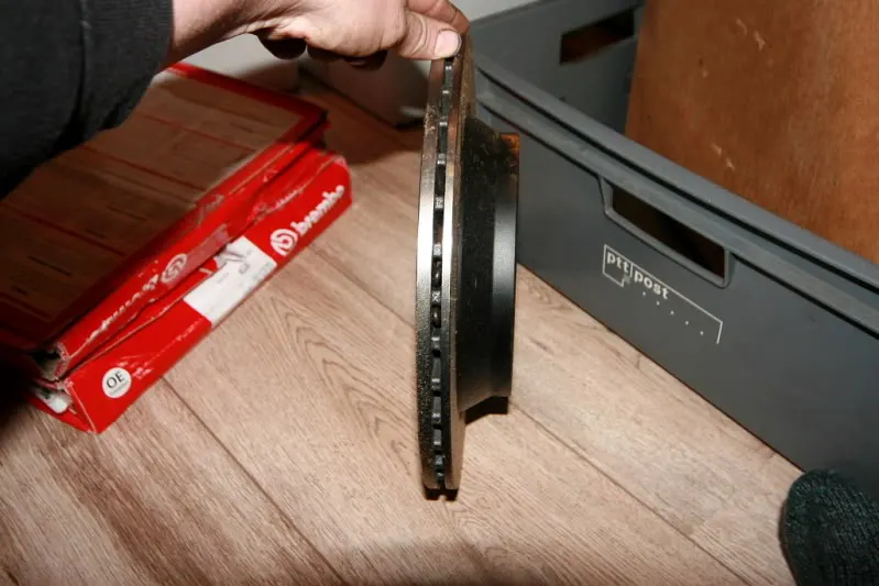

Got the brakes today !
Another pile of parts that must be mounted on the car :rolleyes:

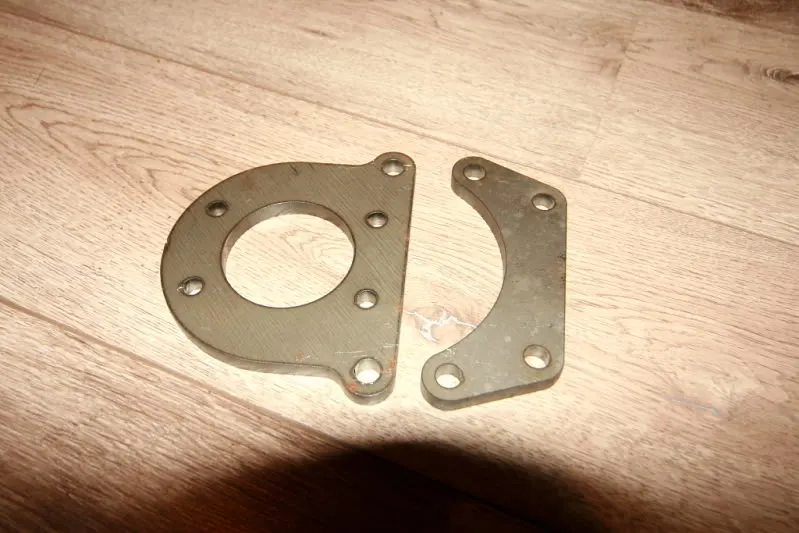

Laser cut the rear brackets, gone order the front ones at street and track (hopefully they will ship to the netherlands
Now searching for the front brackets and M/C then we can install it ! curious about the stopping power after :nice:

you will need new rear axle bearings too because the bracket will not slide through + machine a little gap around to seat the bearing into the bracket. Also what rear rotors are you going to use?
