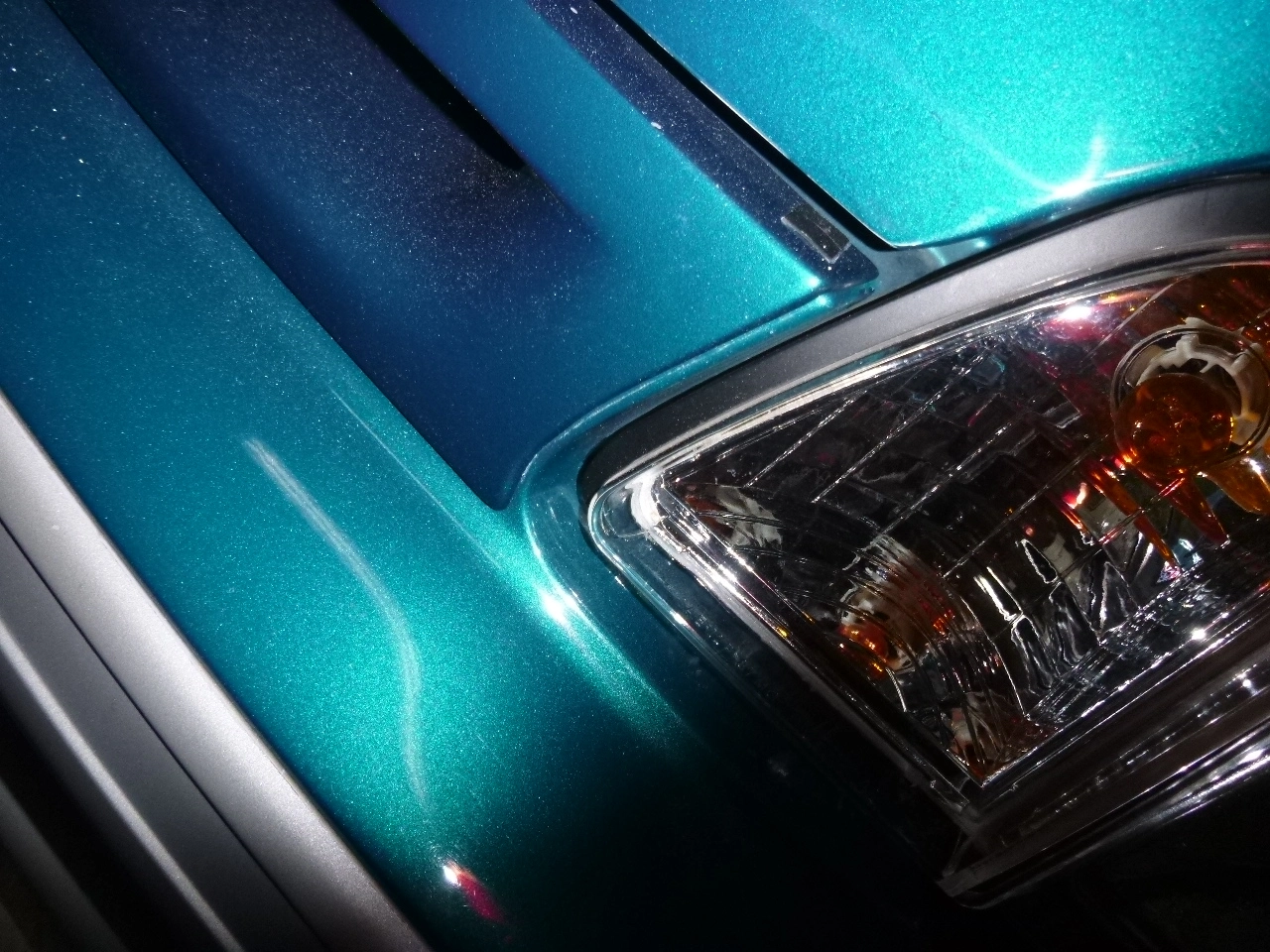

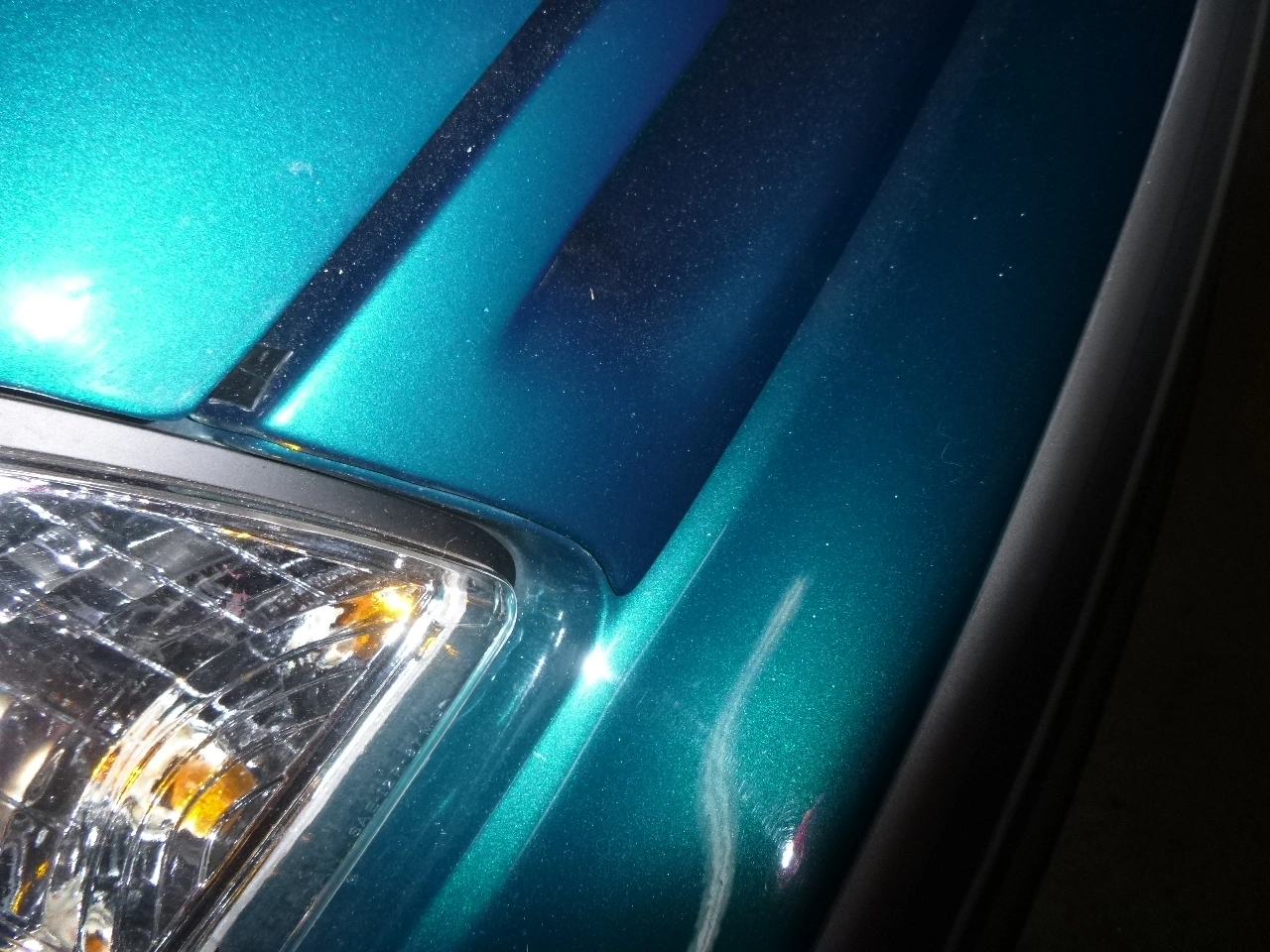

On a previous mustang i molded the sides of the emblem. The front would look bad with the bottom line molded. The factory cobra piece is not molded on. The sides by the turn signals drove me a little crazy. Didn't really fit well...so...i molded it to the gt nose with bondo hair. My insert was fiberglass.
You can see where they blended it in.

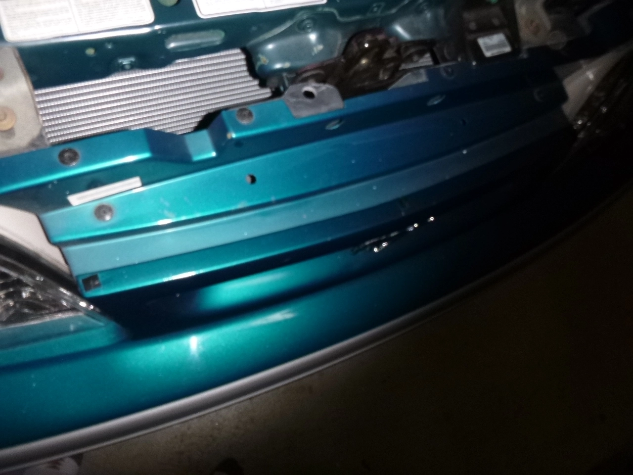

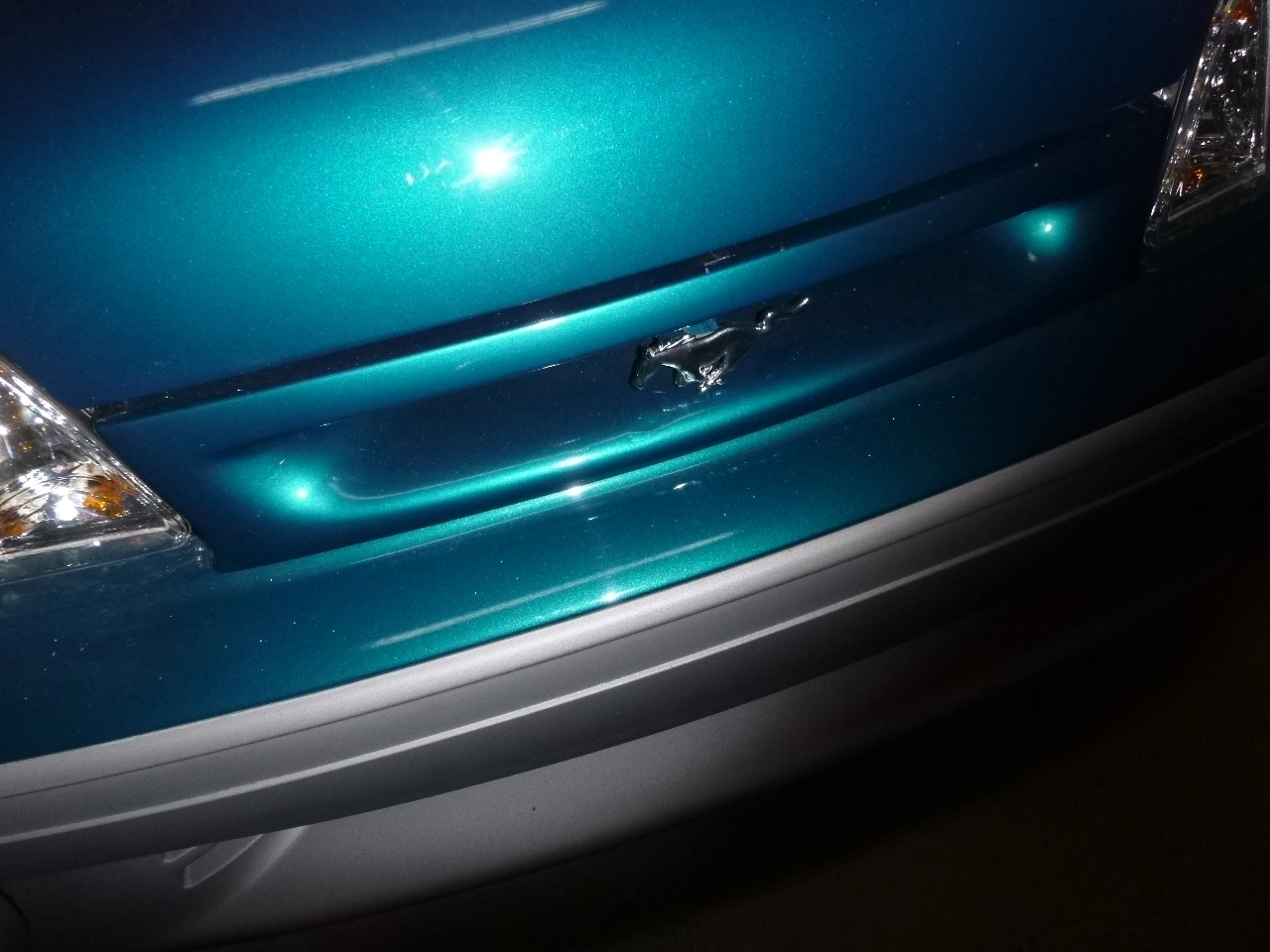

I put one on my 93GT years ago, it's not molded in just standard mounting.

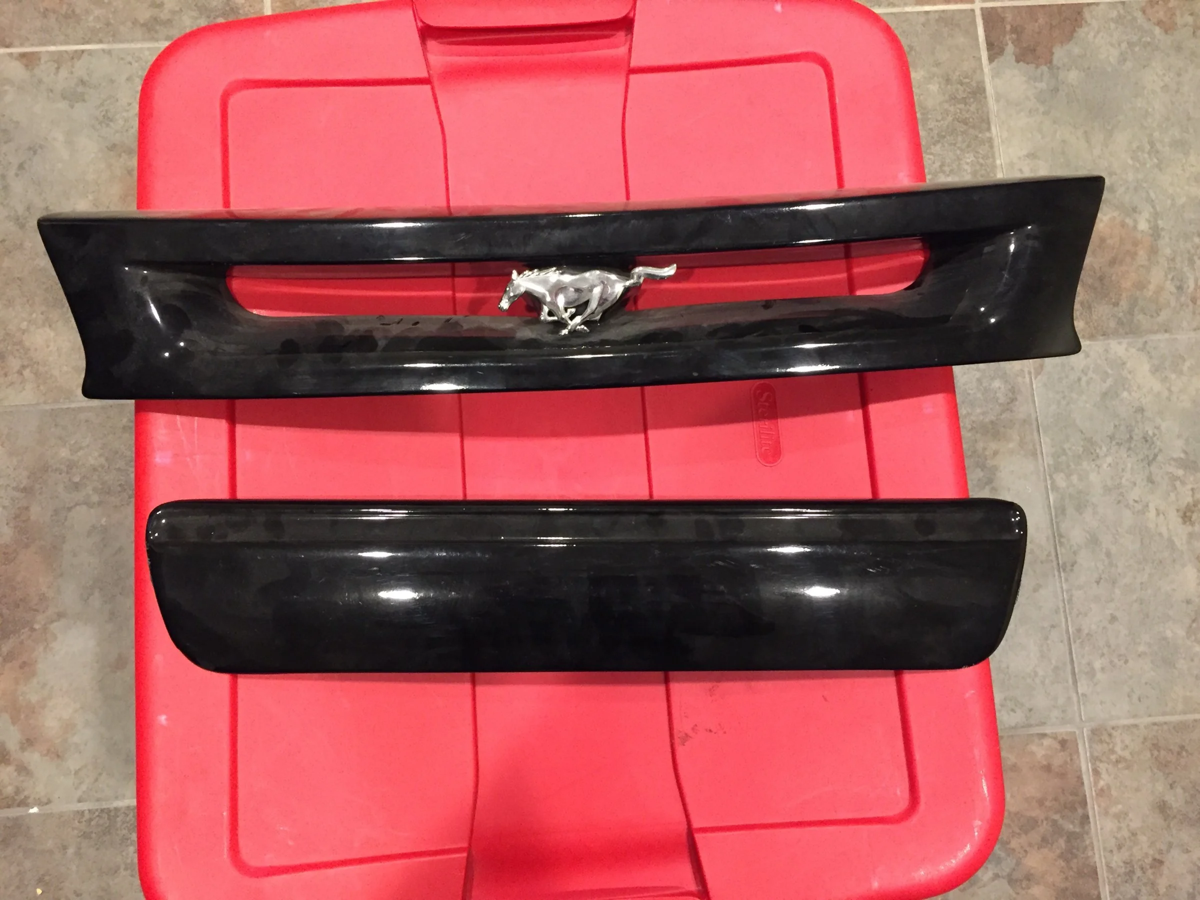

I painted these about a decade ago and haven't convinced myself to install. I probably won't do the bumper filler, but the grill stays in the back of my mind.

There really isn’t any flexible filler that would work imo. You won’t want to fill in the space between the bumper and grille with Bondo. I think the original way of mounting it is the way to go.
Thanks..l remember when I installed it there was no template supplied so I was nervous
about making the cut out too big. Took a little off at a time, something to keep in mind
when installing.
