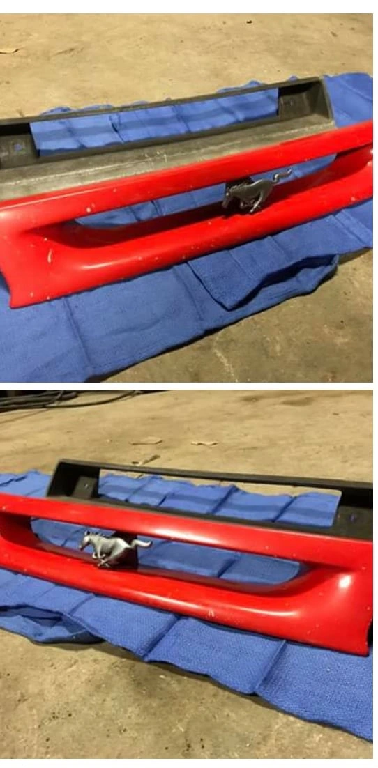

Make a template & cut with hole saw & jig saw. Very easy & provides better cooling.
Reactions: hsean
Both friends had done this to their cars. Ultimately they used Cervini's cobra insert kit and had body shop bond and finish it to look one piece. Came out good but personally prefer the insert as it is: an add on.

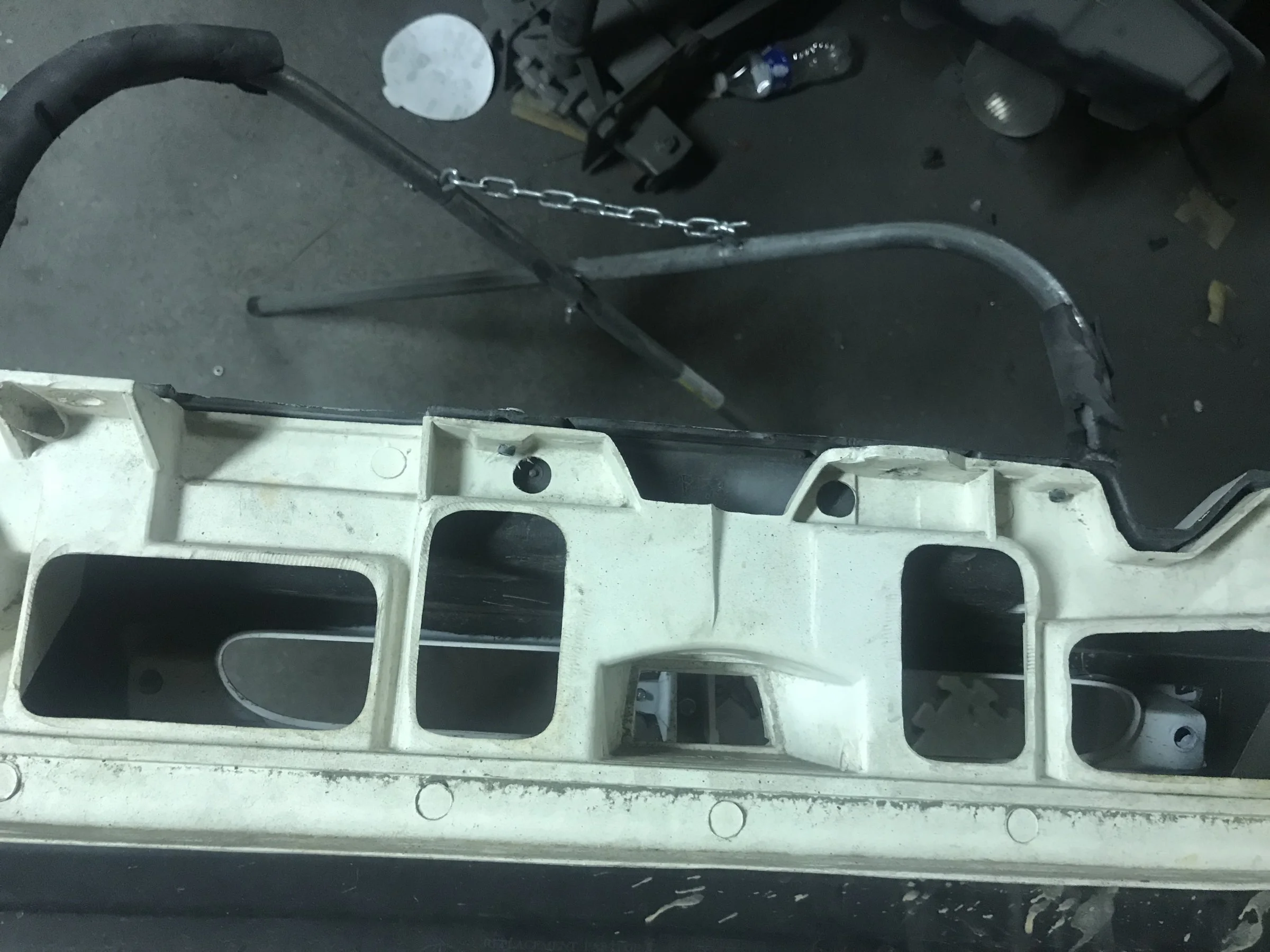

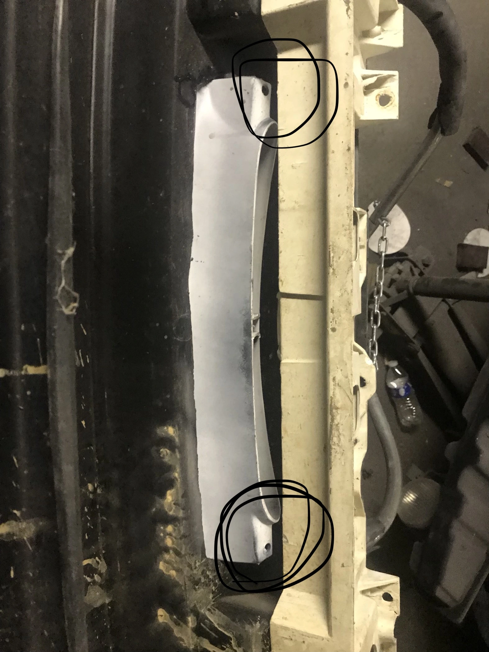

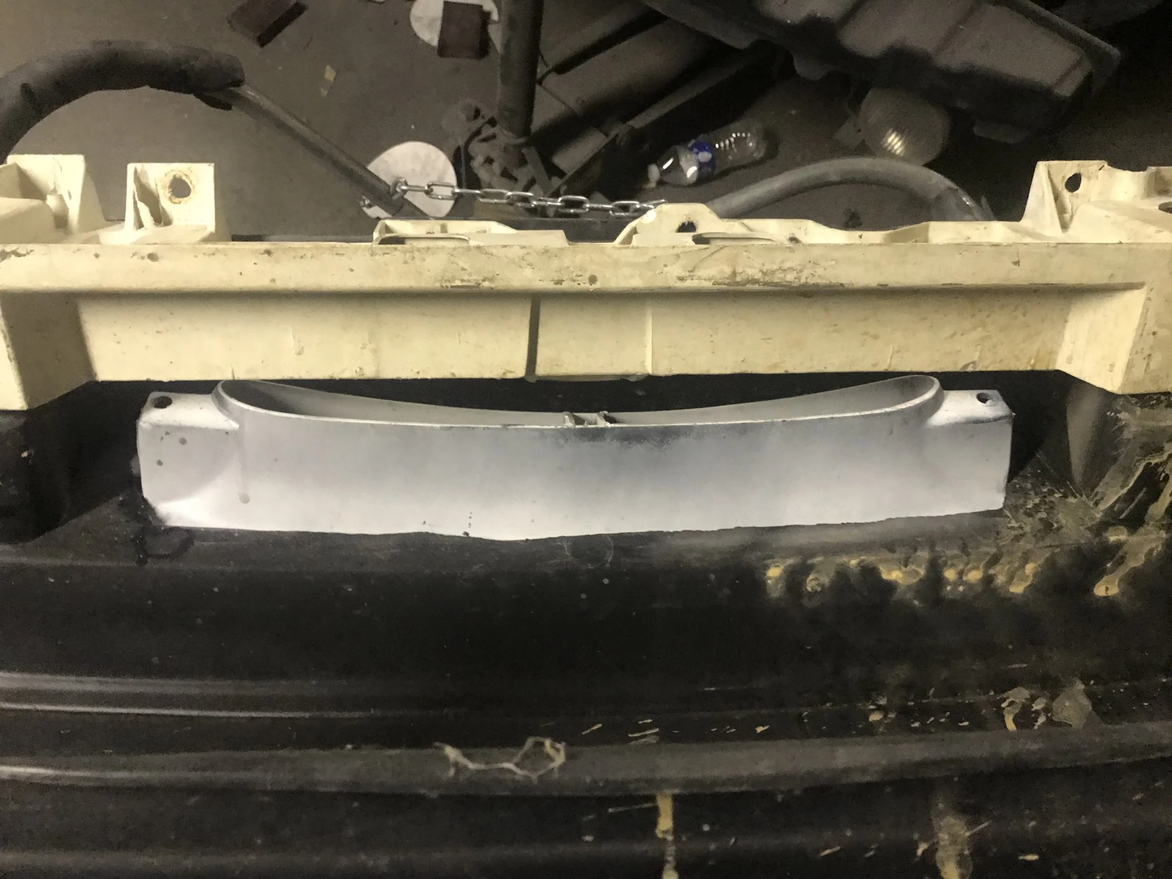

Pulled my old bumper inside, a quick look at the back with the insert makes it clear on how to make a bracket. I can get better pics if needed.
But I’d guess some long bolts and some
Spare steel would make an easy install

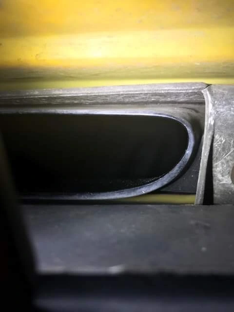

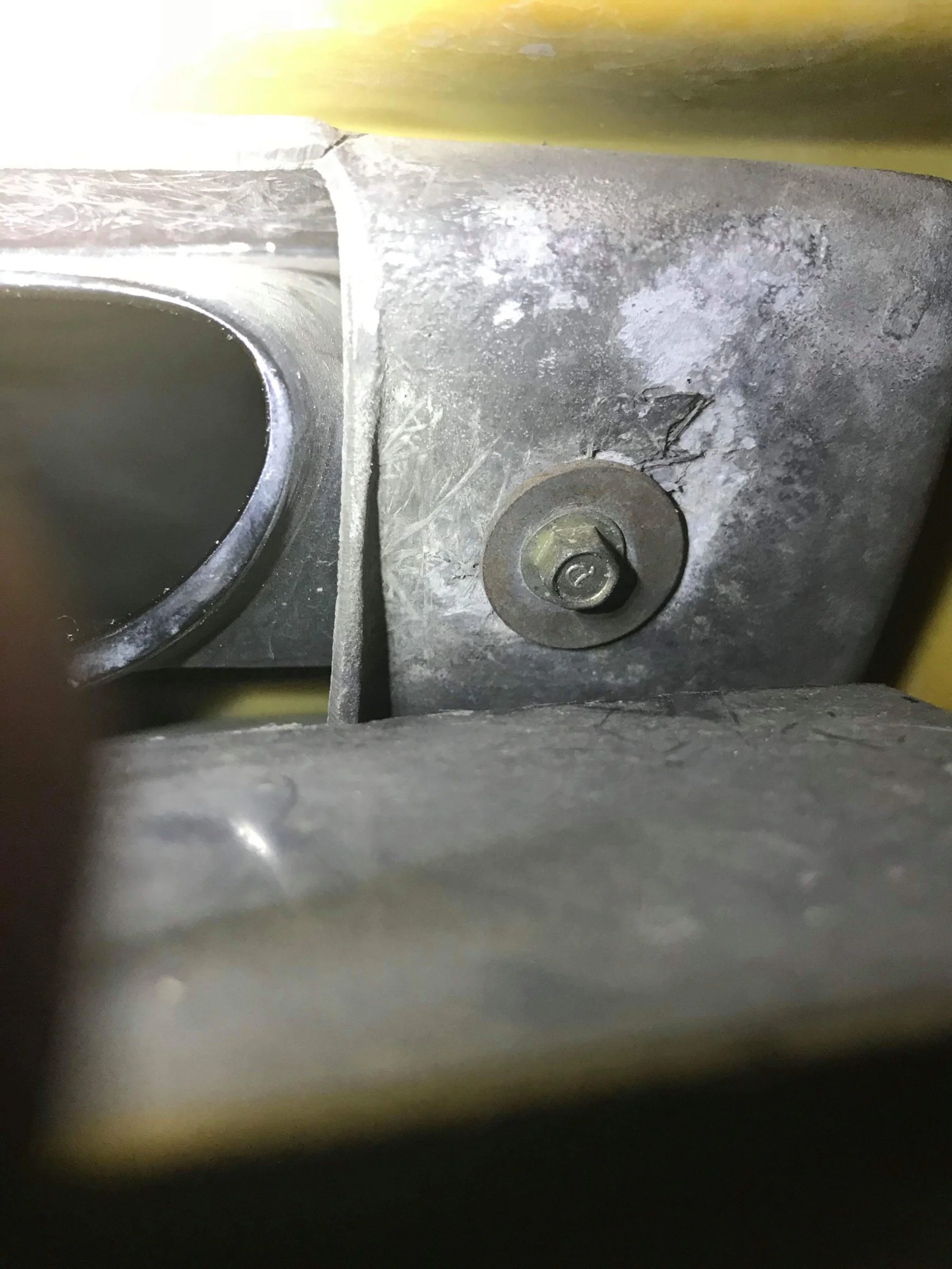

Currently talking with a guy online who has a 93 cobra. He was able to get a couple pictures to confirm that bolts in . Just not sure of the mechanics of it yet. Believes he will be pulling his bumper soon, maybe even this weekend for a repair, I will hopefully be getting really good detailed pictures

I see. Apparently they are not all the same. I like the way that one mounts.
The Cervini's one has no provision like that, so you are using double stick tape and a couple screws in the corner. I never had the warm and fuzzies about it being as secure
Reactions: Nutty 5.o
My old one had a fiberglass back piece....two studs were on the front piece. Shouldn't be hard to mock up. Mine kinda bowed out on the sides and left a weird gap. That was the only reason I blended the sides.

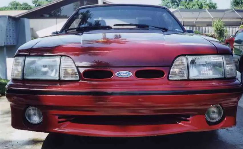

Why mess with all the problems with an insert, when you can just cut some holes or slots?
Ford didn't do it for looks, GT's had cooling issues & the Cobra would have made it worse, since it had a bit more horsepower.
There was no direct air path to the radiator, the front air dam was supposed to direct air up, into, & through it.
