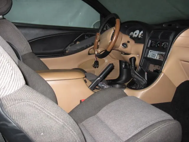

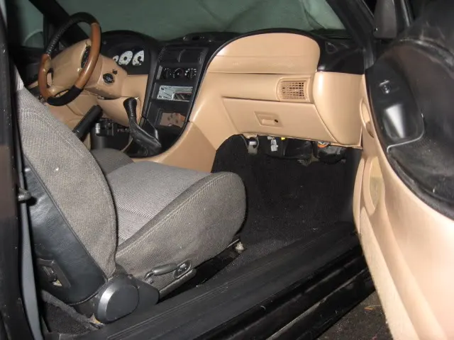

I'm also polishing up the interior some - I finished the passenger's side tonight. The color scheme is still tan & black, but more black now. I kept the doors, center console and dash as black/tan, the rest is all black. Let me know what you think.
The driver's door isn't done yet, the door panel won't line up quite right. The windows are gray because I still have the car cover on.
I'm aiming to finish the interior this weekend. Next up is flushing the coolant system.

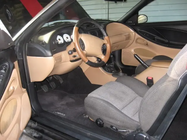

Interior Complete!
I gotta finish this project, it's SOOO close! I finally finished the reat of the interior, here's a shot from the driver's side:
I'm flushing the coolant now, hopefully it'll be done soon.
looks good:nice:
thats the style center armrest i need,i dont even smoke,no use for the ashtray.
i dont like driving around with my coffee in the flip-out cup holder i have,gets in the way when im rowing through the gears.

One thing, it looks like the airbag on the passenger side still has some space between it and the dash, are you gonna try to get it flatter? I'm really anal about things I can see while driving and that would drive me crazy!!
Nice work man! It's always a good feeling when you get your project running.
Never noticed a gap, but I bet I will now - thanks SO much. :p I might leave it, the heat here in Southern California tends to make vinyl sag and fill gaps like that.

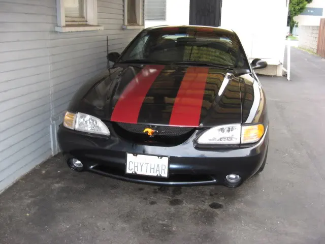

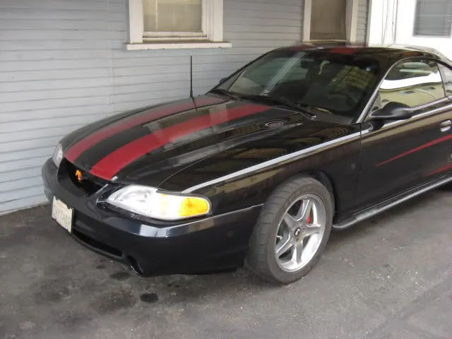

And finally, the project comes to a close.
The only thing left in the Cobra conversion was the Cobra front bumper and the Cobra fog lights. Those I took care of this afternoon. I need to wax the bumper up to get the shine up, but that's not part of the "conversion". Photos:
Part of me can't really believe it, but I'm actually done. A few stats for those of you who care:
