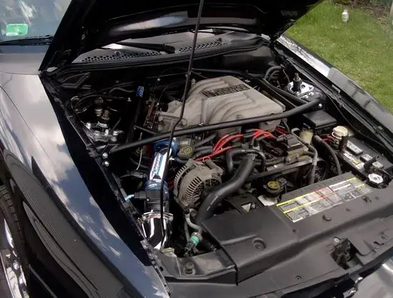

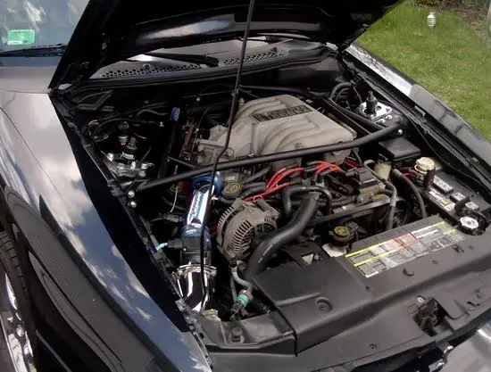

I have a cobra clone with a 5.0 gt engine. The car has 4.10 gears, o/r h pipe, flowmaster 2.5in exhaust, ford motorsport shorty headers, bbk cold air intake, and an aluminum driveshaft. The car is a five speed. I found a used cobra intake for a 94-95 for sale that a guy is selling because he bought a trickflow intake. Would this be a good next mod for me? If so would there be anyway to see if this is a reproduction or not? And does it matter if its a reproduction or do they both perform the same?

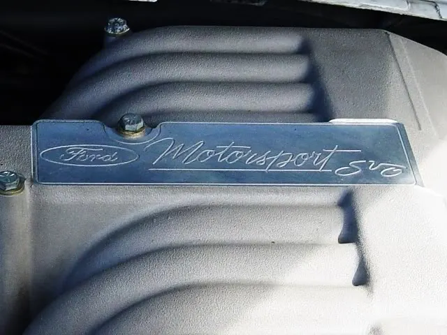

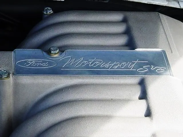

Don't think anyone but Ford made a Cobra intake. An intake from a real 5.0 Cobra will have a plate on the upper intake that says "5.0 COBRA". Now if it is one bought from FRPP directly then the plate on the upper intake says "SVO Motorsports" but is identical in build to the Cobra intakes that came on them stock Cobra Mustangs.
The original Cobra intakes that came on the 94-95 Cobras have the words "5.0 Liter Cobra" and a snake on the intake. When you say repoduction, I am thinking you mean ones Ford still made, except they say "Ford Motorsport" on them and were available for purchase at any motorsport dealer. If you want the official Cobra intake for your Cobra clone, you need to get the one that I described first with the snake. Other than the name plate, there were not other differences.
