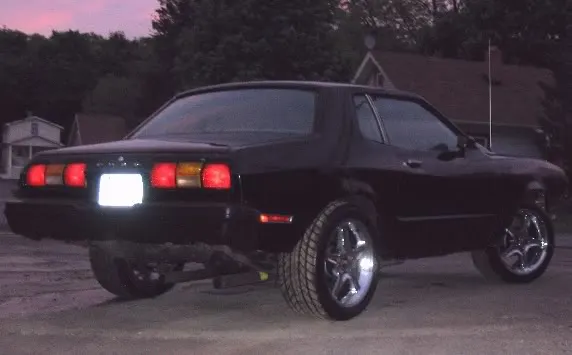

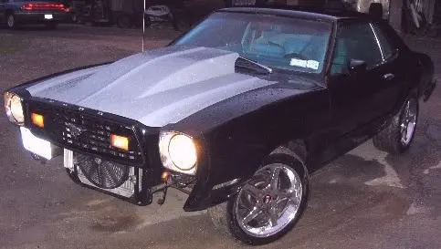

Do you mean these 17" wheels?

Blue Thunder,
Holy Geeze! Your car looks great!

Great job! And I like the cowl hood too.
yes, those are the one's that i mean. the only difference is that i will be retaining the 4 lug pattern. jeffnoel did you use any type of wheel spacers with yours? it looks like blue thunder has used some type of adapter on his wheels. blue thunder what size tires are you using? the other type of mod that i would like to is to radius the wheel wells, there just to small of a diameter for me, also my car has the lowering blocks from racerwalsh and cut springs up front and the same style hood as blue thunder.:nice:
Yes, I used spacers and the 3" long race wheel studs to backspace the 17s correctly. I also narrowed my upper control arms for clearance to increase steering travel. (It will turn tighter now than it did with the stock wheels and uppers)
The tires on the front are 245/45zr17s, and the back are 275/40zr17s.
If you check out my car domain link in my sig, you can see how I made the wheels fit.
