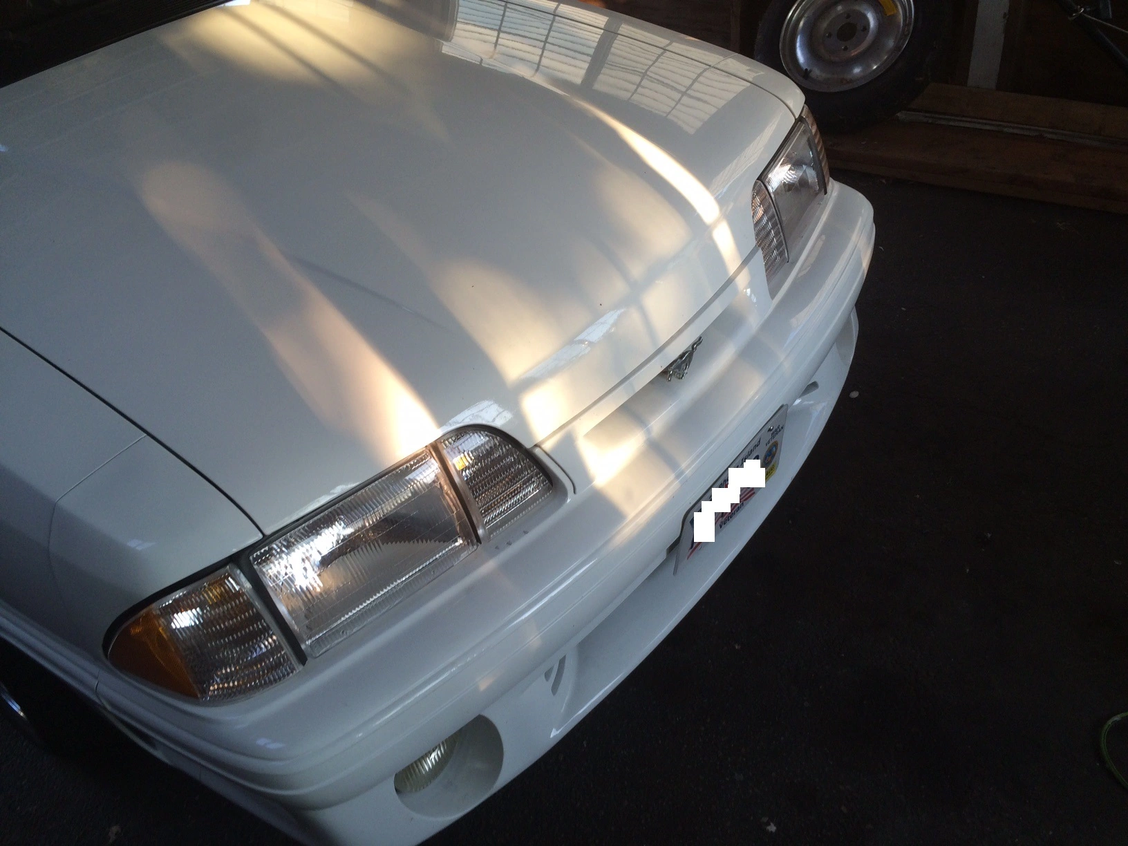

It looks so much better, couldn't be happier, what a difference they make.

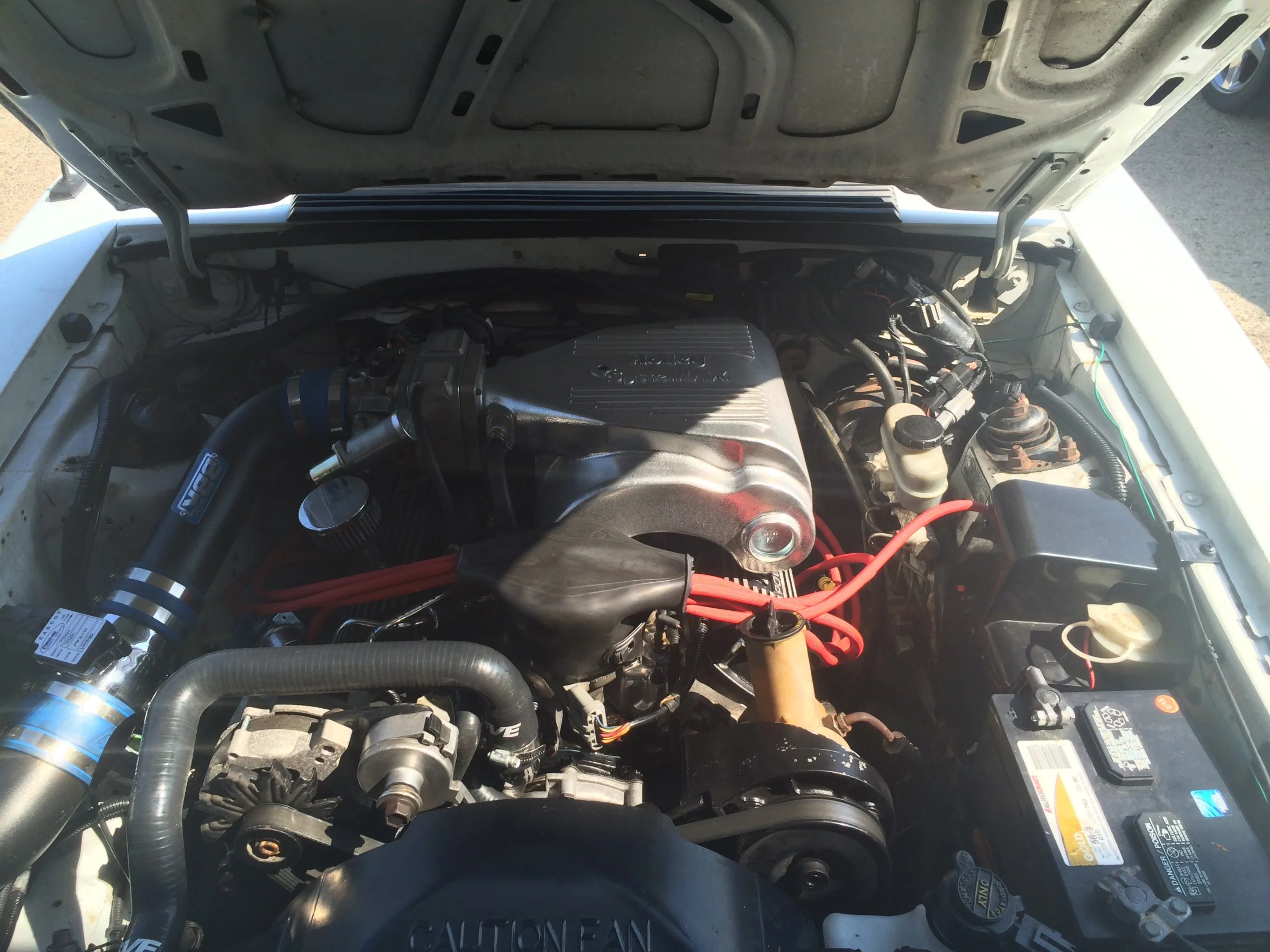

I decided to wash the engine bay yesterday, and used purple power as you guys suggested. It worked so well that it stripped the paint off the intake manifold and crank pulley. The manifold was painted by me after my poor attempt at polishing so I'm not really too concerned. Learned a lesson about the proper prep work, though. The intake will be coming out next week and swapped with the systemax II that's on the way from summit.
Reactions: 95BlueStallion

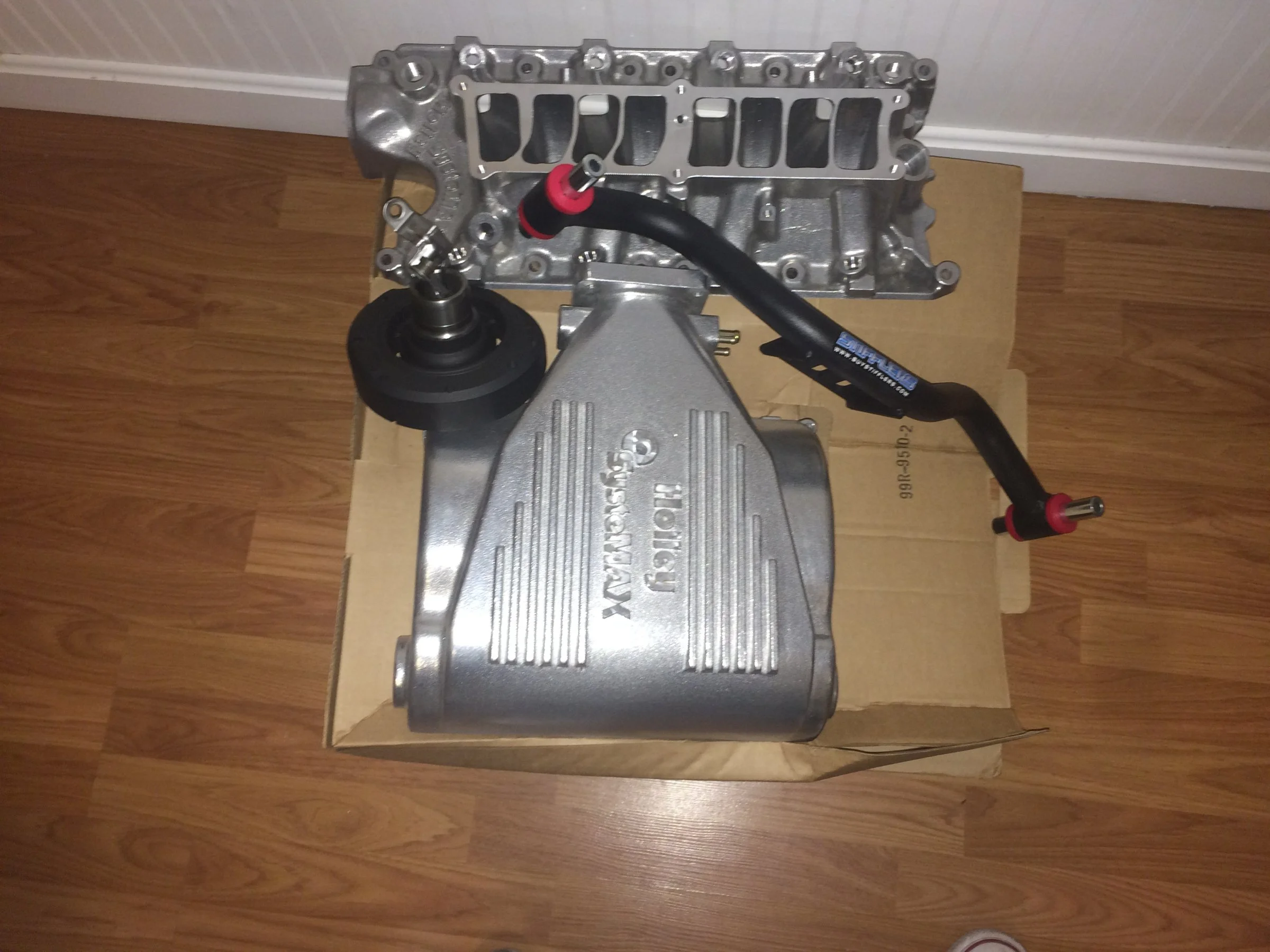

Brown truck came today, I cant wait for tomorrow for all of this stuff to go in. I decided to go with the 75 MM PRO M bullet style MAF that would work with my existing CAI instead of buying the power pipe, as I believe mikestang63 suggested. I couldn't justify the power pipe for the cost and due to the fact that I probably would not see any gains on my mild combo. I was having some drivability issues with the C&L and wanted to update for piece of mind. I did get to swap in the PRO M tonight and it would not idle at first. I took it for a ride and afterward it idled fine. Acceleration was noticeably smoother and I am quite pleased.

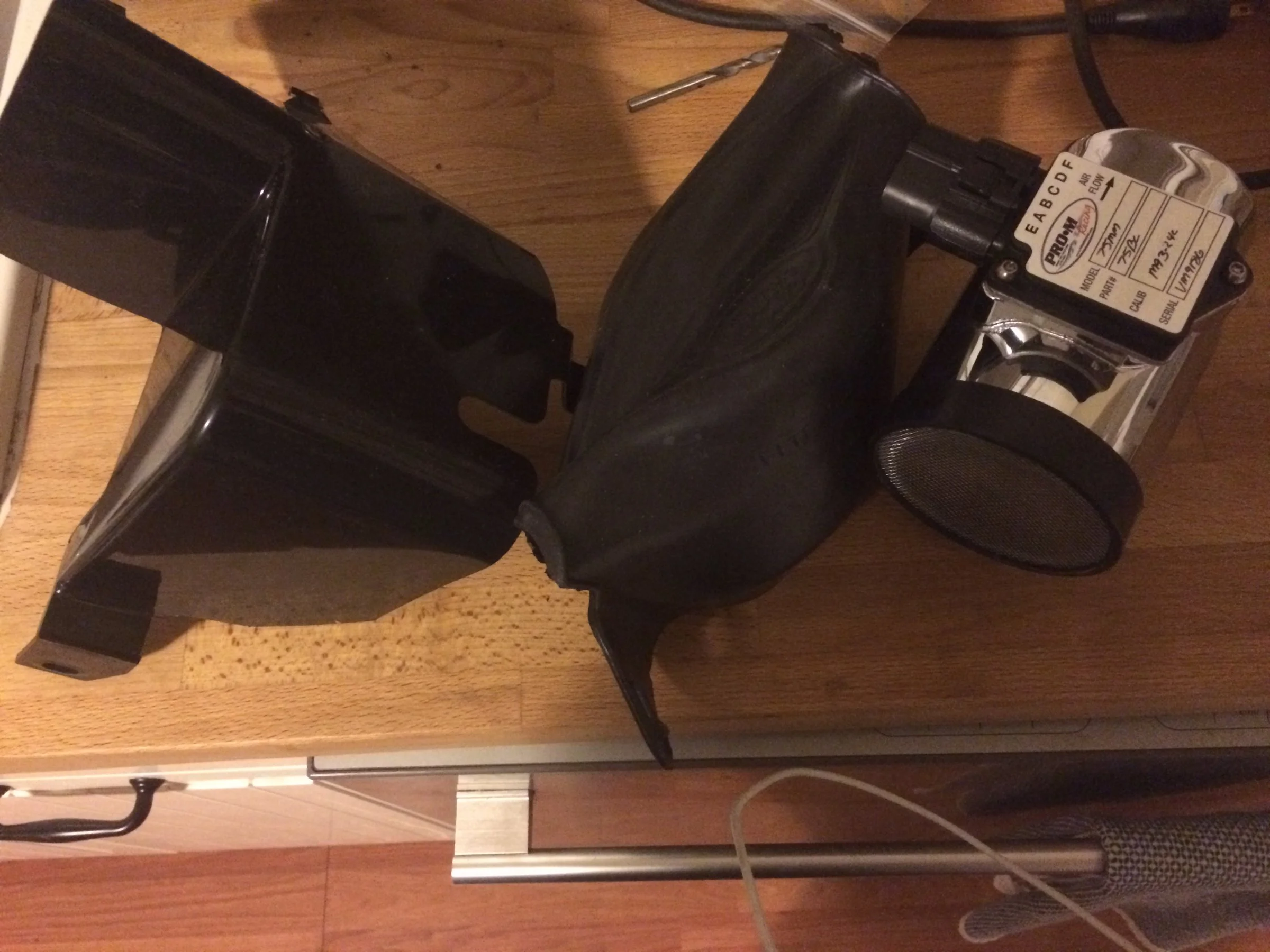

Well it's done and here are the results, cobra vs systemax on same engine. With cobra it made 271/311 with systemax 286/307. Not often you get a real side by side comparison. I think there was a little more on the table as the temperatures were near 100* yesterday. I haven't looked at the graph yet to see how the curves compare, but I guess the real test will be when I pick it up Monday and drive it. Sorry for the crappy pic btw.
Reactions: nickpic, Davedacarpainter, A5literMan and 2 others

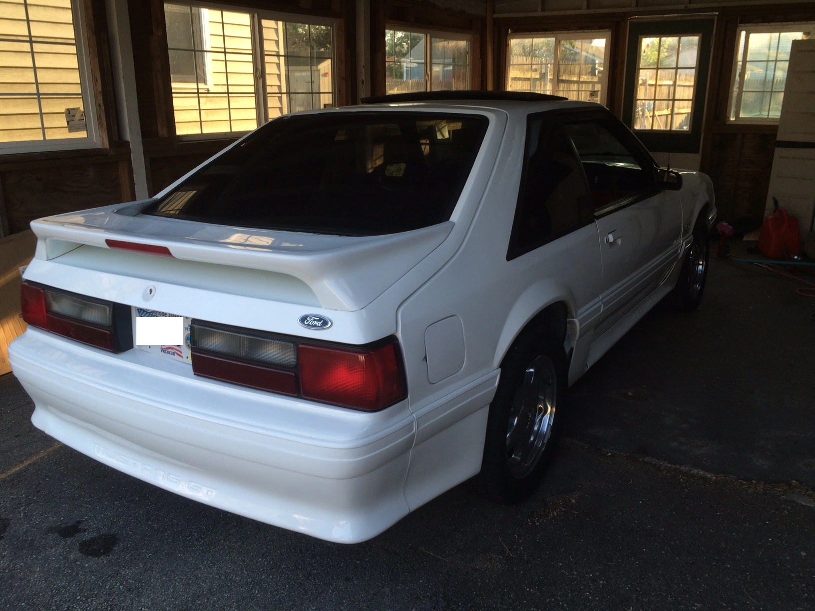

I love me a clean white GT
awesome.
Reactions: Revogen and deathb4dismount
awesome.
Thanks. I think it's the only car that actually looks good with the red interior. Just looks right for whatever reason. I have been debating on changing it to black with some Mach 1 style seats but the interior is really clean. Only thing I need to fix inside is the gangster lean on the drivers seat. Other than that just needs a new stereo.
Thanks for that comparison which is a decent improvement. What did you do with the Cobra intake? Besides dyno numbers how is the overall before & after engne build seat of the pants results?
Cleaning the Cobra up and selling it on Craigslist. I sold the CL meter already. People aren't too interested in the cheese graters I posted for some reason
