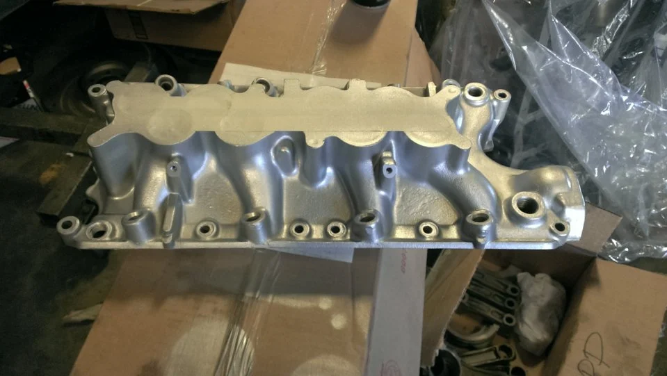

To start off I hit it with a wire brush attatched to the drill. Then I hand jammed it with sand paper dry then then wet. After that I used polishing disc and ball that comes with head light resot kit. That picture sucks, it was taken in a garage with no light at like 930. The part that I tested on has a mirror shine, it looks awesome.

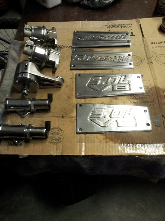

I use a 7" buffing/grinding wheel, drill, dremel. a DA sander and sanding blocks. Bought them all at Harbor Freight years ago. For larger parts I start off with paint stripper to get all of the paint and grime off. Then I use a 60m 100, 220, 440, 600, 1000, then 1500 grit sandpaper. Then I do a red, white, and jeweler rouge on a buffer. I am rather anal so you may not need to do as many steps. Do not move on to the next step until you are satisfied with the results in that stage.
Here's some parts I did a few months back

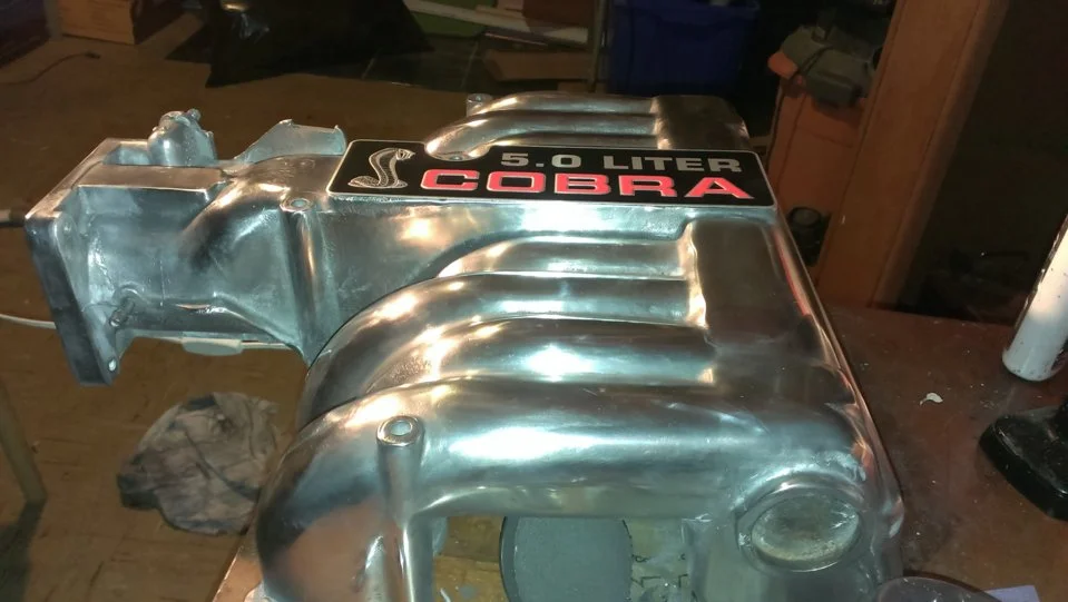

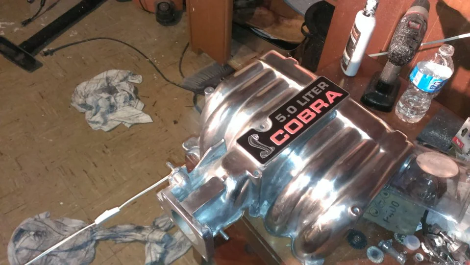

Well my first attempt at polishing came out, well pretty crappy. The intake was so pitted I would have had to start at a 40 grit to get everything even. At least the cobra plaque makes it look a little better.
The bad news is I have run out of time to work on it more. But the good news is my engine will be ready on Friday. More to come.
It doesn't look bad in the pictures, but there has been more than one time when I had to start over from 60 grit. I attribute my times to being impatient. You need to make sure all of the pitting are out before going on to the next grit in sanding.
If you don't have one, go to Harbor Freight and pick up a cheap 7" buffing wheel and some red, green, and white buffing compounds. The red will cut fairly aggressive and may remove some of the pitting. Make sure you wear protective eyewear, an apron as the compound flies everywhere, and thick gloves as the pieces get hot. Get different wheels for each compound. I used a thicker wheel for the red and green and then a flapper thin wheel for the white final polishing rouge.

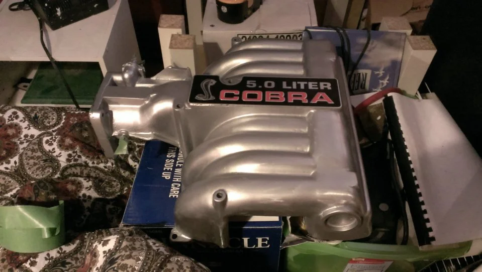

Well I decided to pull the pin on the polishing. Since the engine still isn't done, I figured I would try to go at it again. I hit it with 40 grit and I still could not get some of the rough spots out. There were some pits in it that were almost like 1/8 inch deep. The casting is just so rough, the quality control on these Chinese jobs are terrible.

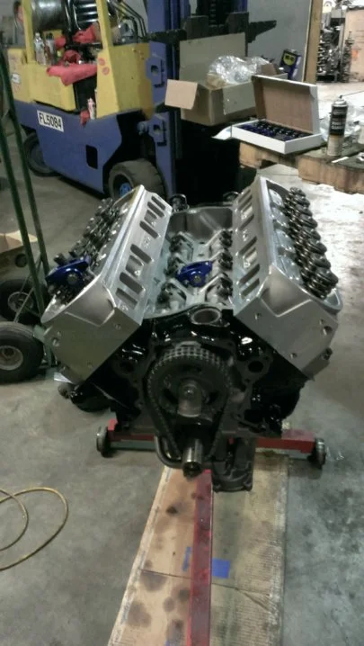

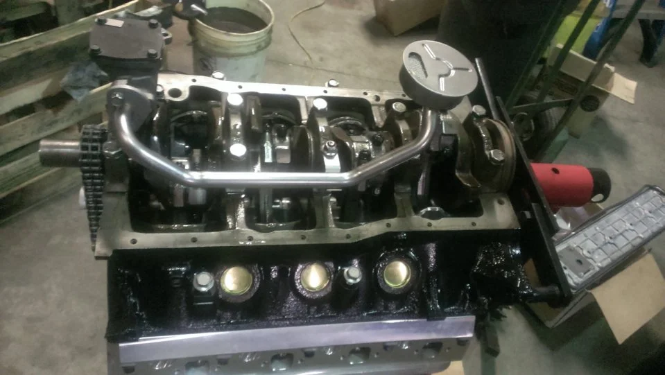

When I checked out the motor yesterday at the shop I noticed they had painted the lower with high heat aluminum. It looked great so I decided to paint the upper to match.
Only thing it's missing is the right length pushrods. It's the only thing I didn't provide. I new I would probably need longer ones but obviously couldn't measure. They are on order from summit now. I will be back Wednesday to pick up a completed engine hopefully
Who measured the push rod length for you?
