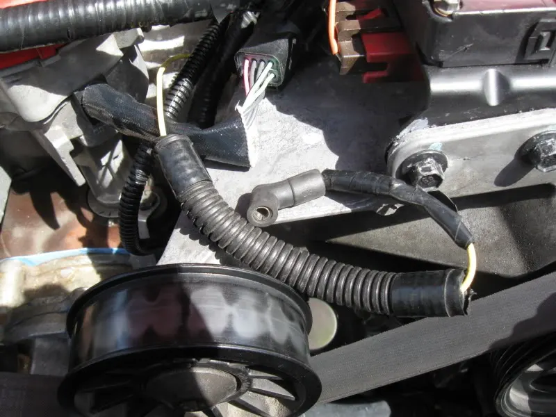

anyone know what this connector goes to and if it is of importance? I just found it laying on the lower intake.
Yes, that is the wire to the oil gauge. Down in that same area is another connector. Its black and about 1" in diameter. Try reconnecting it. Whoever installed your new oil gauge may have unplugged it to install the new sender and not reconnected it very well.
Edit: It's a pain in the @$$ to get to but worth a try.
