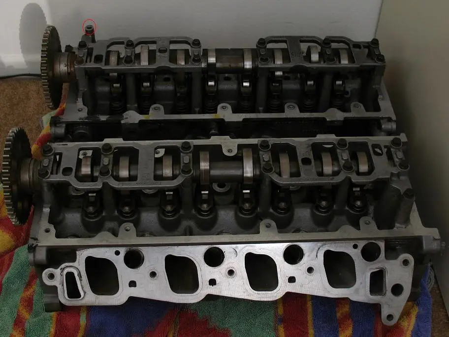

Picked up some 2001 PI heads n' cams today from a guy who bought them to put in his 96 but ended up buying a mach 1. Was a local purchase so no shipping, and i pretty much stole em away for the price he charged. Rather low millage on em too. (these turned out to have too much problems, bought a re-machined new set from Allied Motor Parts - 1 year warranty).

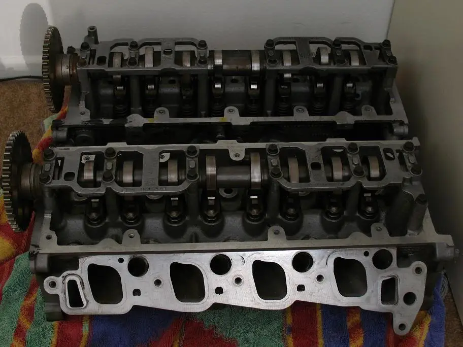

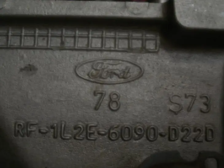

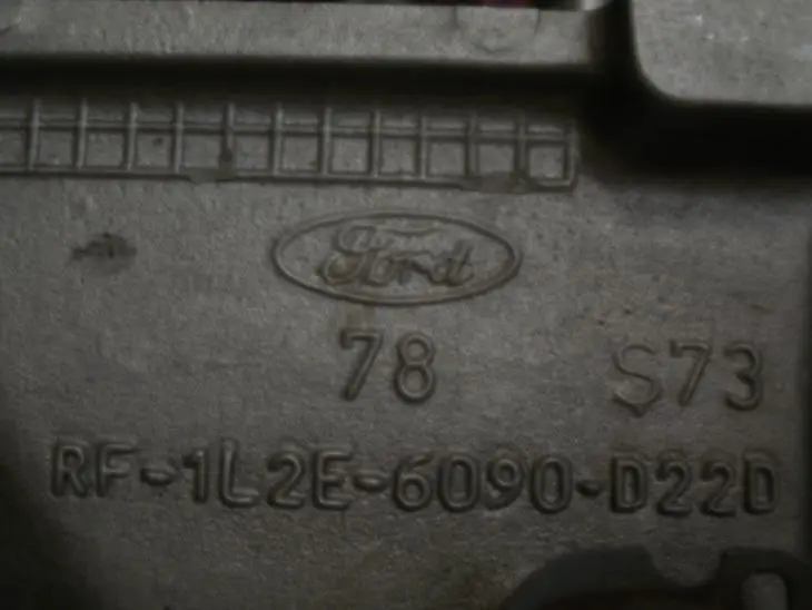

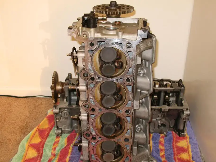

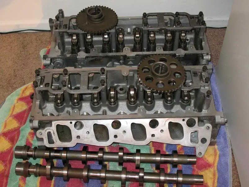

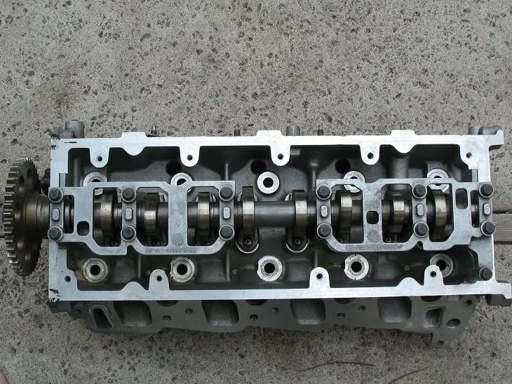

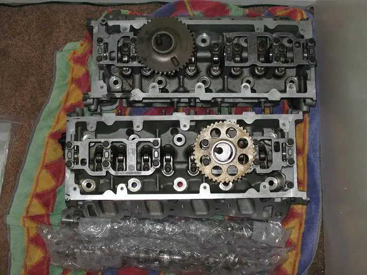

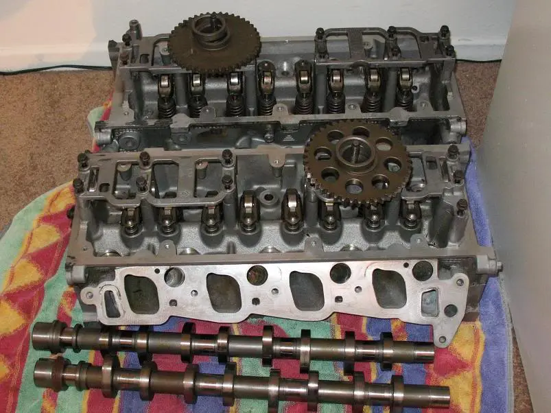

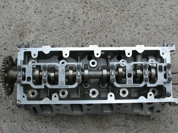

Pics of (old) heads+cams. (second pic's pink areas are just a reflection):
Good find chris....Its gonna wake that car up tremendously.....Already started the work too.....u move fast....Good luck

i called Total performance about hot tanking my Heads and intake manifold. And the guy there recommended taking of the lifter/rocker arm w/ bearings off cuz you dont want water in those very long. Then he'd wash those w/ solvent separate. Is this not fun to do? I mean it looks simple to take them off once the tower/cam is off, but who about re-installation? Hard? The springs will stay stationary on head once i take off the rocker arms correct?
Update: Don at MPH said Tim's finishing up the tune tmw and should be sending it out tmw as well. The intake manifold i bought should be here tmw (guy stalled for 2 weeks sending it). So i still haven't hot tanked my parts. Cams have been off the head for a week, thought i sold em - guy was supposed to send me a paypal, but never got back to me - proly found a better deal. Also my GF who lives in long beach finally figured out what was under the towel, cat's outta the bag:rlaugh:

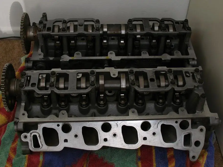

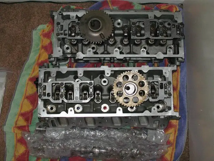

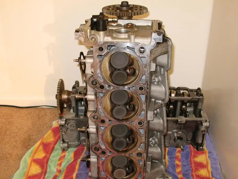

all ready to go:(
