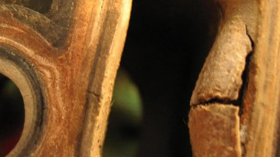

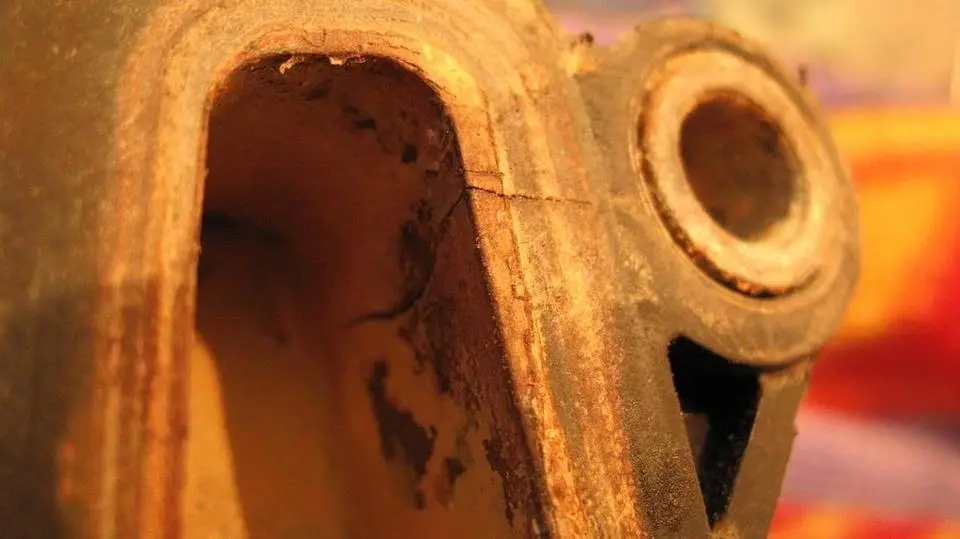

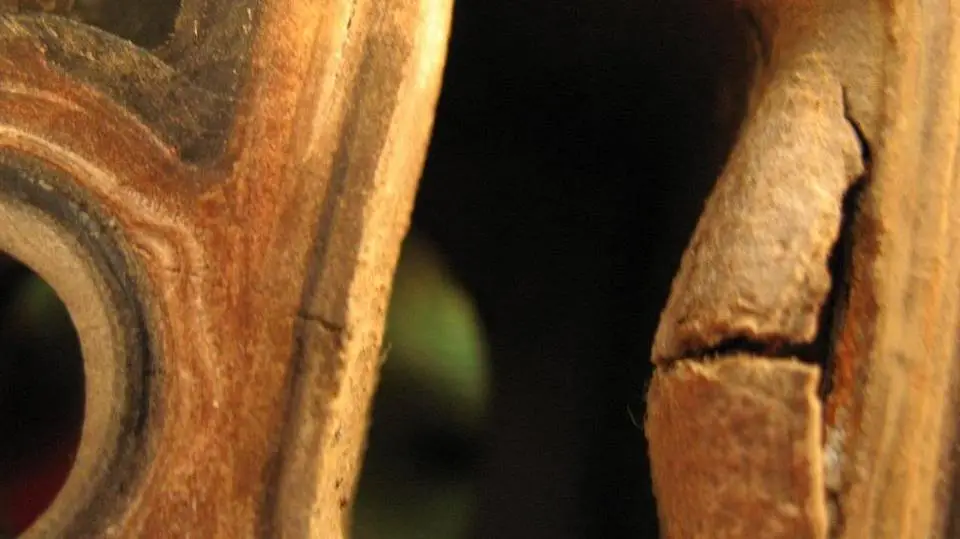

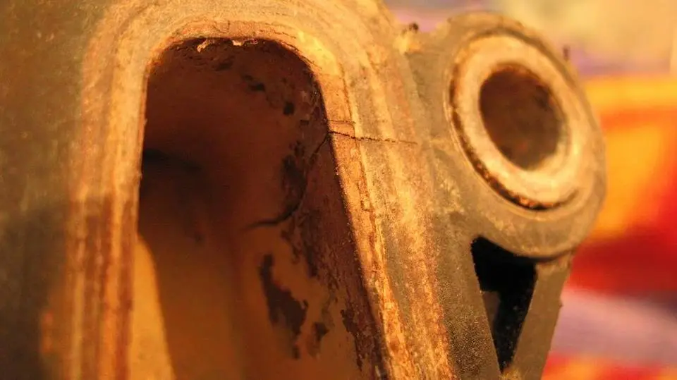

Well, i got an update, but it's not too good. I got the intake manifold today, took it along with my heads to Total Performance to have them hot tanked/cleaned. The intake manifold he pointed out is cracked in two places, the first not bad, but the other obviously leaked onto the bolt hole while on car shown by the corrosion.
Furthermore, i was in formed (don't know why i wasn't told over the phone) that to hot tank heads the valves,springs,retainers, and most importantley seals need to be off - otherwise it will be oiless after being cleaned. SO, i have to disassemble the heads before cleaning. And since it will be apart im having him grind new seats and check the valves for any imperfections.
Since the reason i haven't bought new spring for the VT cams has been not wanting to disassemble the heads, it looks like now im looking at new springs too:rlaugh: AND i'll need new seals after the valves are taken out.

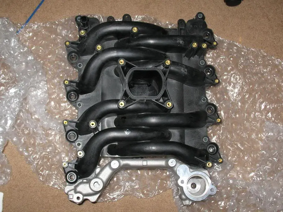

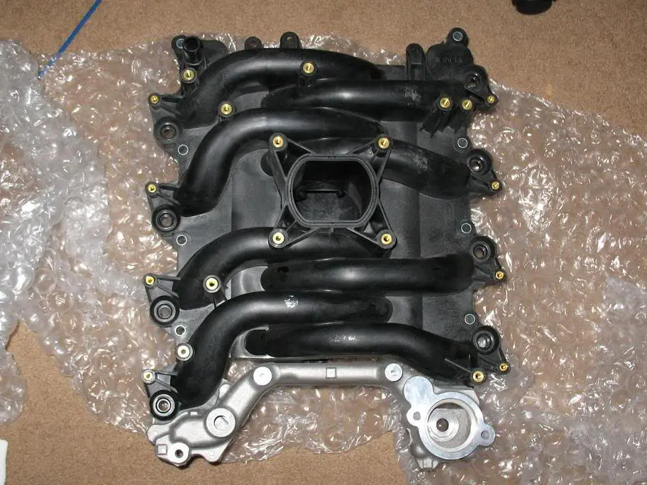

the good: got the NEW pi intake manifold all shinny and smelling like new with no cracks, yay. Has anyone tried to polish the aluminum corssover?
