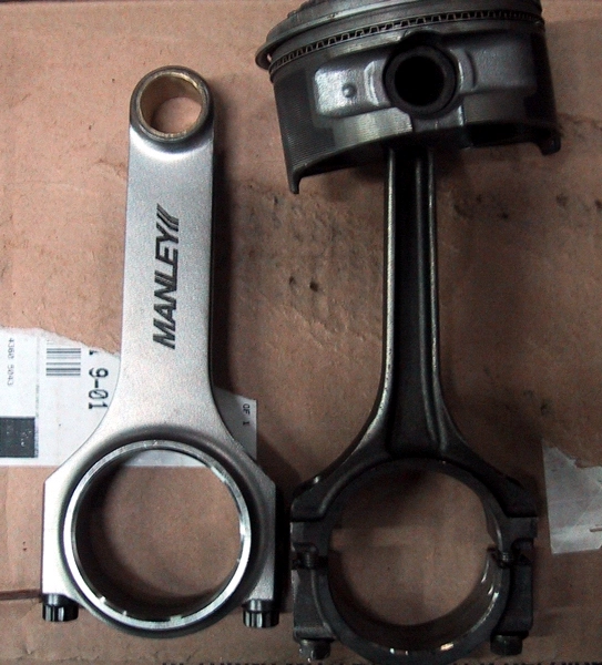

Below, you can see the difference between a stock rod and a forged one...
