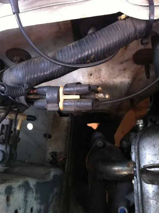

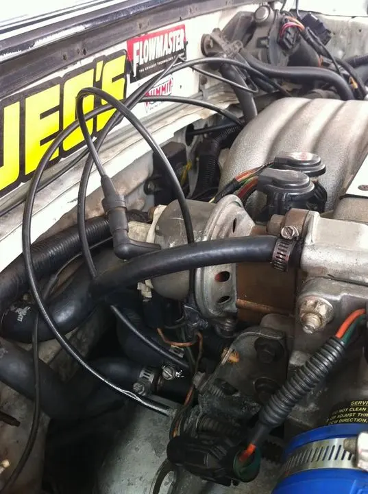

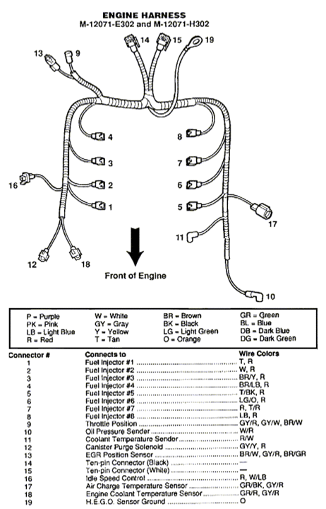

ok I looked at the diagram but not quite sure what I'm looking at most of the time hehehe... so I'm resorting to an even more basic form of asking for help.... pictures!
I was hoping someone could help tell me where these belong.
first is the vacuum hose coming out of the EGR, the one pictured with the 90 degree boot.
I know it goes on here somewhere, but where? looks like stuff has been cut off.
that might be causing my EGR error code, right?

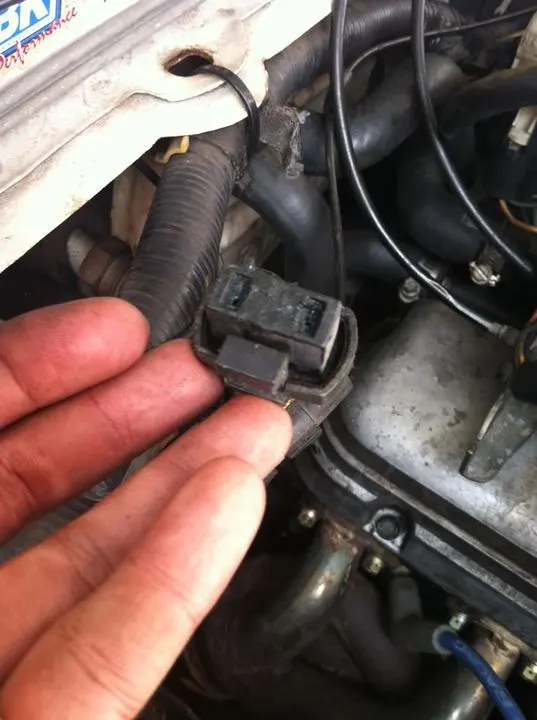

also I found this random connector... no idea. on passenger side.
one more thing, I know it's a lot...
can anyone post a picture of where the gauge sender cable comes from for the oil sensor next to the oil filter? thanks a lot!

Something looks wrong with that vac lines.
I'll see if i have some pics later. Unfortunately, i'm heading on vacation, so i might not get to it.

It amazes me that the previous owner did this to you. Seemingly intelligent people ripping up stuff when they don't know what it is or what it does. I guess we should all be thankful that the cannot open up their heads and fiddle around with what is inside it....
The connector in your hand is the low pressure cutout switch for the A/C. It shuts down the compressor when the refrigerant pressure drops down because there is no refrigerant to carry oil to the compressor.
Oil pressure sender wiring - see item #10 on the following diagram.

thanks jrichker, that engine harness diagram is exactly what I need for the oil sensor thing. however, the rest of the diagrams are gonna take a lot of reading and rereading for me to understand and identify each part in my engine bay. I'm dumb like that. X_x
