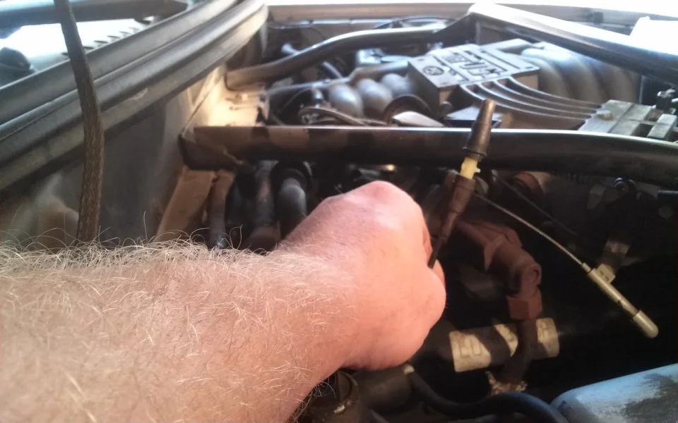

Is this important?

Might be. Where does it go at the other end of the tubing? Looks like it's been capped off.

It goes through the firewall from the engine bay. Where it originates, i havent the foggiest. Cant tell if its been shortened. Im gonna check the window washer fluid tomorrow. As thin as it is, it cant be doing much. Will do some more investigation tomorrow.

The other end is probably connected to the HVAC control. Do you get hot and/or cold air from the vents?

That line is probably the one that provides vacuum to the HVAC controls behind the dash. Do you only get air through the defroster vents? That line should lead across the firewall to the vacuum tree on the driver's fender, right next tothe brake booster. It's the small connector, third from the top.
