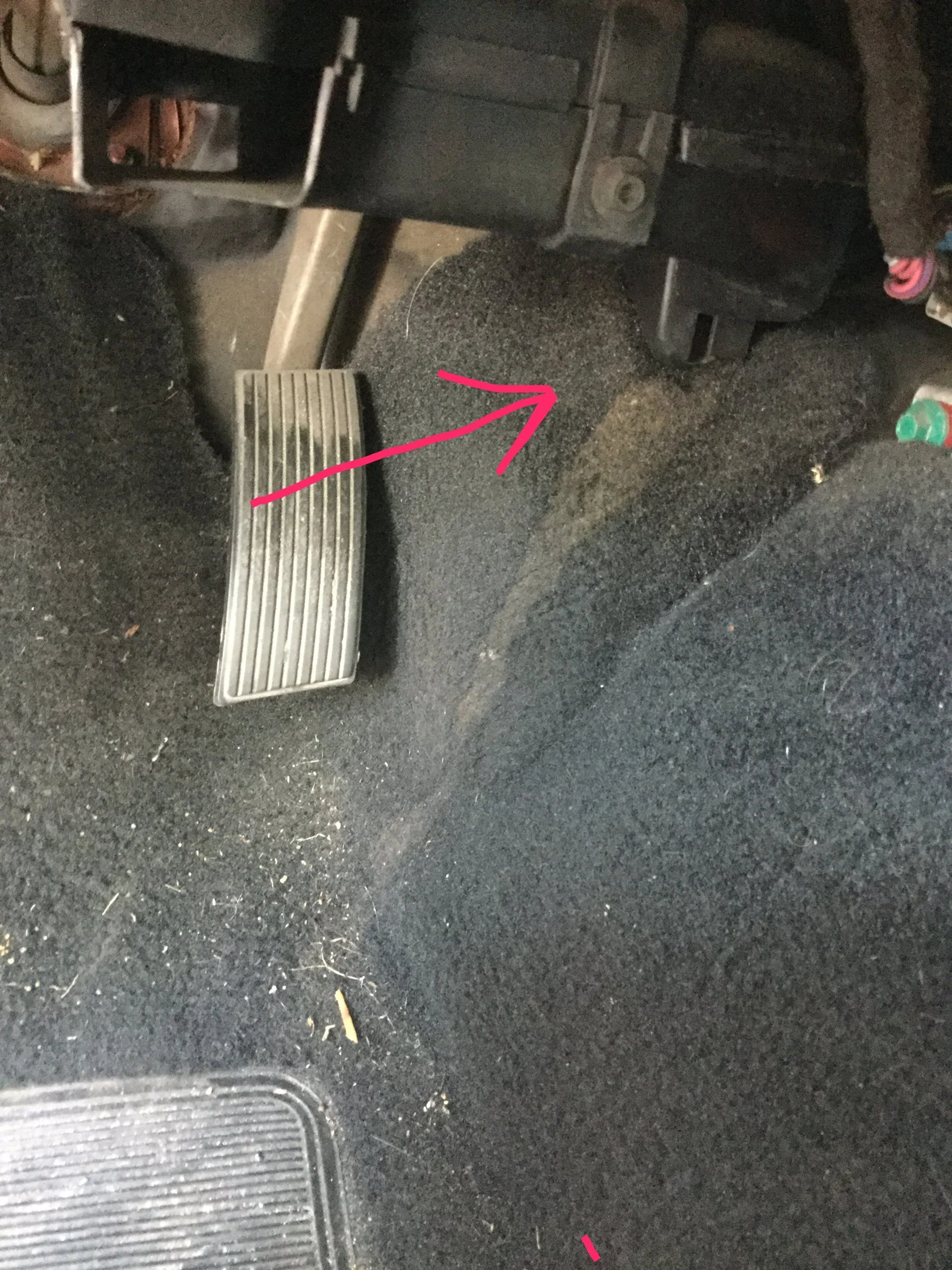

This water was hot! I was driving barefoot and all of a sudden my right foot was on fire. I wasn't even running the AC, but I did have it on all day the day prior so maybe the pan was full still? Maybe drain is clogged and the water heated up from the exhaust? It wasn't scalding so it might not have been heater core water, but it was certainly uncomfortably hot.
I think your A/C condenser drain is plugged and your heater core is leaking. Generally, both should be true if your feet are wet with hot water/coolant.
Reactions: rockandrollfrankie

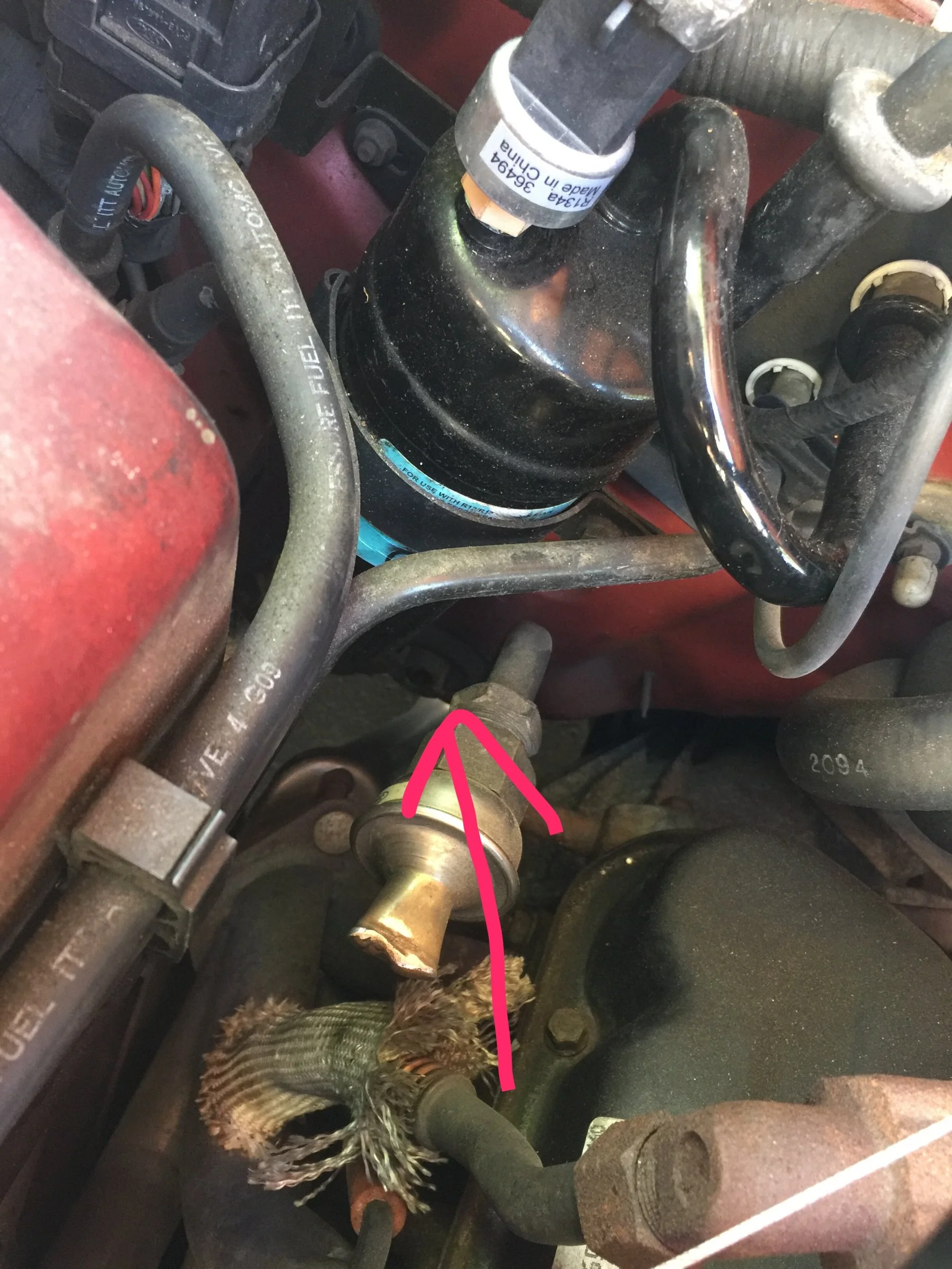

Looks like it's coming from there.
Yes, ah no, well maybe if your a skinny cracker.
Wait till your engine compartment has cooed down and you'll find a drain hole passenger firewall below the ac dryer, just stick a straw or something similar in there, I say straw because it's flexible and the opening will catch some of the filth that has accumulated and you will not poke anything. Notice too it should be just water/dirty junk and not sticky antifreeze.
Blow a little air in there, as long as it was not antifreeze on your foot.

Like with a compressor or with the straw? I smelled a faint smell of coolant I *think* but I'm not sure. I'll give it the nose check in a few.

You can take a small hose and stick in there and just blow on it, don't need compressed air.
