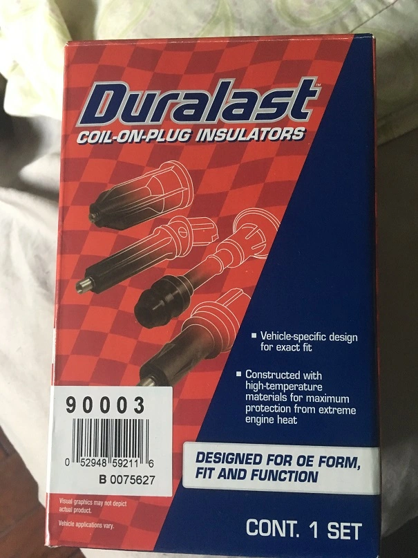

You can rebuild them sometimes a lot cheaper.
